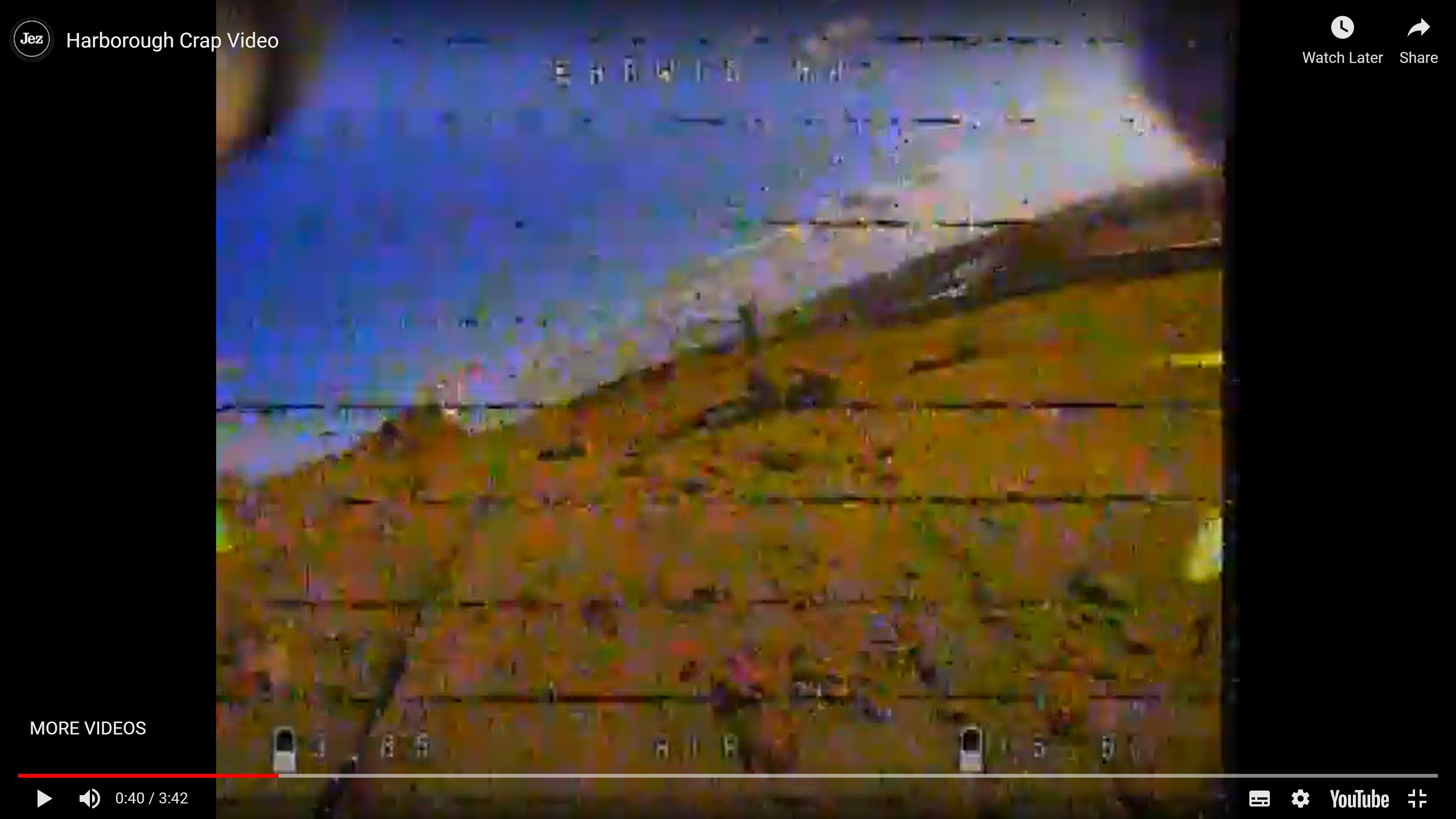

After some very casual and unscientific tests (“you look at my feed and I’ll look at yours”) at the meet yesterday, @notveryprettyboy has a theory that my poor video (see below) is down to my VTXs and in particular the type of connectors they use (MMCX, I think).

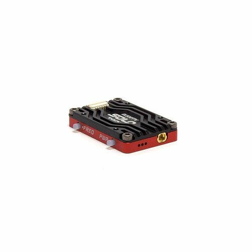

I will try and get some of my DVR footage online in the next day or two and I know we have the same goggles, but it is a lot clearer… My VTX is the Rush Solo (linked below). Goes up to 1600. But I “MAY” have a wrong antenna on the cobra X… I think it’s left, and all mines are setup for right… Will try out next time in field…

The changes in colour and saturation is a known issue with with the Steadyview receiver in Mix mode with some camera’s, most notably some of the Caddx cameras. If you switch to diversity mode you’ll notice the colours and saturation remain constant.
The solid black lines are equally spaced, which means they are at a fixed frequency and not just weak signal interference.
This may indicate that some switching noise is making it onto the video feed, either via the camera’s wiring or the VTX wiring.

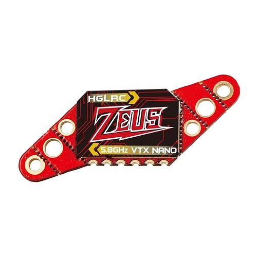

First off why not just get a cheap low power VTX and see if that helps? Something with uFL rather than MMCX?

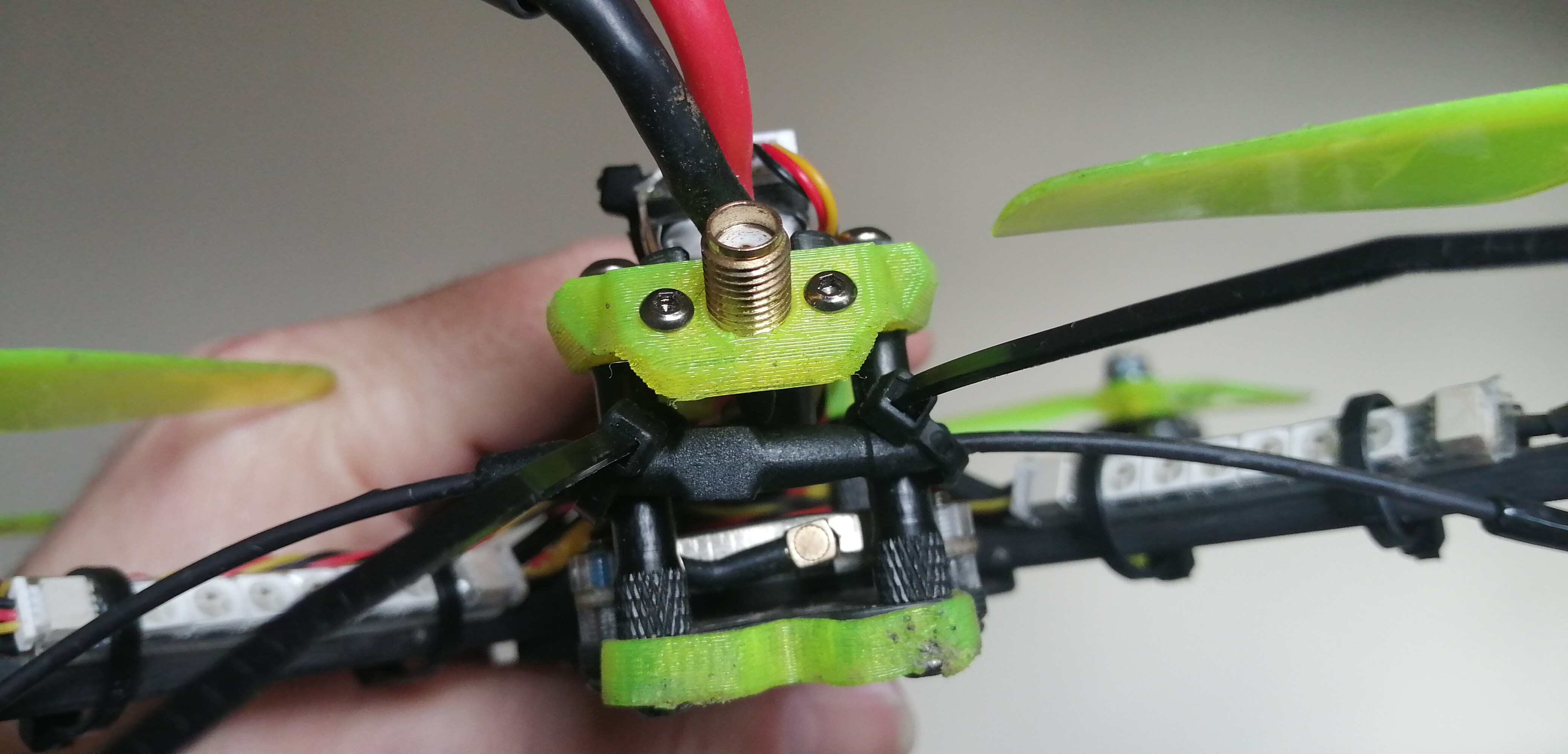

I have one of these in my Tadpole HD. It came with SMA pigtail and uFL antenna, so you should be able to try it straight in a quad. 350mW is enough for a small quad for sure.
Put some slack in the antenna pigtail. Have it go in a loop so that if the antenna is pulled then it is not pulled off. I then used a zip tie around the VTX board to hold it down. I’d tried hotmelt glue, but that melted under the heat generated by the VTX.
Hang on… that photo is of an Eachine Nano V3… lol… so very similar… It is the Tadpole HD though.
The Gecko must have the Zeus in it.
Ah yes…

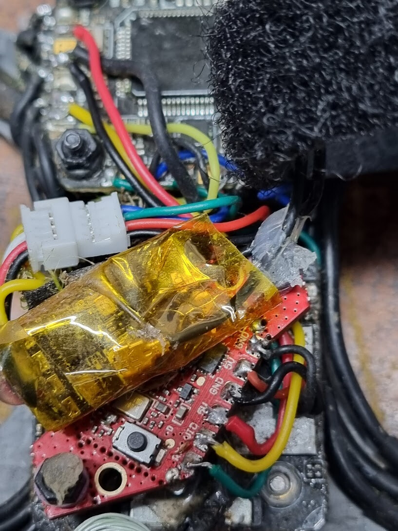

That’s my ELRS RX on top of it in the kapton tape.

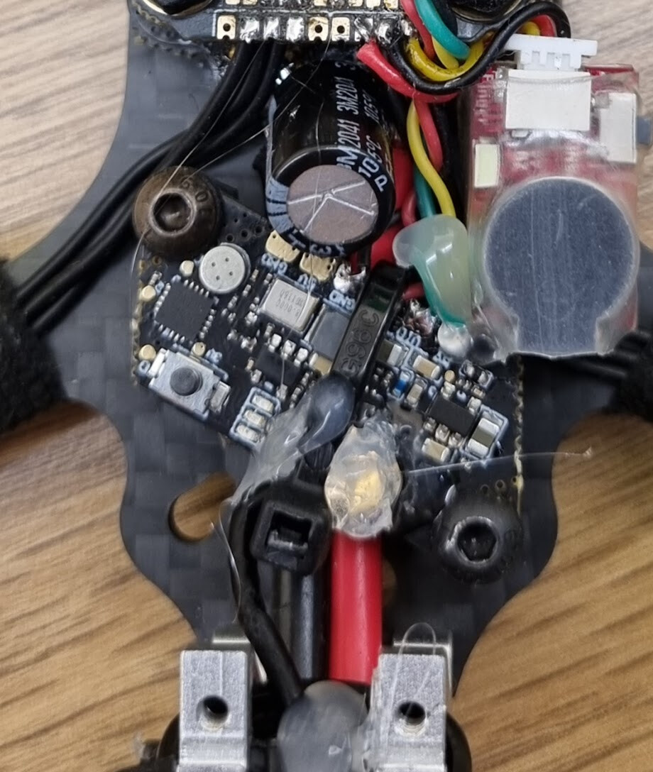

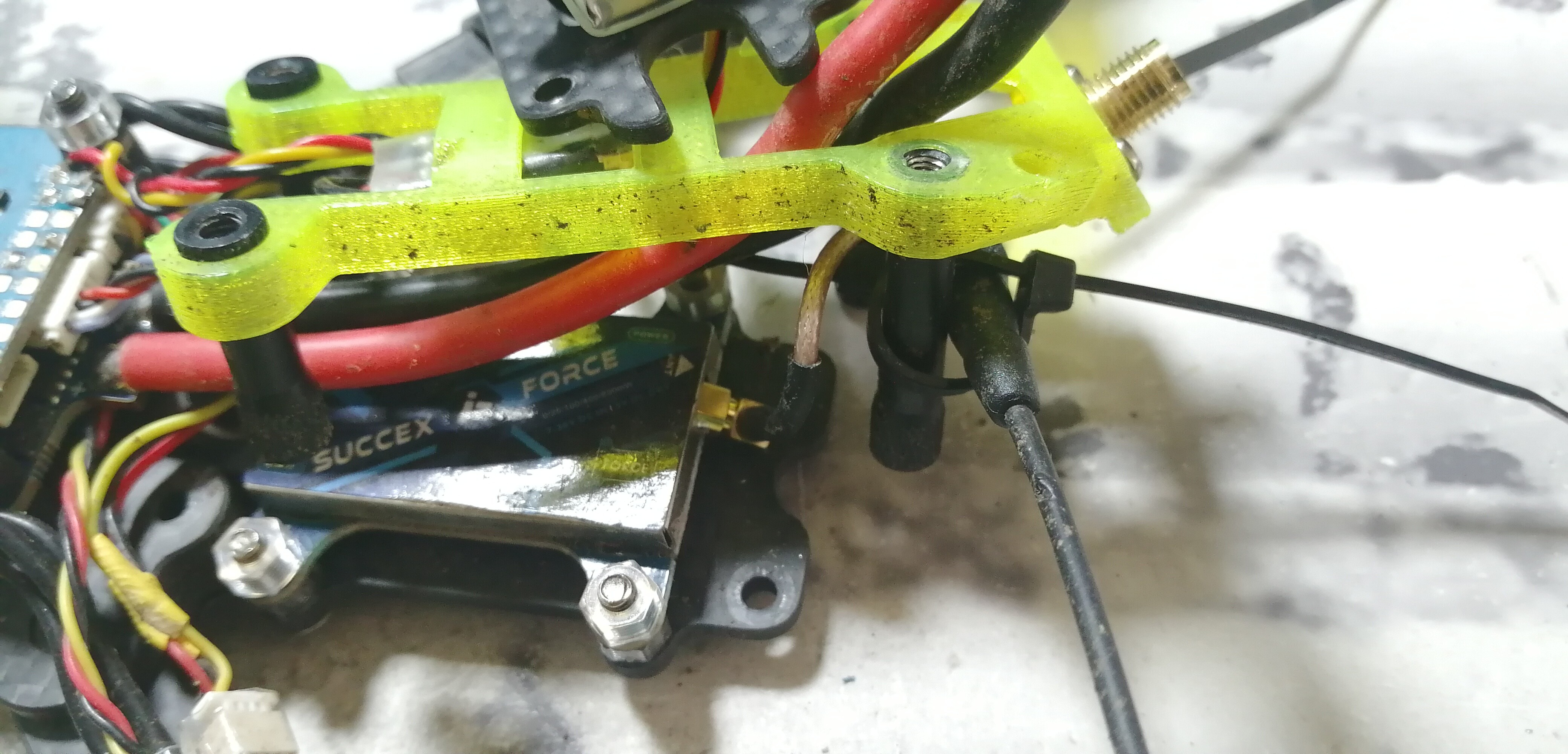

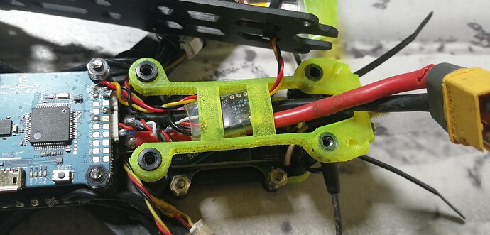

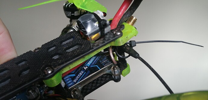

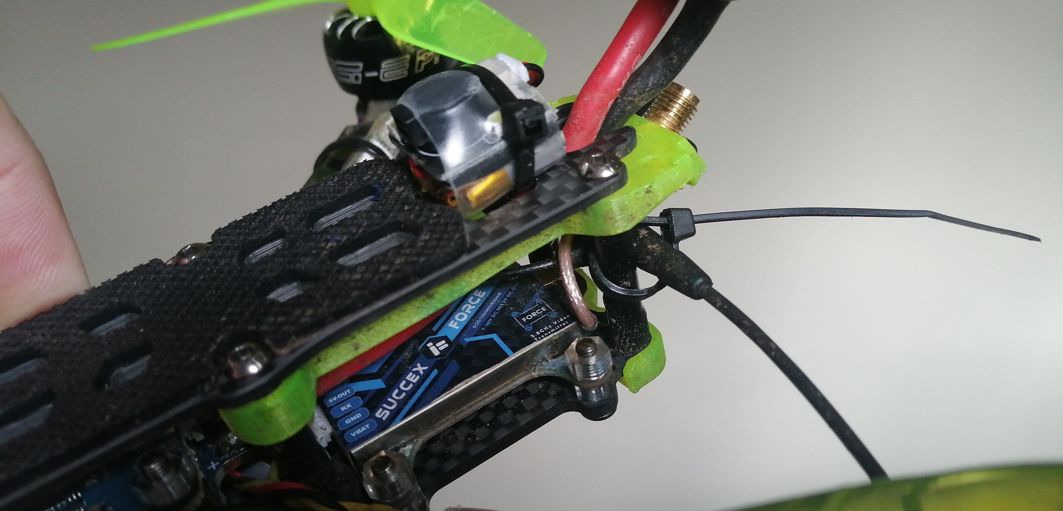

OK, all you helpful people, let’s show you what we’re dealing with. :slight_smile:
Plenty of slack on the wire.
Into the rat’s nest…
Oh, that looks wrong. :thinking:
Should the socket be that loose?
