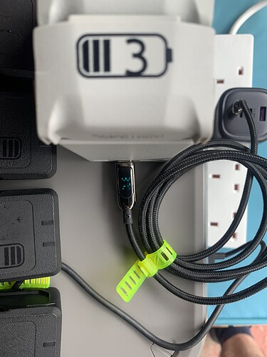

I have a number of good quality USB C cables (one is Anker 100w - https://amzn.eu/d/bhs9lyk), and when connected to the DJI charging hub, delivers 17w
However, if I use the USB C cable that came from DJI, I get 21w (see image).
I assume the charging hub is limiting the power being drawn, but any ideas why the higher quality cable from Anker does not deliver the same as the DJI cable?

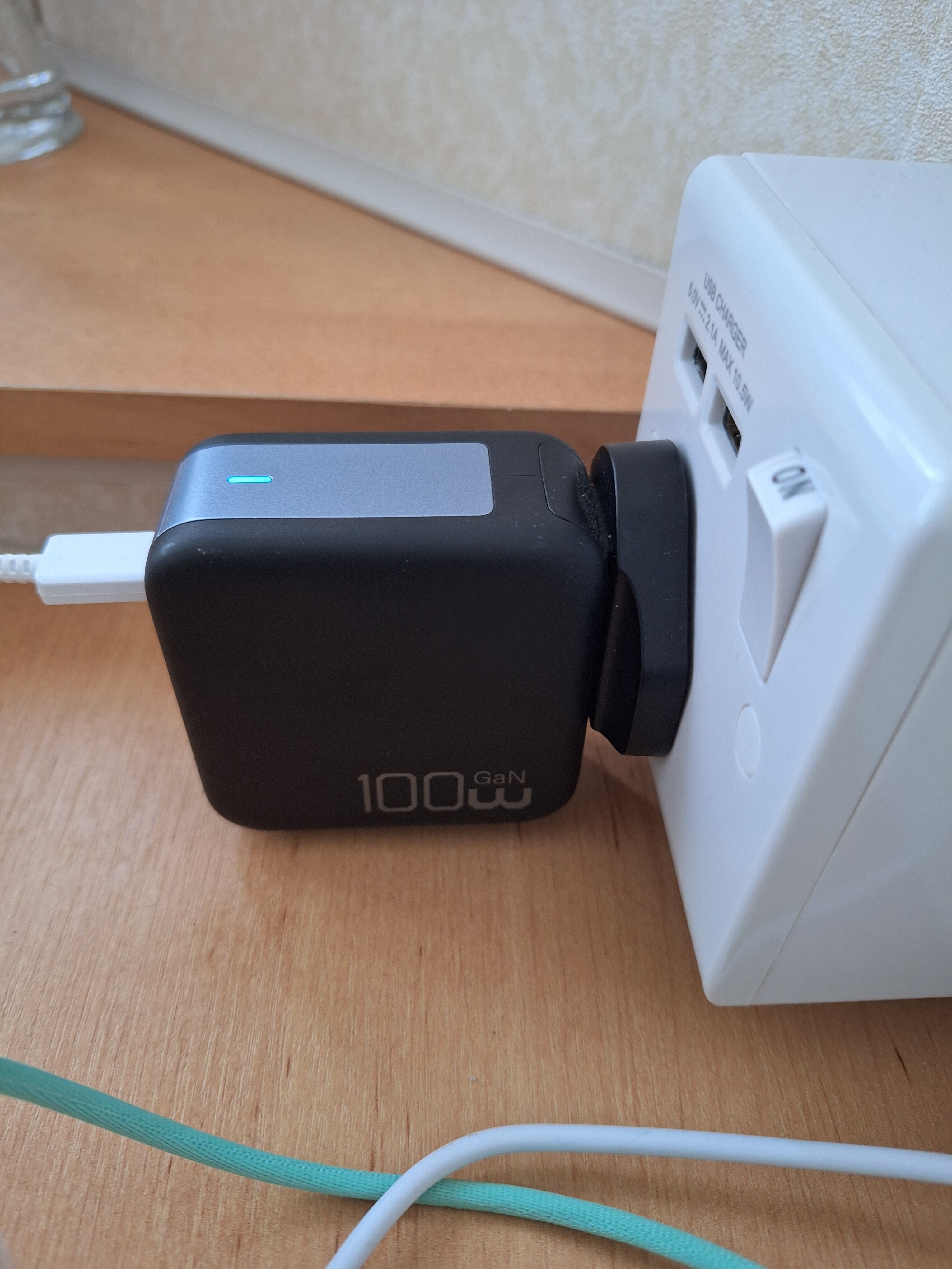

This was mine before
Started at 36w and slowly dropped to 3w when fully charged

I never saw it go over 21w (based on info on the display but also using a cable similar to the one you have in the image (Ocetea USB C to USB C Charger… https://www.amazon.co.uk/dp/B0BJZ5WY9J?ref=ppx_pop_mob_ap_share)
