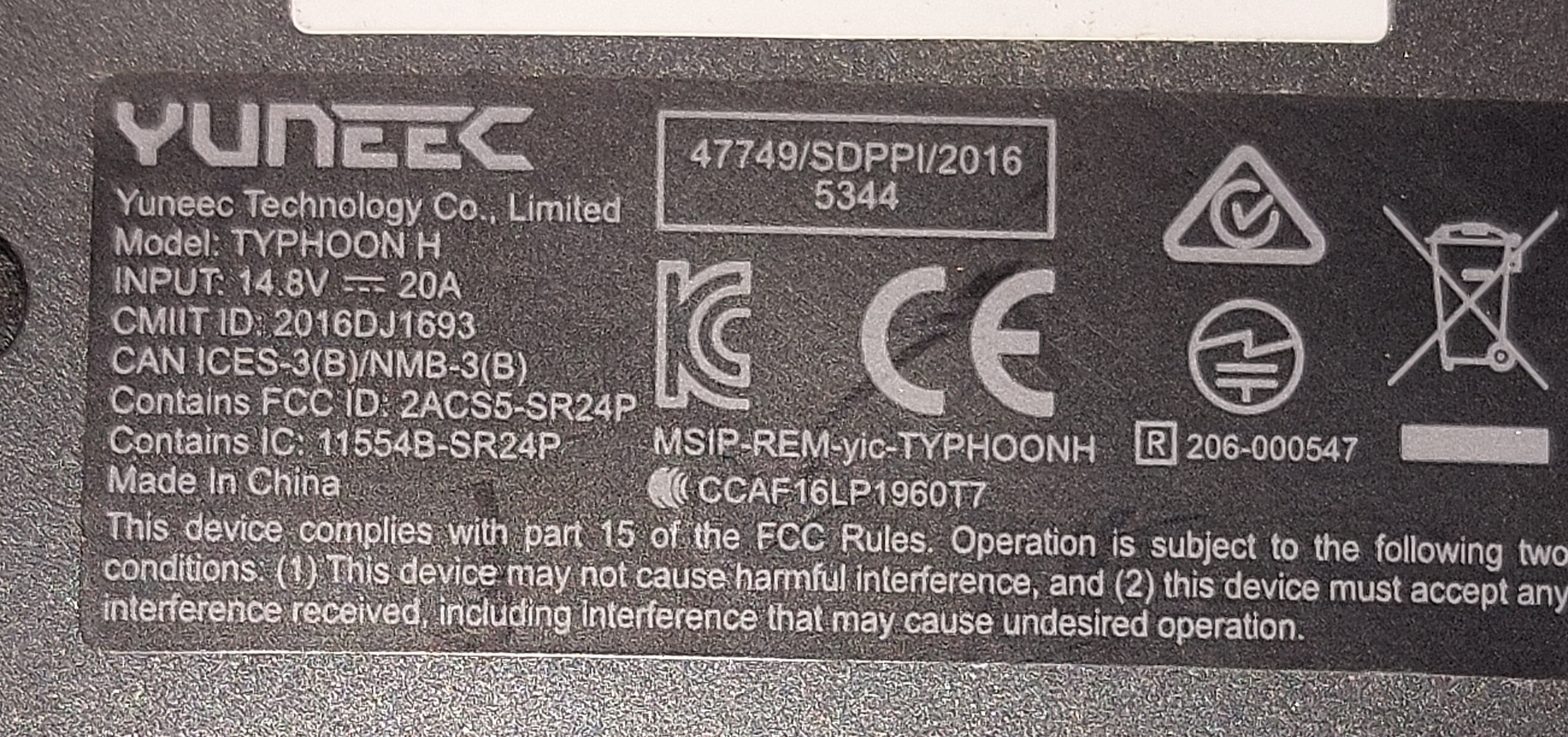

I think that EU and UK spec Typhoons have the following in their model number RTHEU or RTHUK. Would double check but the model number on my Typhoon is hidden under the wrap :man_facepalming:

From the bottom of my H
Cheers Steve, just out of curiosity I wonder if Yuneec would CE mark the Typhoons that were to be exported to the USA?
Can you not see the whacking great CE letters in the middle of that photo there Dave? :rofl:
I can see the CE mark on Steve’s Typhoon ! as I take it it was exported to Europe and bought in the UK :stuck_out_tongue_winking_eye: I’m wondering if the Typhoon @Nidge has purchased does not have a CE mark it could be one that was exported to the USA originally.
Sorry Dave, I completely misread your post :rofl: :man_facepalming:t2:

Why not, they mention part 15 of FCC rules which is an American issue on that sticker.:thinking::thinking:
