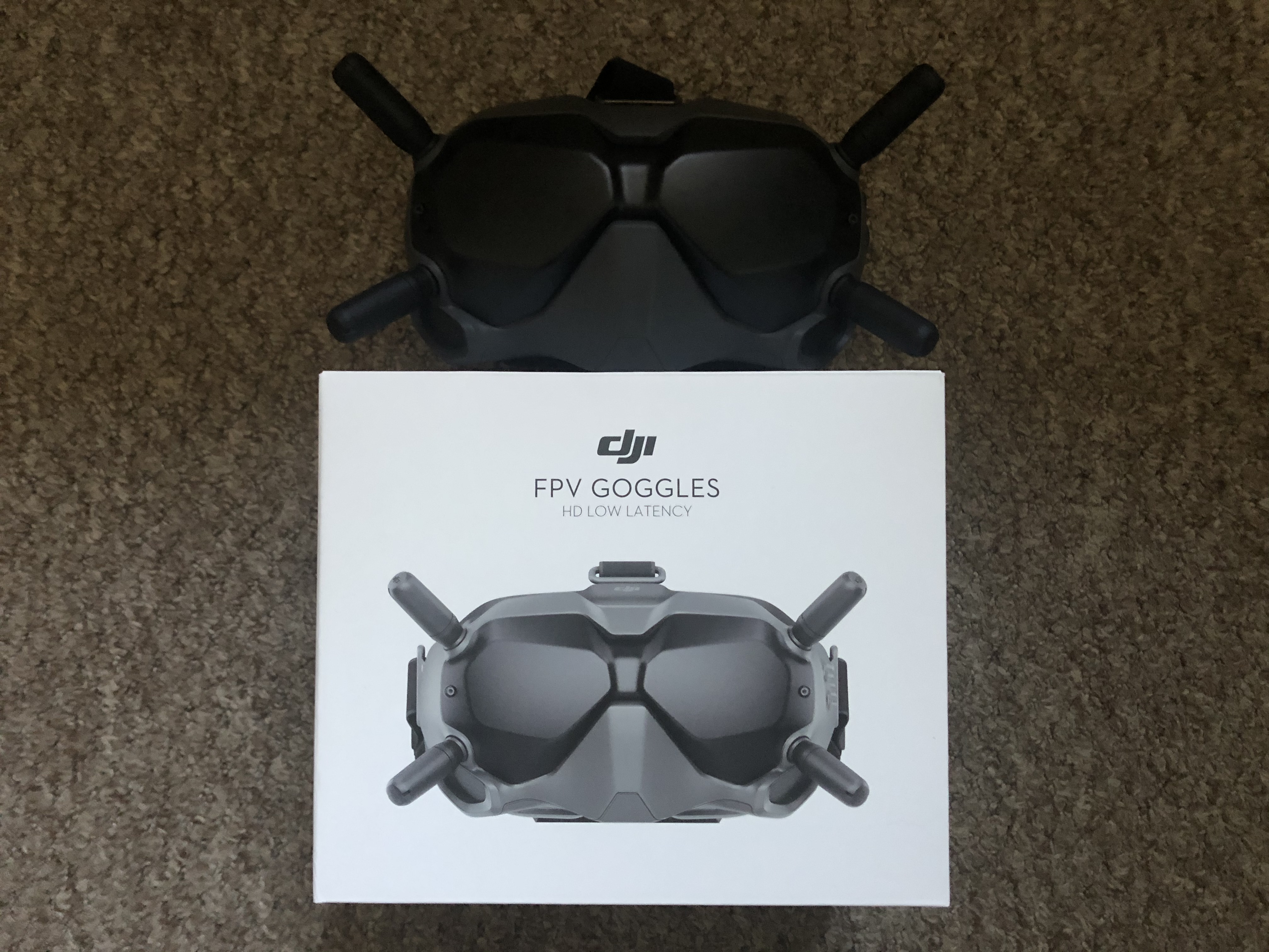

Damn - I caved.
Drop me your address in pm and I will print you the mod for the sides that helps with the light leak issue
Cheers James - I appreciate that :+1:
