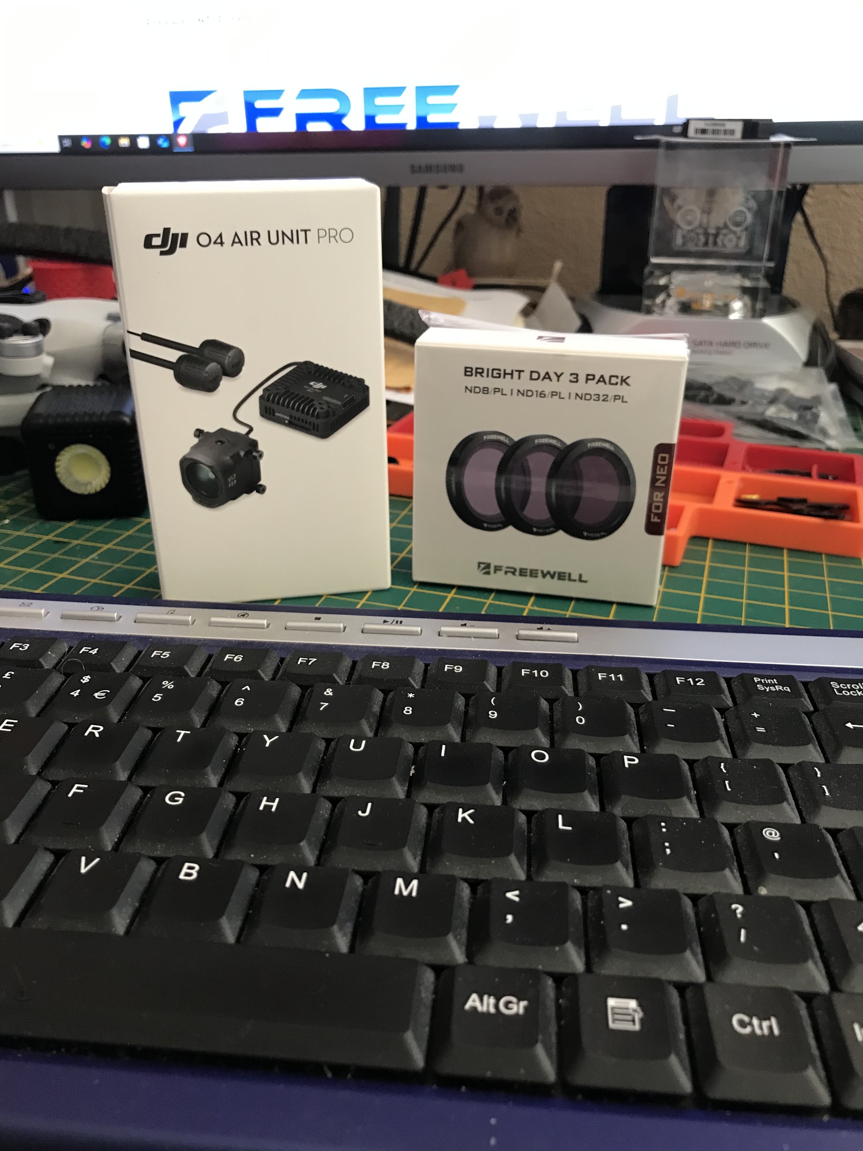

It turns out the Neo ND filter can be made to fit 04 camera, so it’s BBL printer to the rescue…something simple will suffice me thinks.

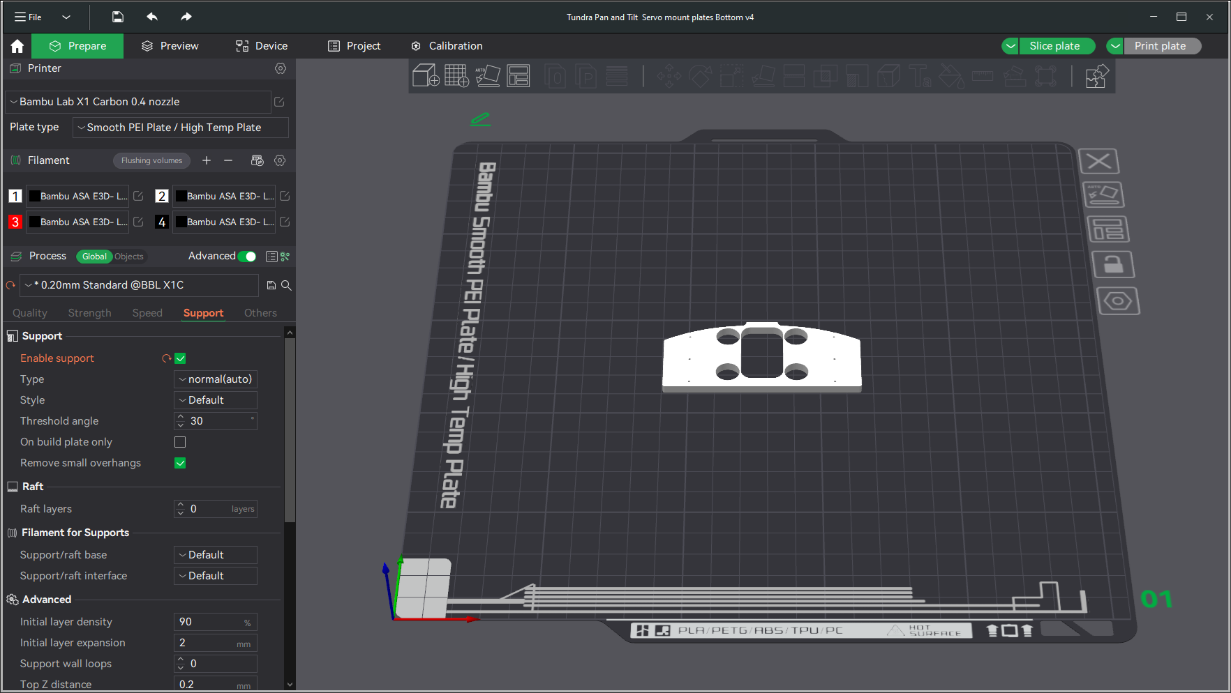

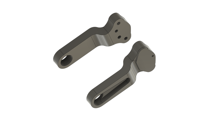

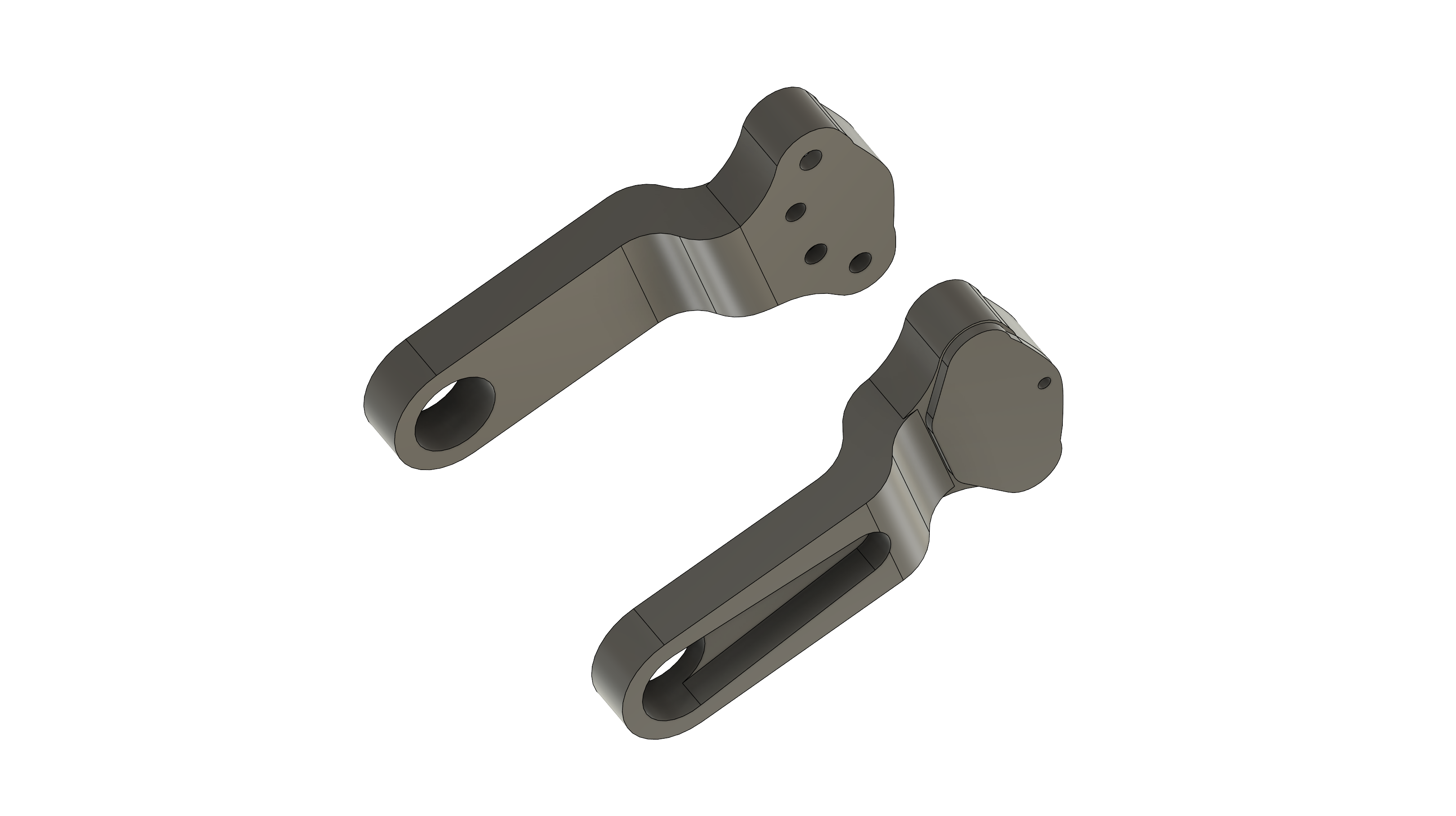

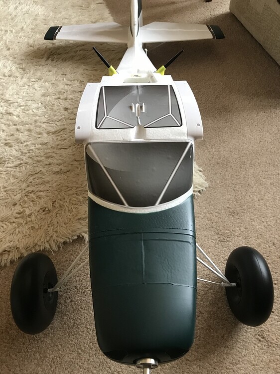

Trying out 1.6 High Quality with modified ASA profile settings for the below 03 / 04 interchangeable camera for pan and tilt… :crossed_fingers:
What’s it going on/in?
Sorry for the late reply, it’s going in this…

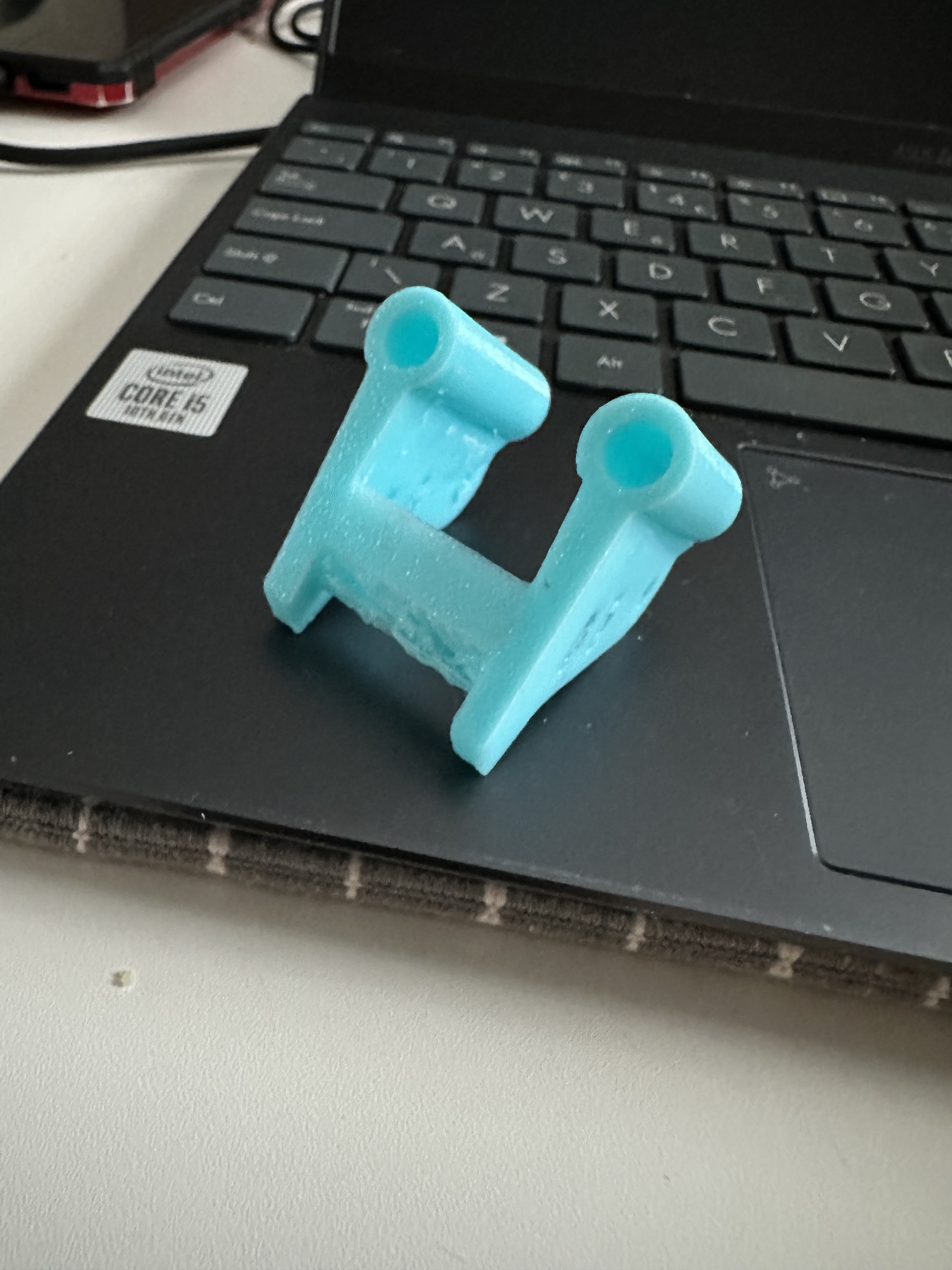

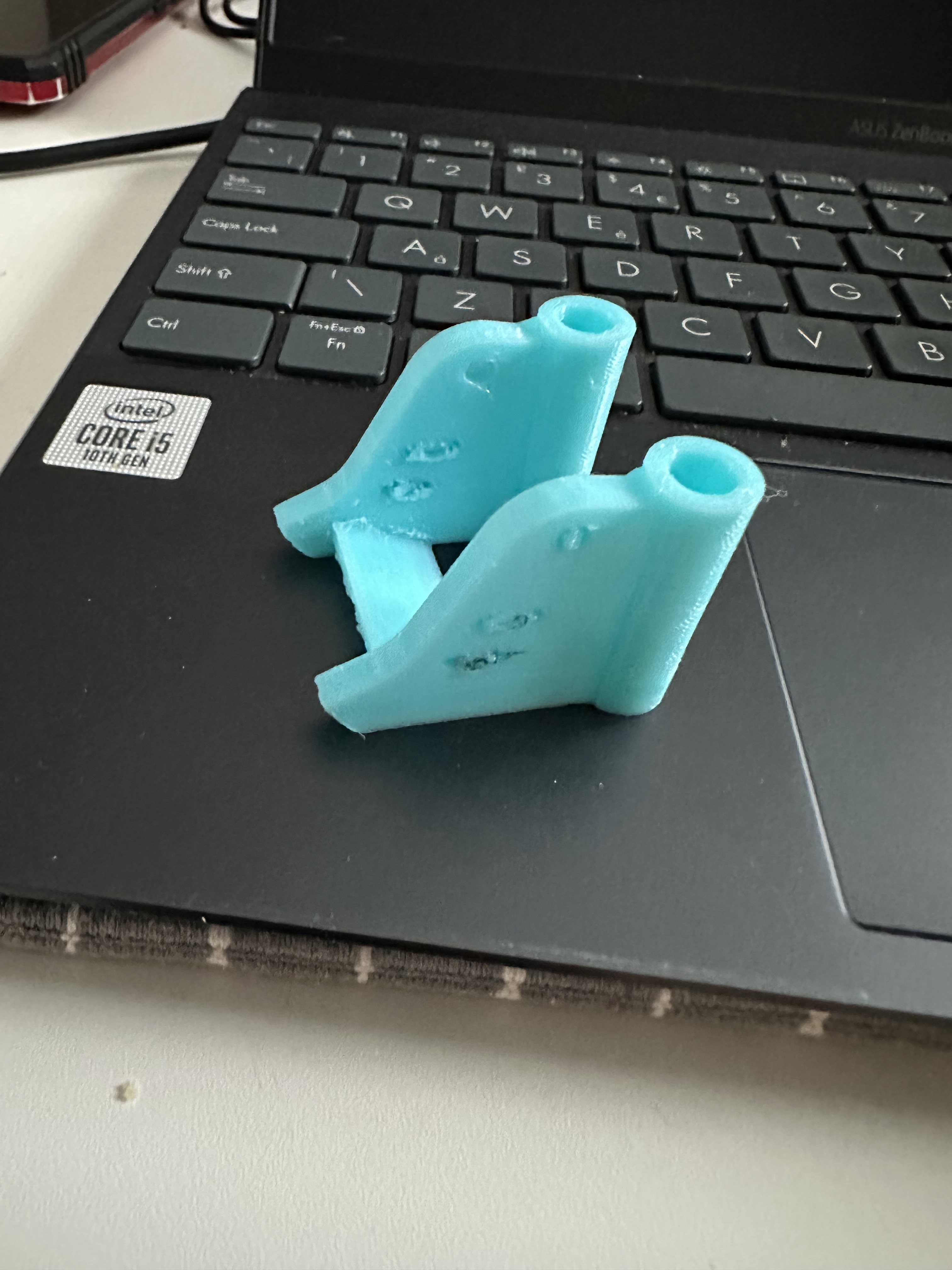

It seens to be going ok at the mo, a bit of striging hence iv took the temp down to 220 see if that helps. My AMS seems to work fine with it just the bloody software telling me NO, ill post a pic when its finished :+1:
Well it came out ok just a bit on the bottom which I’m not sure why it’s printed like :thinking:
It looks like you haven’t ticked “supports On” also the filament is “wet” which will lead to awful supports.
Hint…cut the amount of filament needed to print but add a bit extra, put it in the oven at 50-60C place a sheet of foil over it and bake for maybe 1-2Hr, see if that helps.

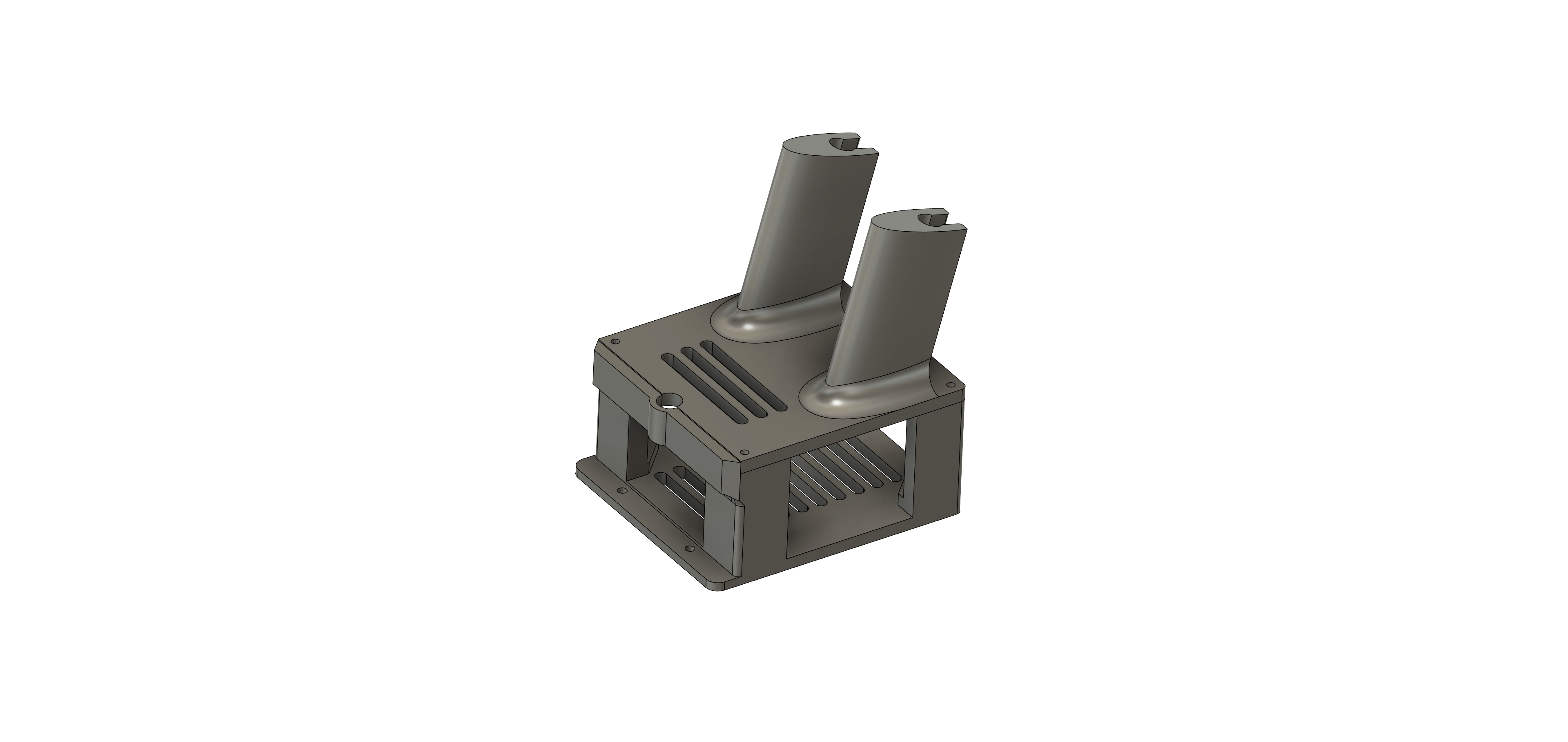

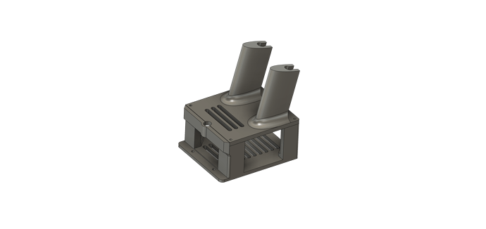

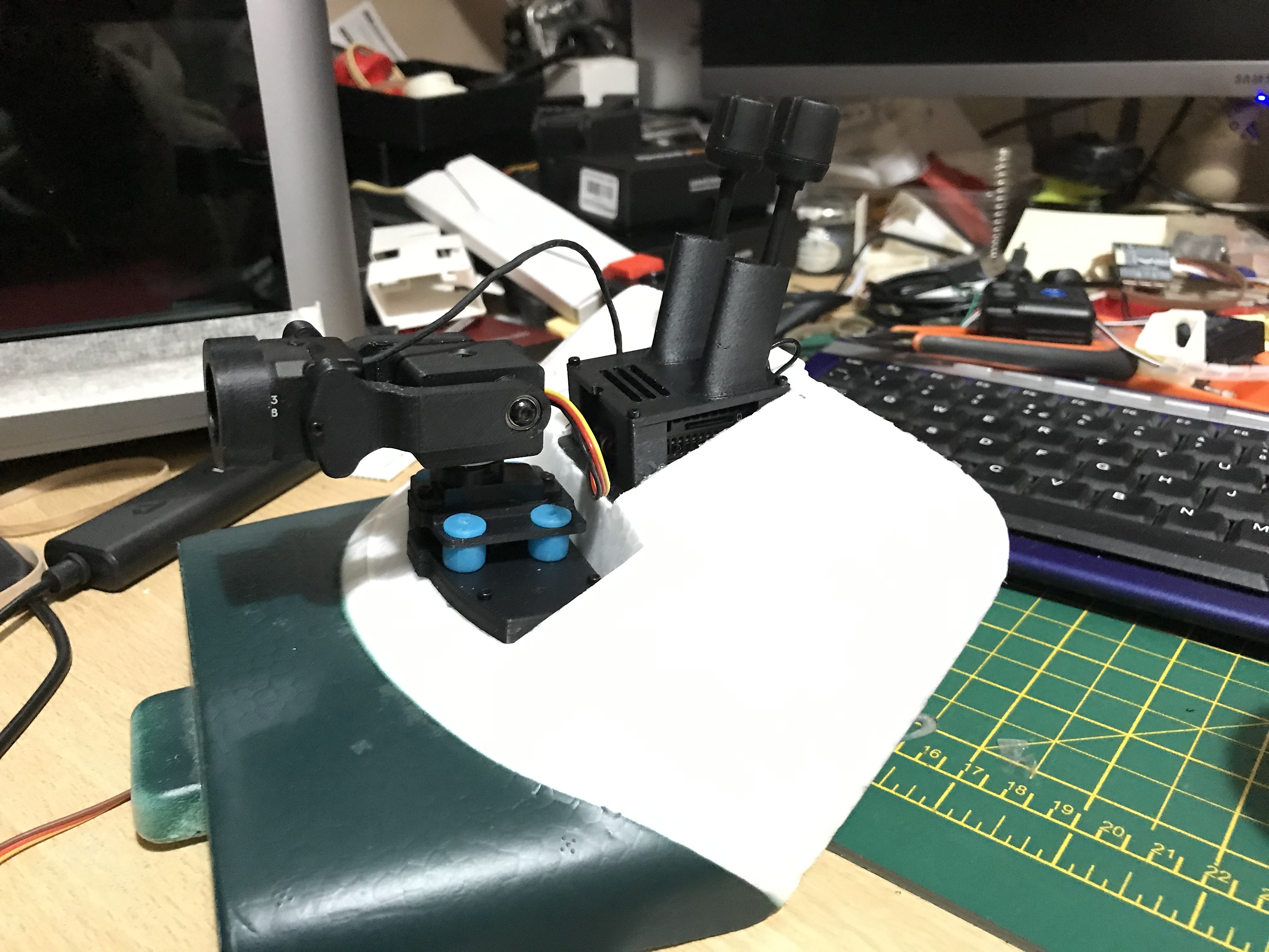

Single Dji 03 / 04 interchangeable camera Pan and Tilt mount V2, V3 may include a cooling fan for the summer months…
If anyone wants my 1.6 profile for ASA especially Bed and Cooling let me know.

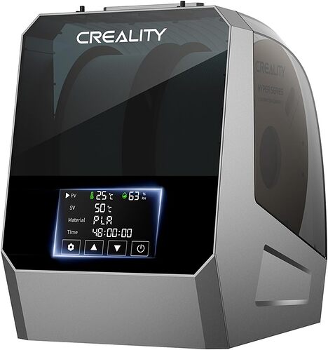

Or use one of these:-

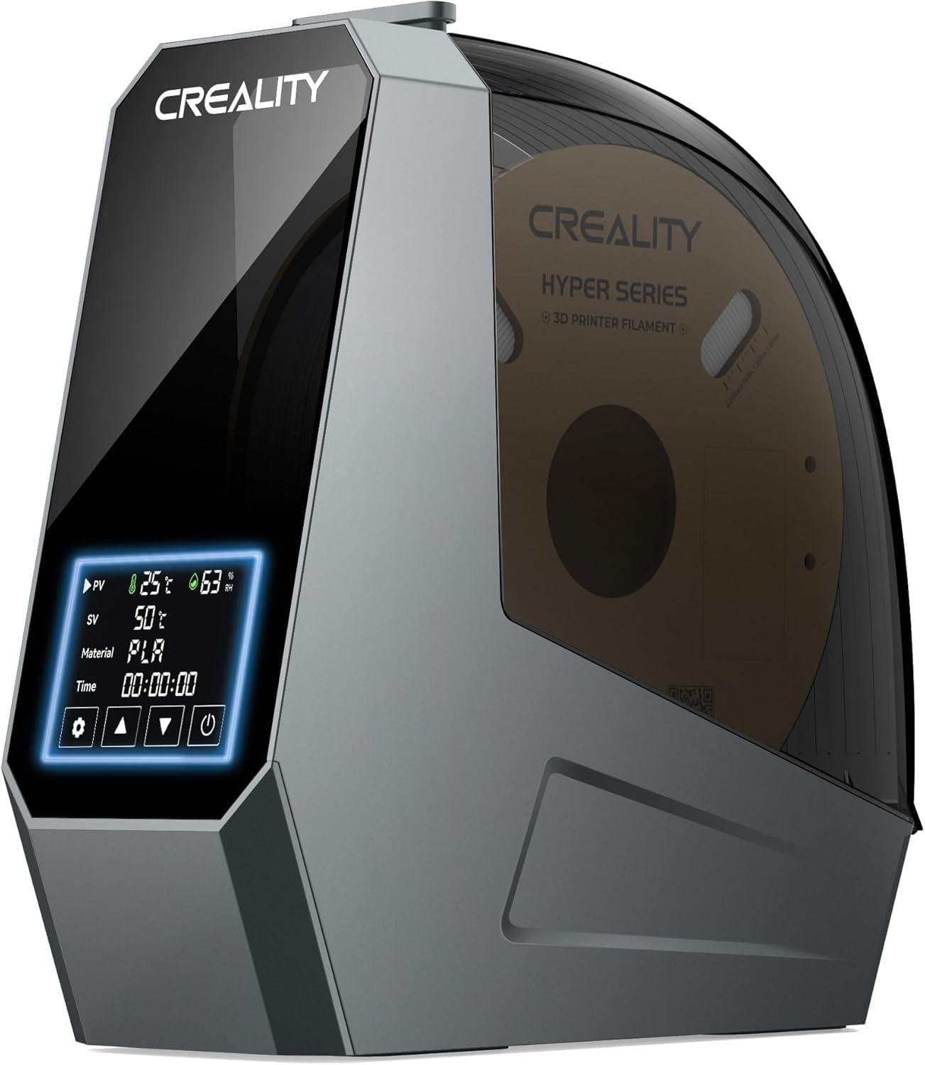

Or even:-
I have the second one. Theyre great machines but I found a downside is if the ambient is below 16 degrees it wont start heating. I have to give it a quick wave of a heat gun on low power for it to get going. Is what it is as its in the garage.
I did tick supports at the start, but due to mincing around I rebooted the machine and forgot to re-tick it :man_facepalming:
