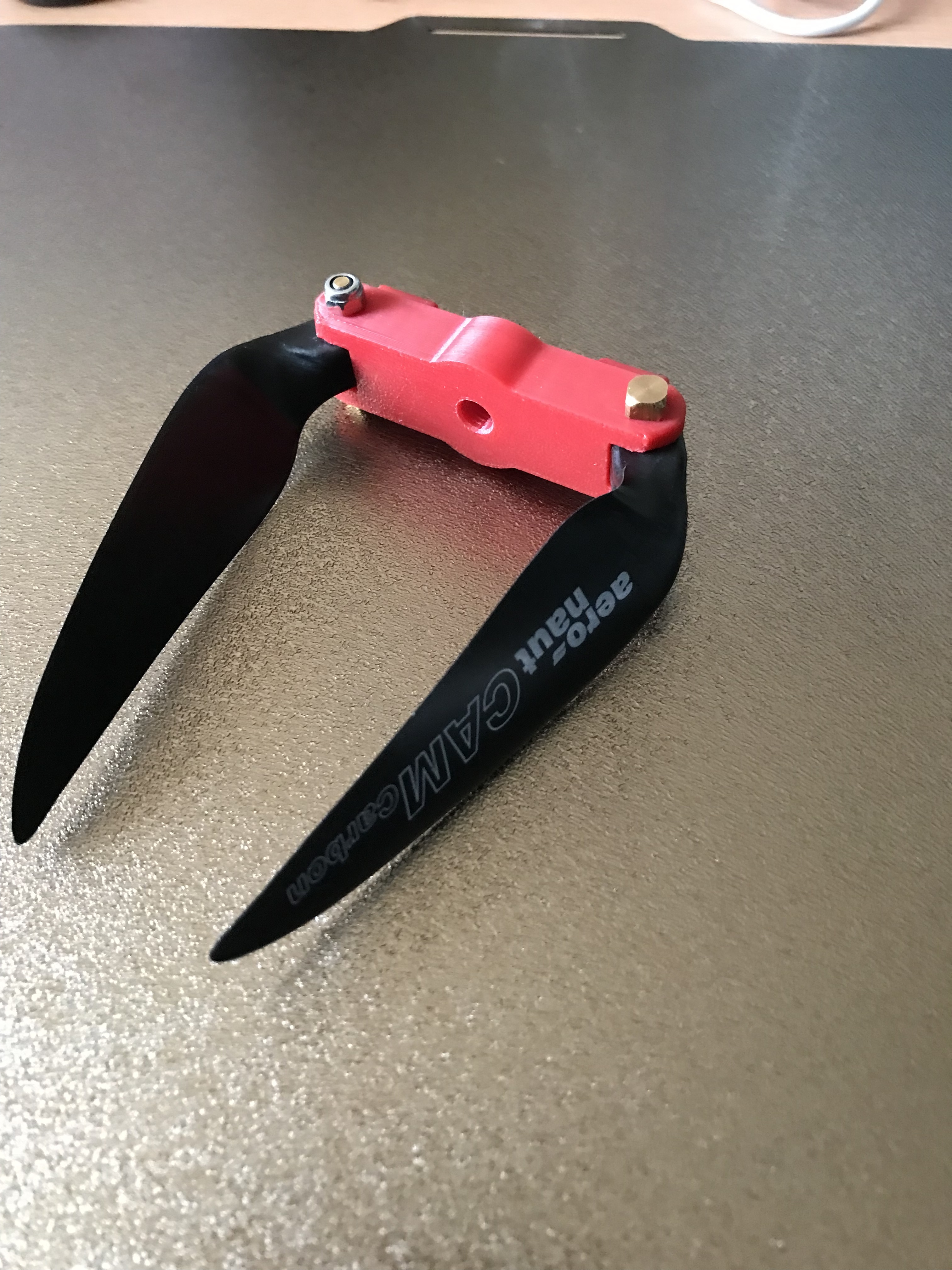

Wouldn’t have been able to print these for the wing, PLA prototype for PLA-Carbon leading and training edge, it all started with wanting to stiffen the trailing edge and without going to the extreme of balsa wood replacements.

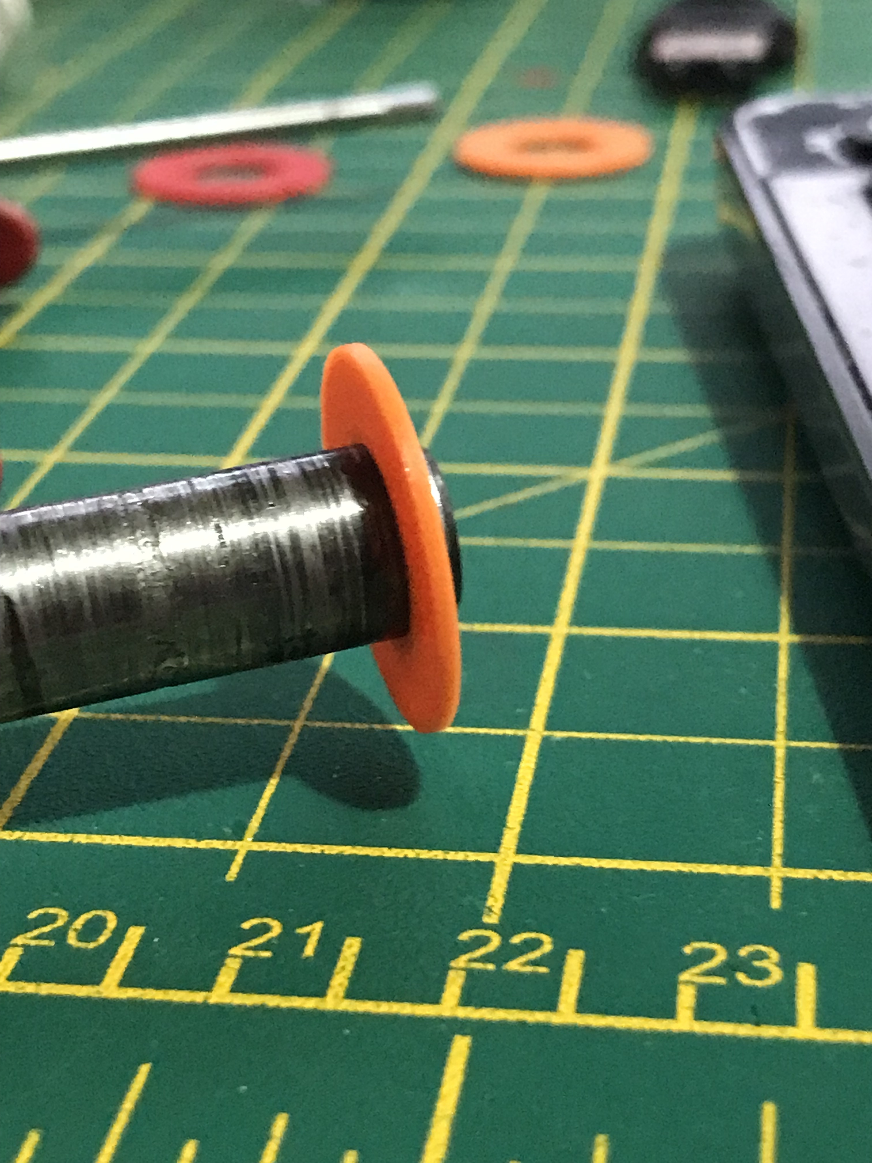

Would you like to try an experiment which doesn’t involve anything other than changing the XY hole compensation? the reason I’m asking is I need to eliminate any possibility that it’s my printer XY carriage that is marginally out of true.
It requires a 10mm drill bit with a clean shank to test, here’s the file, print it and see if it fits the shank, a default profile and speed. If it doesn’t I relay the setup for you to test.
20mm -10mm.zip (2.3 KB)
Got this printed with XY compensation, perfect fit, no ringing, it may only apply to the Sunlu+…

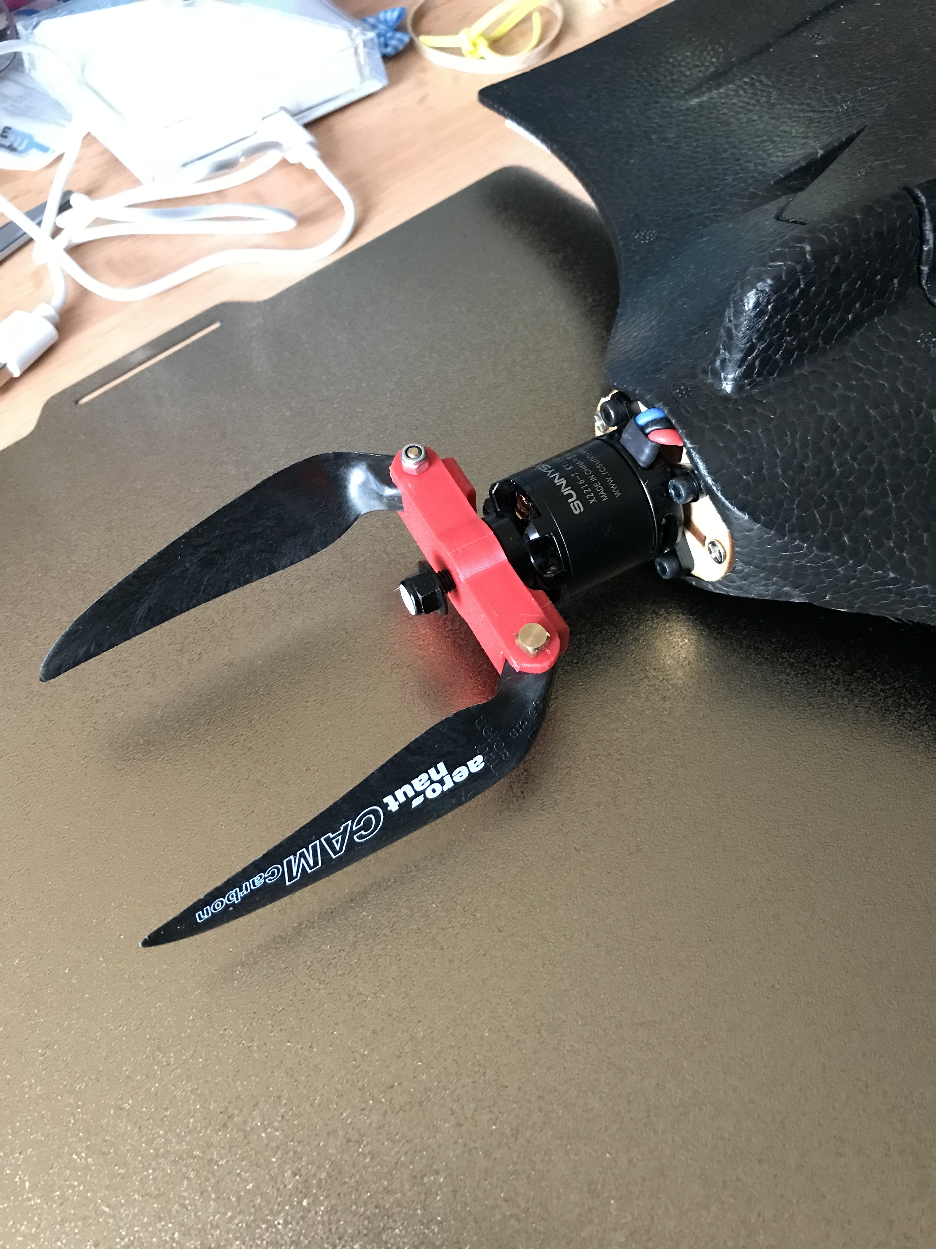

Also finalised the motor yoke which I’ll test dynamically once printed with PET-C and or ABS….:crossed_fingers:
Printed it, is this right?
Yes, see if it fits over a 10mm drill bit, it should be a snug fit.
