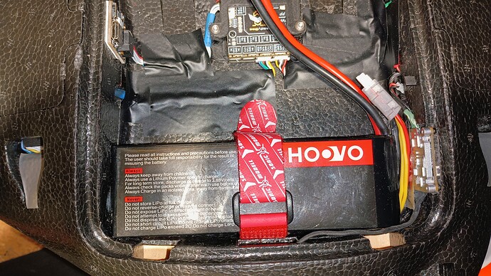

not much more to buy .got my battery very tight fit . will use was going buy another .need to change plug on flight controller to a xt 90 .then just the camera system and charger.
yeah, mine was a tight fit too but that was good because it stopped the battery moving about ![]()
the shrink wrap round the battery was overhanging so trimmed back now fits snug.
My battery is snug as well which is no bad thing.

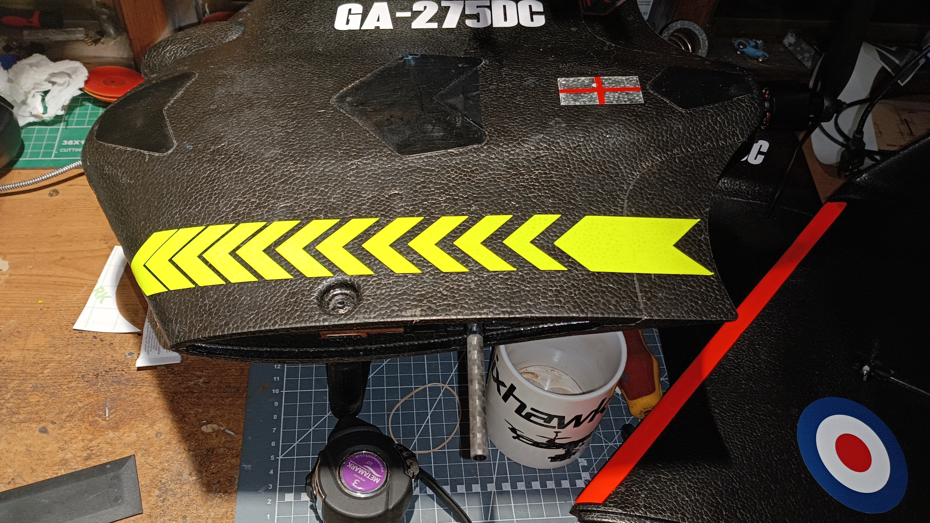

After @DeanoG60 loss Iāve made mine quite conspicuous with my own set of hi Viz decals
Plus hi Viz wing edges
I can do you a set in orange, yellow or pink if you are interested.

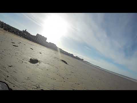

I used auto launch on maiden of T1⦠Meh. Yommthoufh you should wait stevesb!
Yeah I agree with @GunjaFPV looking at the video, something is wrong with the setup as that was a hard roll as soon as you let go.

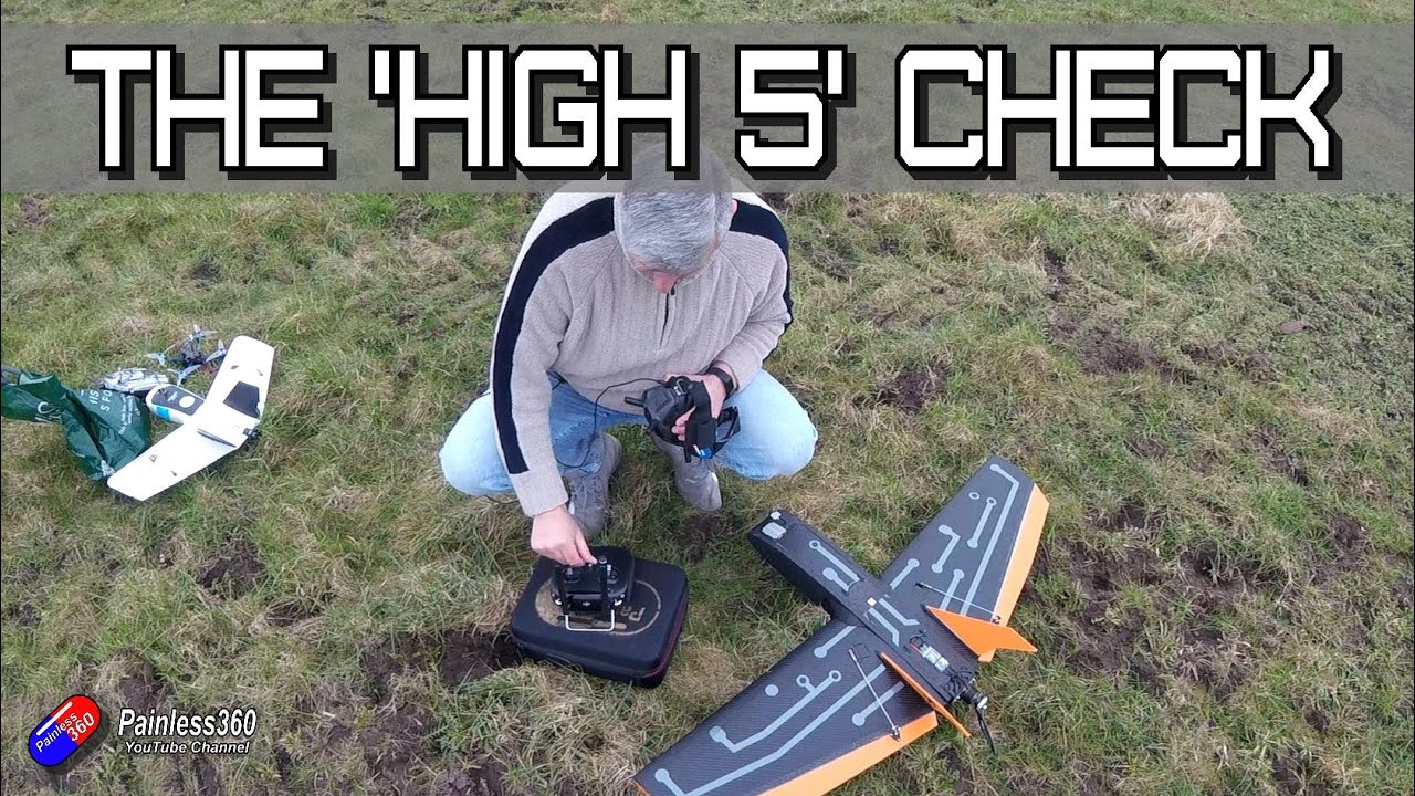

did you do your high 5 check before taking off?
Yes and no. Yes I checked but no I didnāt get it right. I have I arse about face, I just checked.
At least youāve found it now before trying again

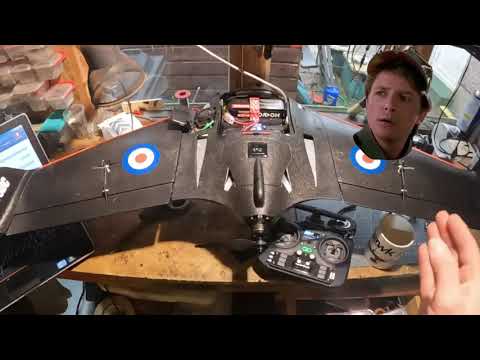

Ok un reverse the servos and physically swap the plugs over. Now this is where I fried my brain completely, the servos behaved in exactly the same way, stick to the right, left elevon up. I tried this three or four times, to the point I said fuck this Iām going to film it and get an expert like Deano or Martin to point me in the right direction. I go into the house, get the go pro, connect to I nav, start filming and get to the point where I swap the leads round, and low and behold everything is moving as it should.
I didnāt do anything different to what I did the other times I swapped the leads round but this time it worked. I just hope it flies now. But I still donāt know why the servos acted like that when I swapped the leads round the other times.
Could be a save and reboot issue? Also make sure youāre doing all the testing in Manual mode ![]()
