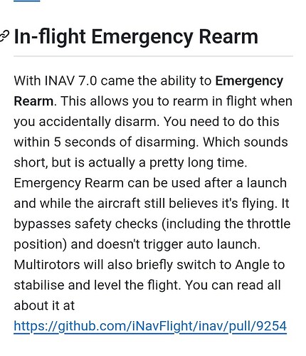

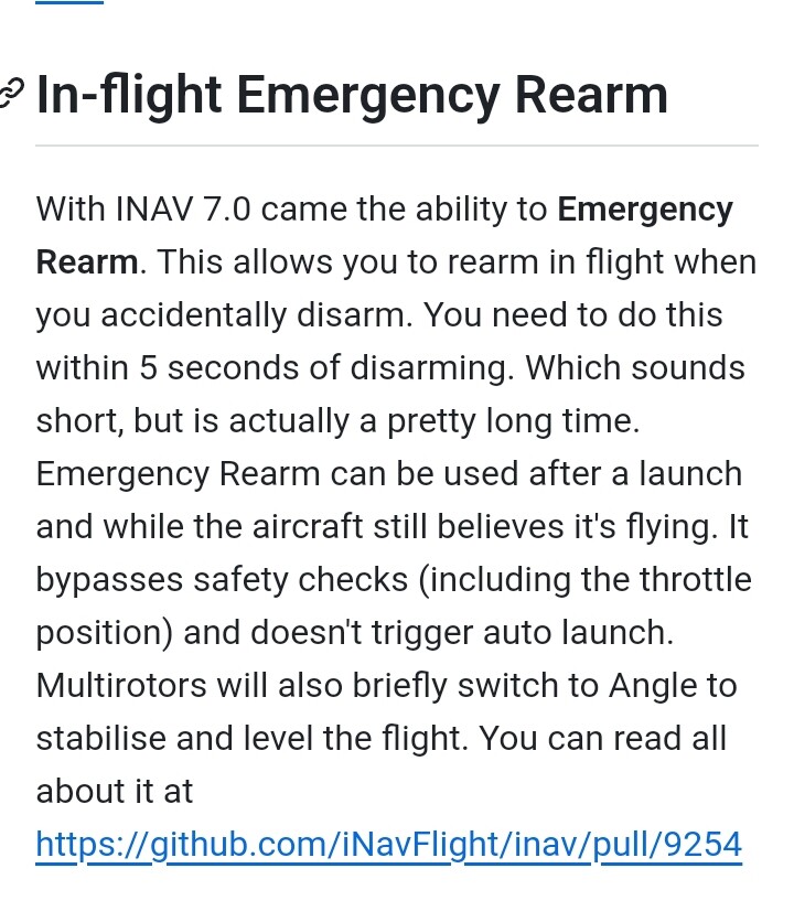

As I mentioned in another thread.
Inav 7 may be a good idea.
You can do this on version 4,0 onwards
Talk to @GunjaFPV
:slightly_smiling_face:
Still need to make my video on this. But yes I dis armed, and rearmed loads and loads, I landed un armed a few times, can do this pre v 7 easy, and don’t just get 5 seconds :slight_smile: (though 5 seconds is probably ages!)
