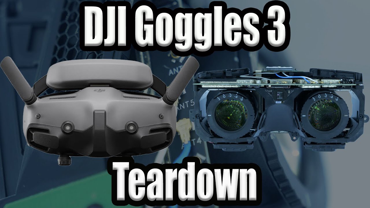

@Mads-Tech Goggles 3 teardown
sponsored by GADC :grinning:
