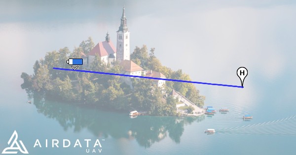

This is what happened when I miscalculated my toal point.
The waypoint mission aborted upon signal loss, and rth triggered.
