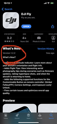

It seems that this is compatible with DJI Fly 1.2.4, but at least on my phone, it’s only 1.2.2
Is the firmware already out?
Think you’ll need to go to the DJI site to get 1.2.4 for Android - they seem to have given up posting on Google play store
