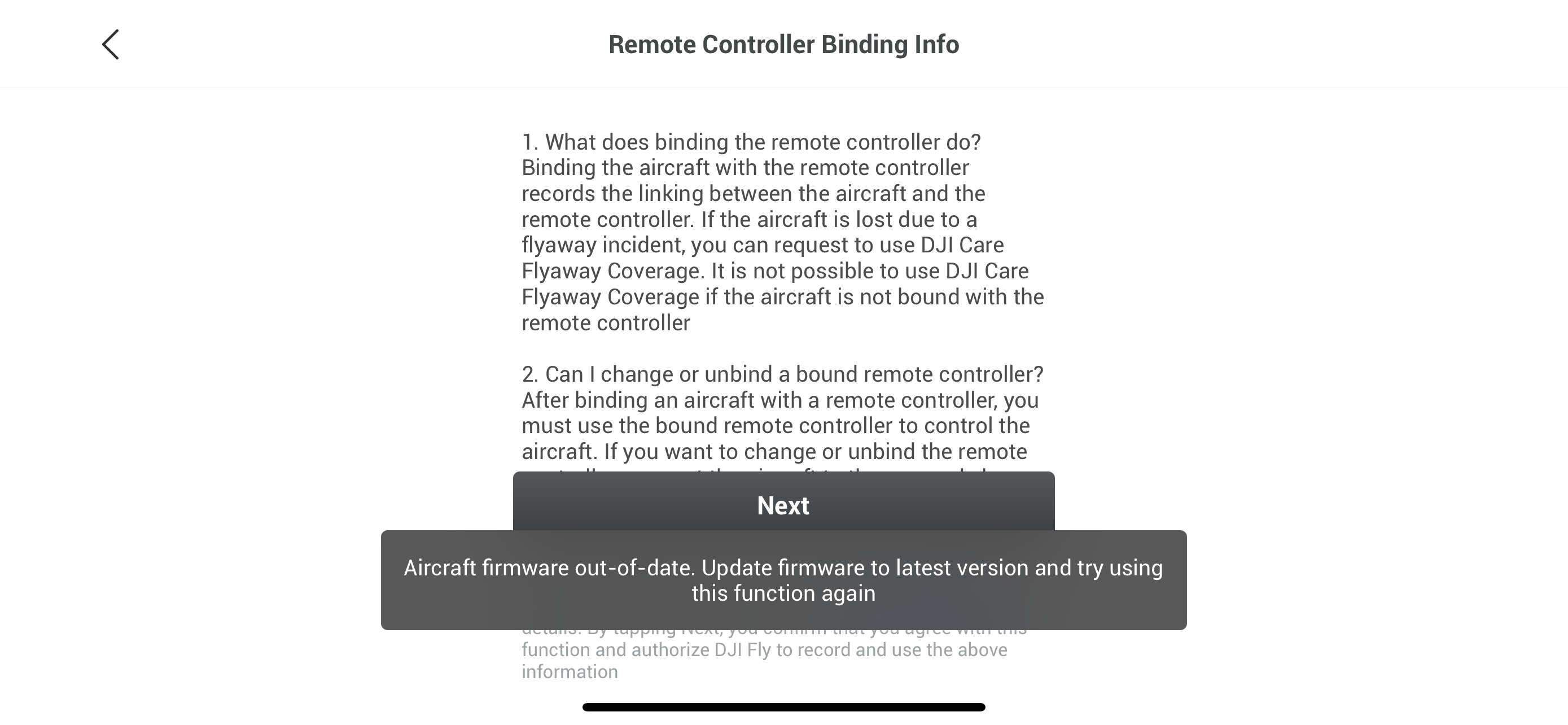

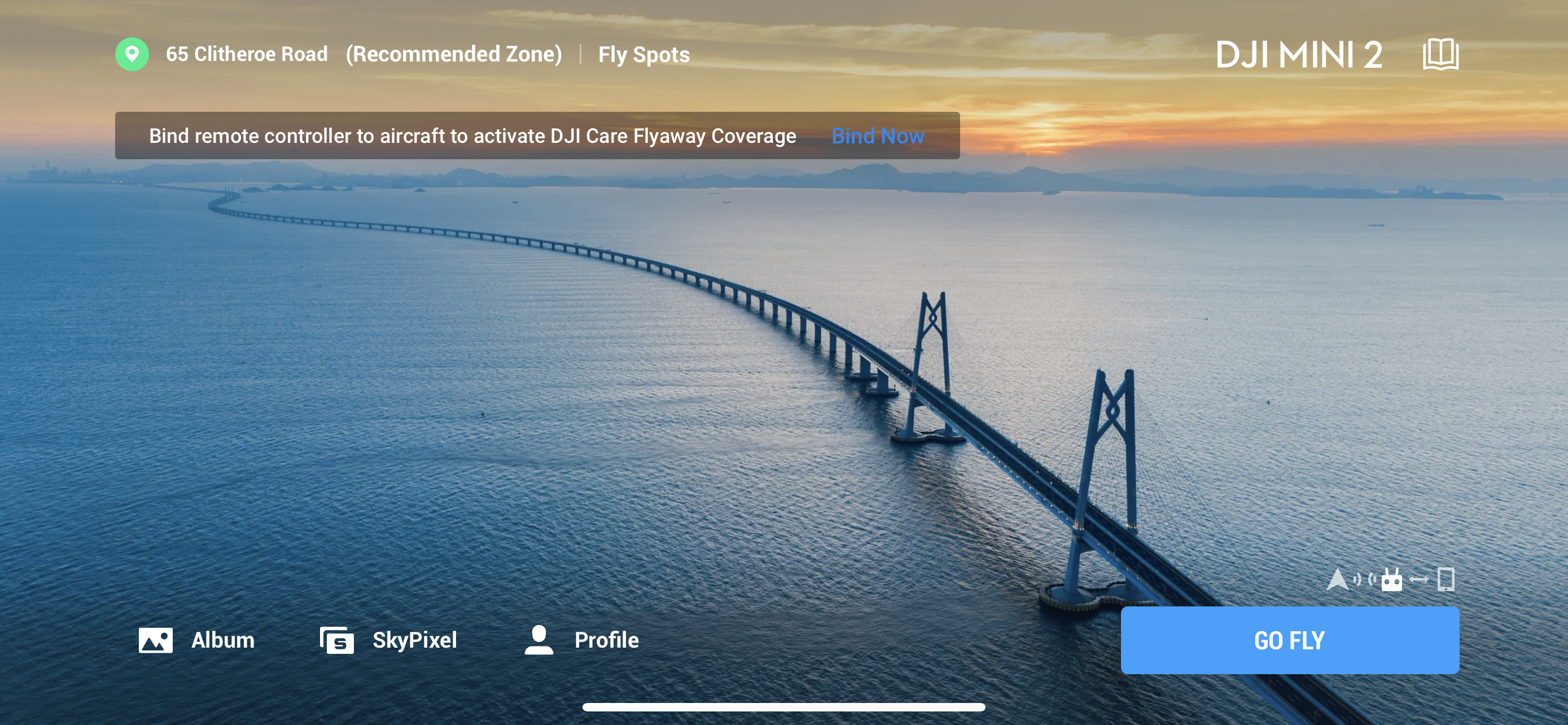

I have just got a mini 2 from eBay in great condition flys okay. It is up to date on firmware. I keep getting not binded for the fly away function? Click the link get taken to the terms screen, click next then error msg air frame not latest firmware. Is this because I haven’t purchased the care package?

Still get the same msg firmware not up to date? Clicked both updates and they say up to date, have checked online and this is the current version’s.

Have you a screenshot of this message?
Version 01.05.0000 cant be rolled back :scream:
@SparkyFPV
Just below the next icon
But why are you trying to enable the flyaway option in carefresh if you don’t have it?
@SparkyFPV every time I turn on I get this error. As others have said they don’t have care protection and it works? I am more concerned it is saying the drone isn’t updated? I will not be getting the protection as it isn’t worth it as so many are being sold on eBay as most mini 2 users have or are upgrading to mini 3.
