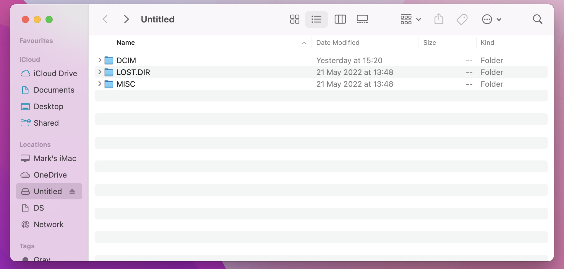

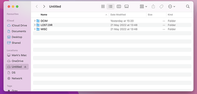

Is there any reason to keep the panorama files after creating a 360 image?
Seems surplus to requirements.
Unless I have missed something.
I used to delete them from the mini 2, once I had the shot I wanted. Can’t say I’ve seen the separate files on the mini 3 unless they are stored in the folder, I always use the quick transfer and transfer the ready made panorama.
seperate folder called panorama
This is all I have, if I go into each of those folders DCIM has the 100 media folder, lost dir has nothing and the misc has three folders called GIS, IDX and THM?
Should add, I did a couple of panoramas yesterday afternoon which are still on the 100Media folder.
My DCIM has two folder - 100MEDIA and PANORAMA
