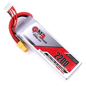

GNB 2200mAh 4S 110C LiPo Battery
GNB 2200mAh 4S 110C LiPo Battery.

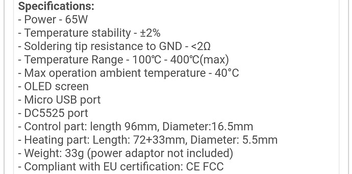

Steve. How much does the iron draw?
ooooh! 65w at 4s is. Um. 4a?

I haven’t got a ts100 man
I use a 4s with my TS100 and it works perfectly. The battery I’ve linked above here is a 4s.
I built my 2.5inch toothpick quad using my TS100 on 4s so I know it works
