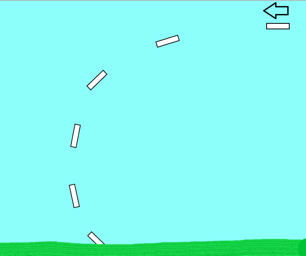

This is what happened yesterday (excuse the sketch). Is this possible in Angle mode then, because that is what I believed I was in last night.
Honestly Ive not flown much in angle mode as like the guys have advised you, they advised me the same about getting straight into acro. I had a couple of flights in angle mode and never tried anything other than simple flying around. I wouldnt have thought you could pitch the nose enough to dive back on yourself in angle? :thinking:
