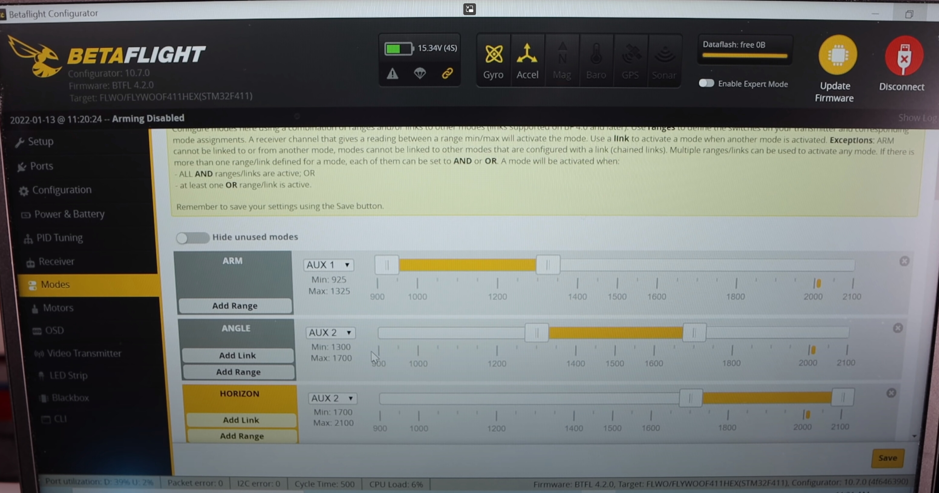

How can I tell that my modes are set correctly in Betaflight?
I followed this vid for setting up the quad with my Jumper T-Pro. The main settings from the vid for setting the mode is shown below, which is what I have …
But in the vid, Captain Drone didn’t show the Acro mode setting, only Angle and Horizon. Which makes me wonder if that is even setup on my controller.
Is your angle/horizon switch a 2 or 3 position switch?
3 position, back = angle, middle = horizon, forward = acro
With the quad connected to Betaflight, when I select angle on my controller, it does correctly highlight Angle in Betaflight. Same for Horizon. But my point is, there is no row in Betaflight for Acro. Is this normal?
Cool so basically if youre not in horizon or angle that means youre in acro. You dont have to actually set up acro it just means no other mode is active :+1:t2:
Got it. Thanks Steve, makes sense now :+1:
Acro here I come :grimacing::man_running::dash:
It is so much fun Chris youll love it :grinning:
