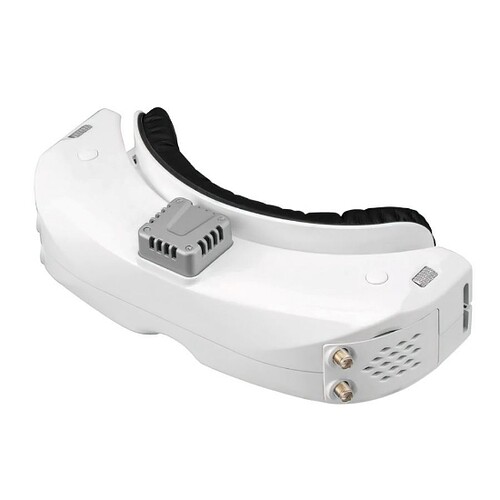

So, yes you can go with Fatsharks… though they’re not necessarily the best these days. Also bear in mind that you need to buy an RX Module with those and with the orqas below… but not the skyzones.
The Orqa FPV One Pilot goggles are regarded very highly…
The Skyzone 04X are also very highly regarded and work out cheaper because they come with a module.
(I have the Eachine version of these, EV300O, slightly lower resolution, but otherwise the same… not easily found now though.)
I bought Brendan, my son, a set of the Skyzone 04L. These are the same as the 04X, but with an LCOS screen rather than OLED. Note with both 04L and 04X, you may have to upgrade the firmware and tinker with the Mix/Diversity settings for some cameras. Once done you’re good though.
Others on here have the Skyzone Cobras… I’ve not tried these as I didn’t want box goggles after being fed up of the weight of my old EV800D box goggles.

Heh… yith… most over Ā£400 there… Don’t bother with the cobra S, get the X for sure.
Also the X has ability for head tracking, and HDMI input if you were ever to want to try HDZero in the future (cheaper HD than splashing out full DJI!) Im not there yet… lol

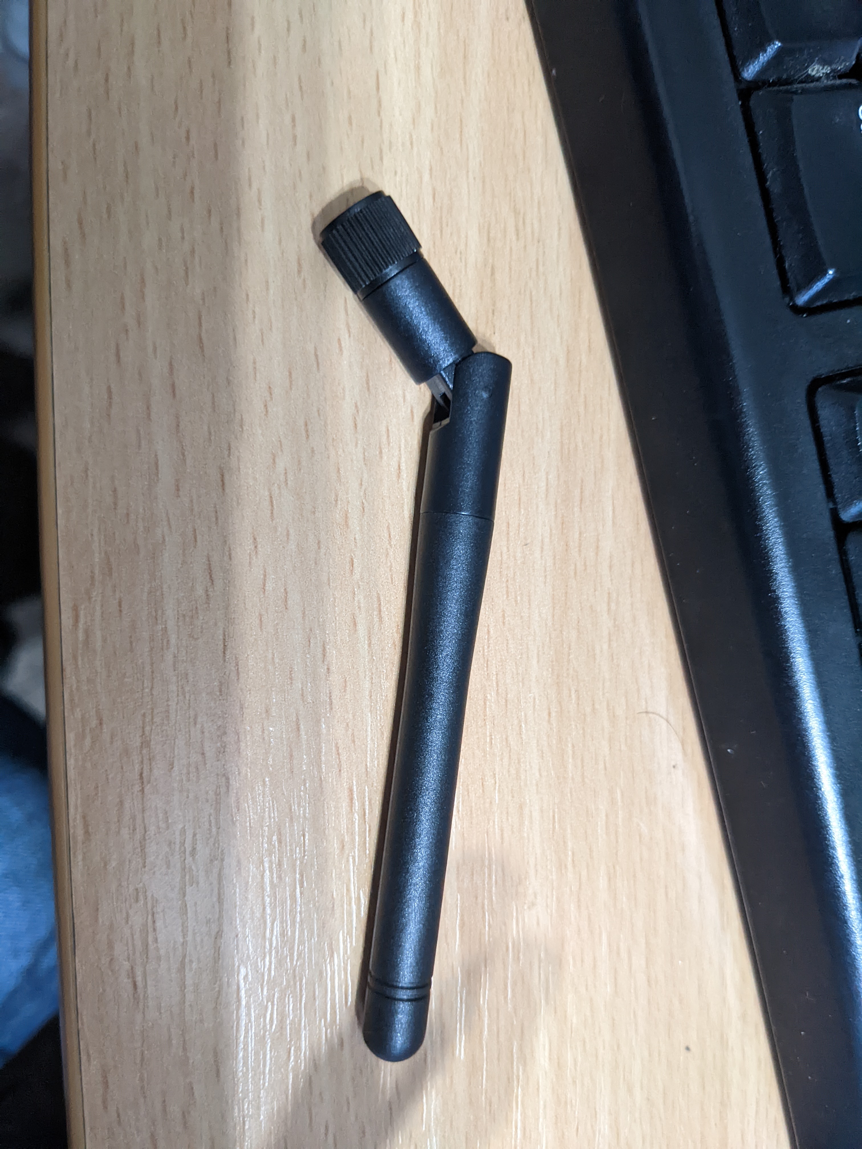

Pretty much all goggles come with poor antennas… Or do FPV’ers just love to tinker…
Cool… I never looked at the cobras as I was determined that I did not want box goggles under any circumstances… I love how small my EV300O goggles are…
They all THIS bad?
Pretty much… even on the skyzone 04X
Orqas don’t even have any.
BTW, The Skyzone 04L is under Ā£300 and should be considered if you don’t want a box goggle.
Skyzone 04X and 04L do as well.
