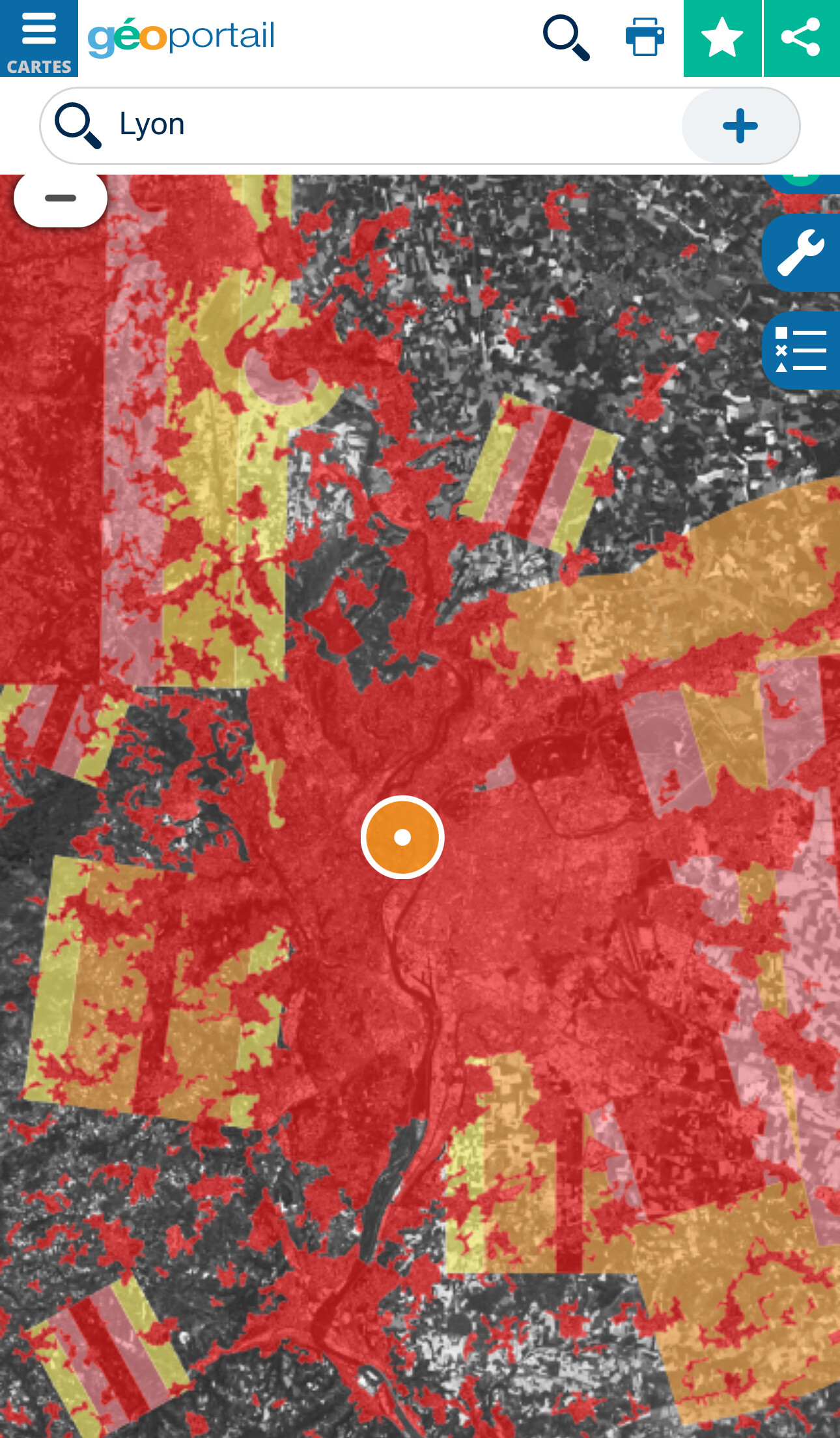

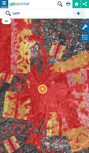

Just back from a couple of days in Lyon and I chucked the Mini 4K in the bag just in case I got a free moment. Turned out to be not as straightforward as I’d hoped.
Whilst (allegedly) following the same rules as other EU nations, France puts its own layer of je ne sais quoi on top of everything.
Basically, drone flying is banned:
  • In any urban area (and just a few buildings counts as urban)
  • All national parks
  • Along a significant majority of the coast line
I have also read that not only TOAL but flying over private land is also banned (without owner’s permission)
Which severely limits the options tbh!
Here’s the link to the French geoportail so you can browse for yourself… compared to this, the UK is an open playground!
So - if you’re off to France and want to stay within the rules, you’re going to be pressed to find somewhere (that’s actually interesting to fly!)

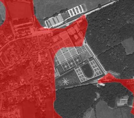

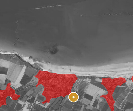

It’s not easy for sure, but I did manage a few flights recently. Chateau Villandry (early evening), Bourdeilles in the Dordogne, mid-morning’ish, largely keeping the drone over the river thus avoiding the chance of unintentional overflight, and then a reasonable overflight on the coast by Gold Beach at around 9:00am. Cliff top launch, then straight out over the water to capture the old Mulberry B remnants. The below snap shows the chateau and its grounds, I managed to stay out of the red quite successfully as I was not logged into DJI Fly and my range was limited to 50mtrs @ 30mtrs altitude :joy: :joy:

Options in Lyon were umm…. :disappointed:

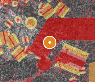

Arromanches les Bains worked out OK, but Bourdeilles was a definite no-no looking at the GeoPortal again :face_with_peeking_eye:
Oops :woozy_face:
To be fair to us, I read links to ‘drone laws in France’ and only with some detailed searching did I come across the geoportail.
Tbh it’s somewhat disingenuous that many, many sites give the list of the rules, which match the standard EU rules, without mentioning or linking to the official portal that paints a very different picture.
