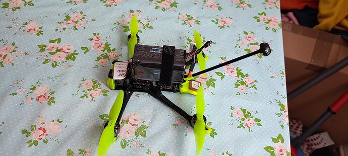

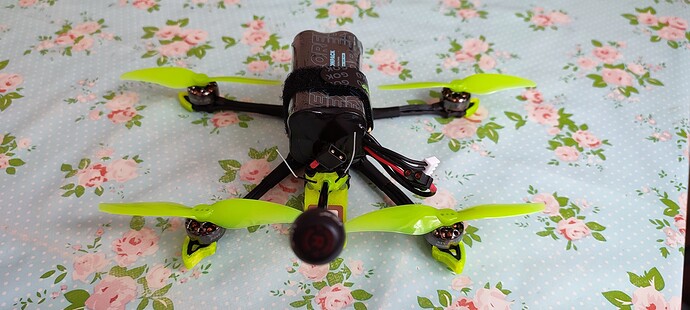

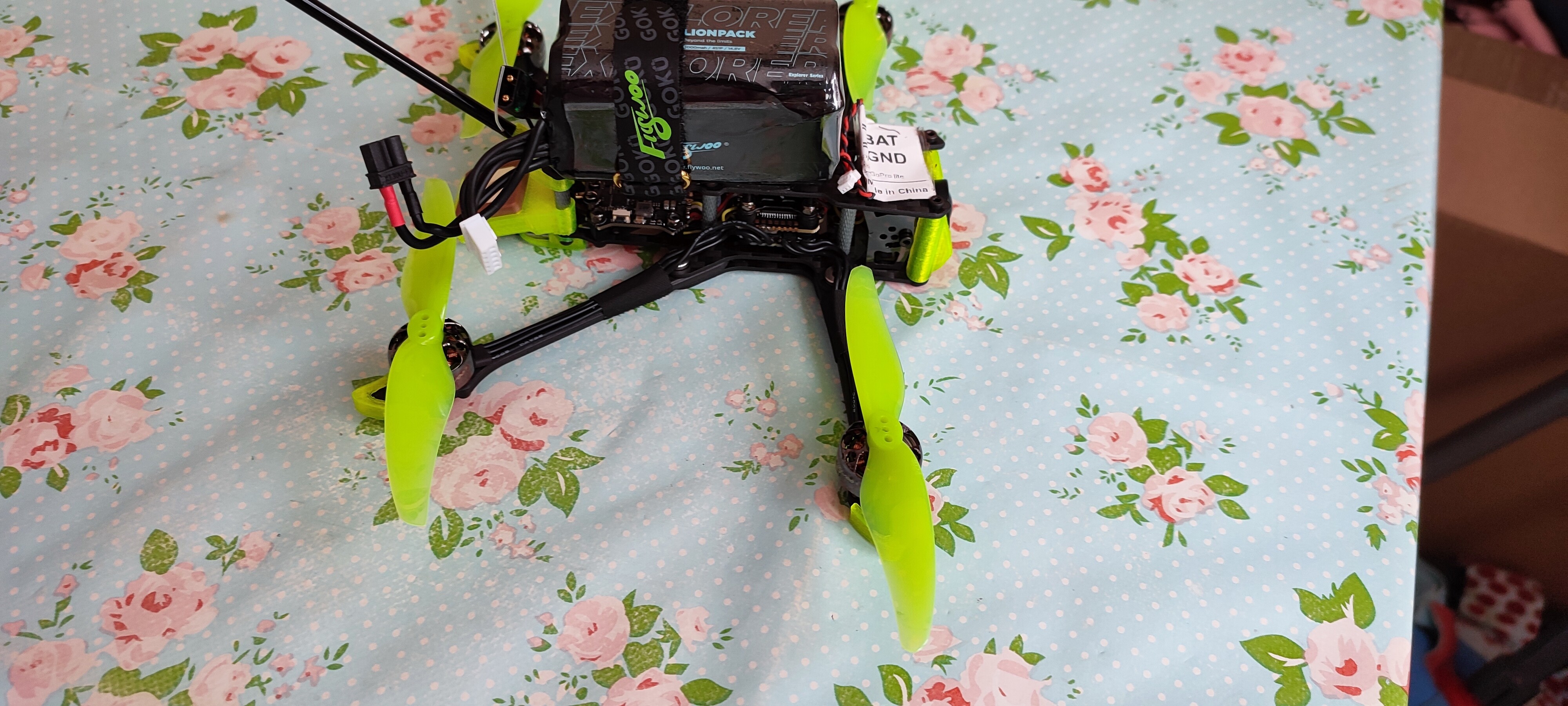

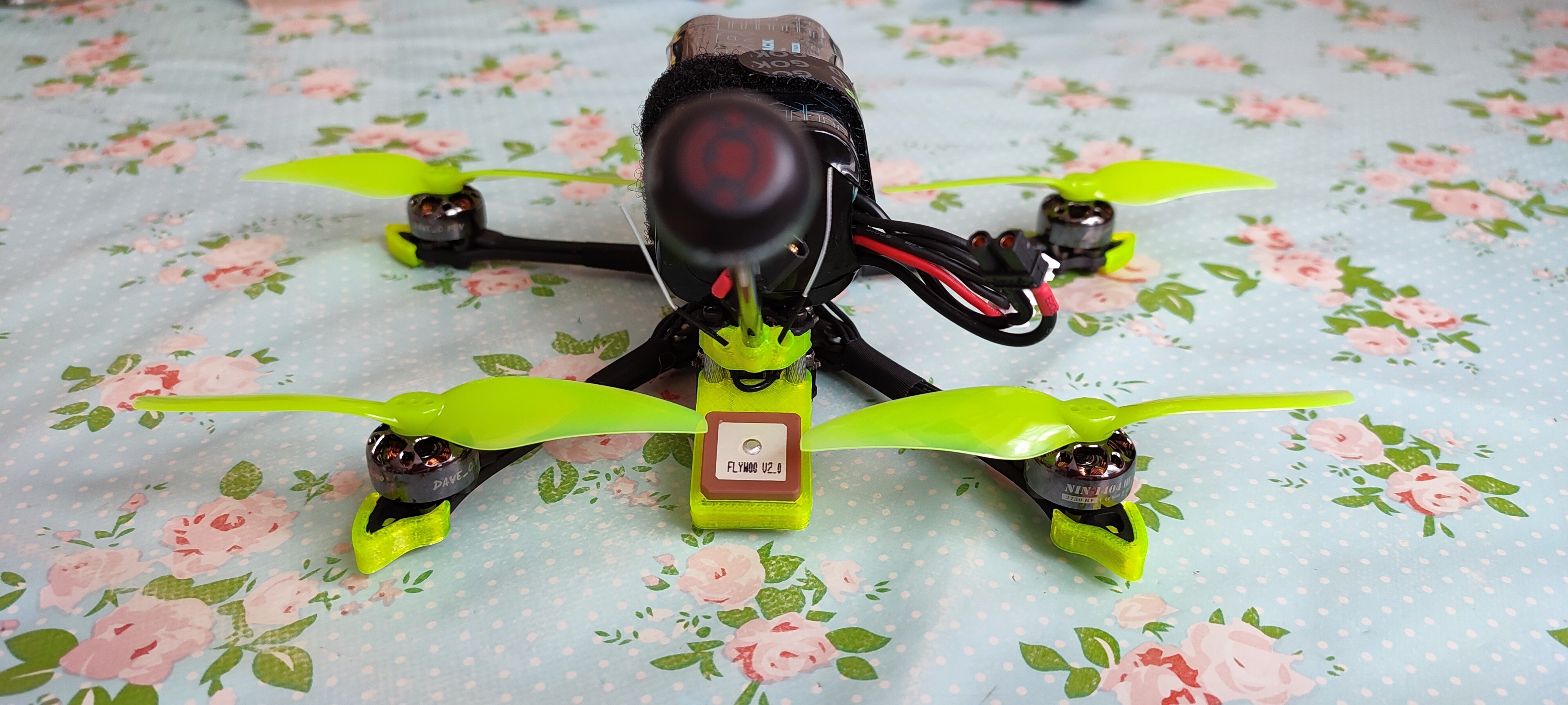

I have taken some pictures below to show how my props are set as I couldn’t get liftoff from the ground for some reason when I tried my first flight.
These are the props out on the table, can you tell me which ones should go where?
They are set to props in which in the manual is what it should be set to. When you guys were setting it up yesterday did you do anything to change motor direction at all?

those look correct for a props in configuration.
will depend if the friction fit of the motor shaft was tight enough. if the motor shaft is spinning inside the hub of the prop its going to have a really hard time getting any lift.
