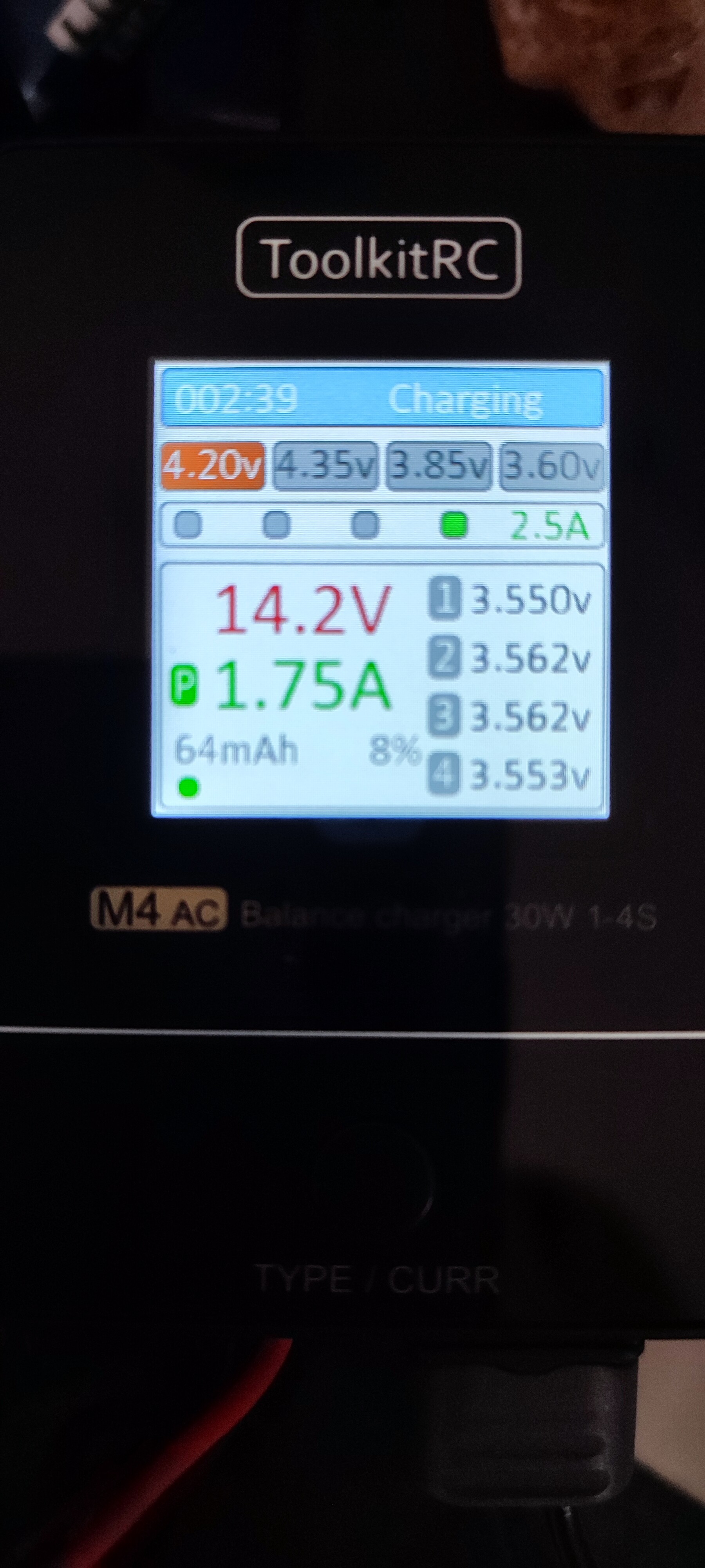

Ok I have put it on, this it what it shows shoes this look ok
Is this ok? Or is it set to high? I have no clue what any of this means here
Lipo batteries need charging to 4.2V per cell but as I say Im not sure about Li ion batteries. @group-fpv Im sure one of these guys will be able to give advice on Li ion charging. I wouldnt start charging it until youve had confirmation as charging batteries at the wrong rate or to the wrong voltage can damage the cells or even worse cause a fire

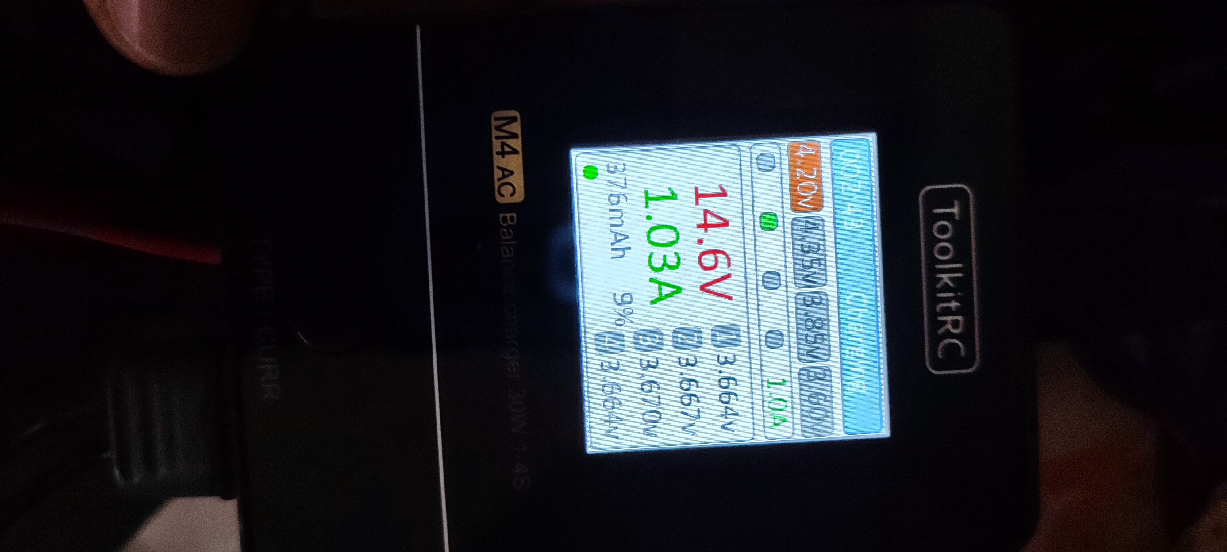

Ok I have switched it off for now until someone gets back to me. I did change the setting to what I think is a lower charge rate as the picture shows below as the figure now sits around 1.03a as opposed to 1.75a
I’m assuming a means amps?
Li-ions are 4.15v. 1c charging is usually fine :+1:
