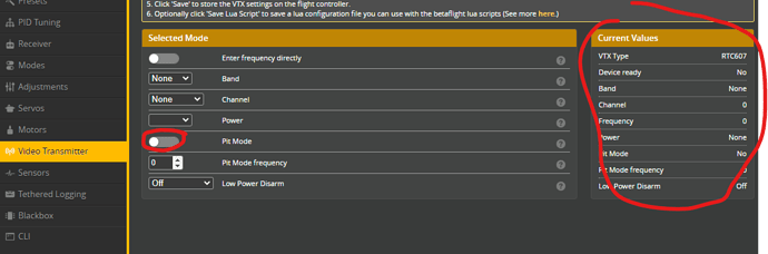

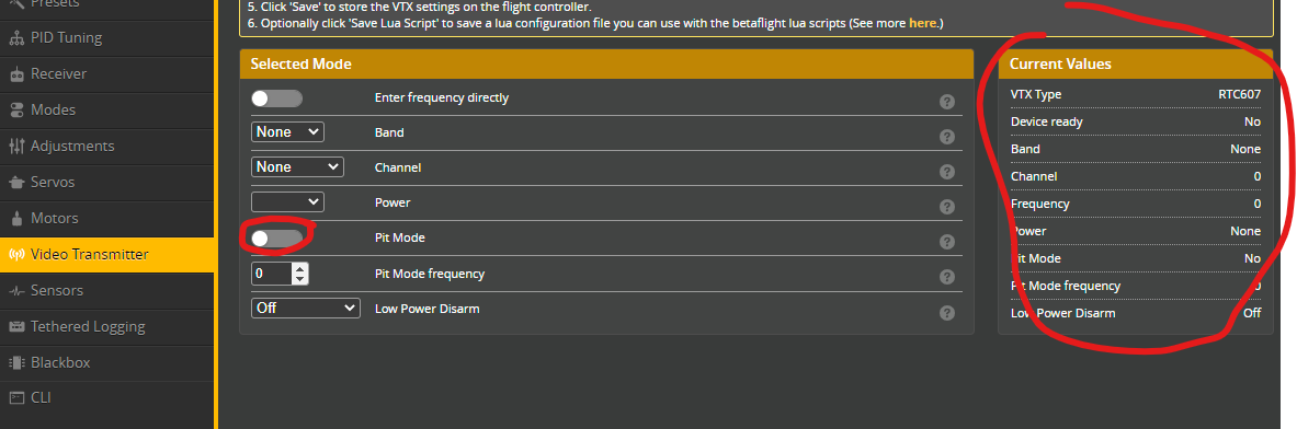

If you can get into betaflight (which you should be able to), you can turn down the VTX power to pit mode (if supported, when you press save it’ll either be on or off), will help but even then will get hot! Just make sure when flying you up the VTX power later :slight_smile: Loads to remember. You can check VTX power state on the VTX tab, and details on the right on what it supports, etc (my screenshot just virtual mode, i.e. no quad connected)

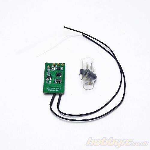

flux, flux flux… and some heat :wink: De-Solder from the Receiver end, as if you mess it up and break the RX, it’s a lot easier (and cheaper) to buy and replace a £12 RX, than a £50+ Flight controller :slight_smile:
Yeah thanks for that, so I now have both confirmation from hobbyrc that their radio is on accst V2 EULBT
and flywoo have just told me that their reciever in my drone is on FCC v1 so there’s my problem I guess?
As I say will be having a mate who does mobile repairs unsolder today. I’ll let you know how it goes and yes will be from the receiver end thank you for that
Hi guys, so the guy at hobbyrc now says its would be easier for me to just buy a new receiver which is the correct firmware. Rather than sending the one I was about to unsolder today to him?

He’s recommended this one
HobbyRc know there stuff, and they sold you the controller too so he should know which firmware the new receiver is on and if its compatible. Its probably not a bad idea to be honest

Also, check exactly which version you need. From the product listing:
**** PLEASE NOTE, New Stock now ships with ACCST V2.1 (EU LBT) Firmware on. Its far more likely you want ACCST V1 EU LBT firmware so if in doubt, please choose a different firmware option or contact us to discuss before purchasing ****
I’m sure they’ll make sure you get the right one.
