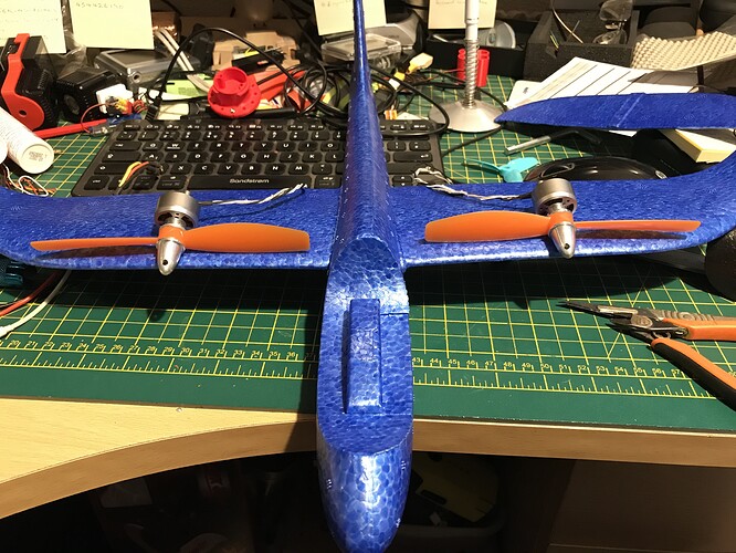

Digging even deeper in the workshop, I found these props which will require reaming out to size. They are 6X4.5 I think the’ll not draw a higher current than the stock Dji which are 8X3.3, will see.
Ready for the foam glider and beyond….thanks to @notveryprettyboy great idea.

I cut some lines in the foam to guide the servo wires. It weakened the frame. @Steviegeek has suggested a cf spar in the wing.
Ah yes, the wings bent upwards… I thought for a while that was normal, but yes the slots will cause that.
Also look at using gaffer tape on the top of the ailerons as hinges. Simpler and probably promotes airflow better than the way you had it. It’s what my now destroyed 3d printed plane had and works pretty well.
Yeah. I’m going to. Plus I’ll make the flaps longer and wider.

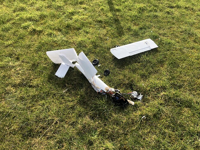

It’s not mine. Ii’s @Yith brilliant frame. 1 layer thick!

I printed it a couple of months ago. There are posts about it. It was about time it got its maiden flight.
My first fixed wing with predictable results.
I wanted to alter it anyway.
“If you dont make the turn, you aint never gunna learn”
It did what you wanted it to. And it took off well.
