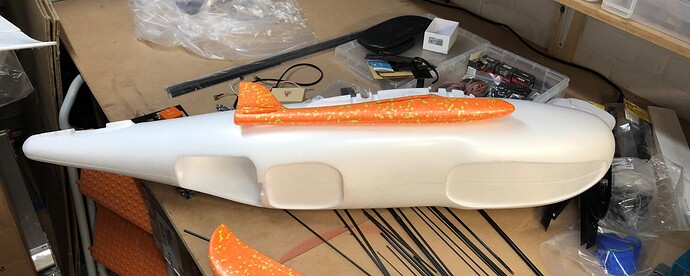

Learning from Karls @notveryprettyboy experience, I intend to strengthen the wing and fuselage, 'cos as soon as we start cutting holes in the foam to fit our kit the firmness disapears.
Fortunately I’ve got in stock various sizes of carbon rod that I can use.
I’ve decided on a square section piece 3x3mm to go across the wings and elevator.
Also a round rod 3mm diameter to run along the underside of the fuselage.
Hopefully this should stiffen it up enough.
Again taking note of Karls post yesterday concerning the use of the elevator I’m going to use the option of tilting the whole elevator. I’ve got some 4mmOD, 2mmID carbon tube and 2mm rod which fits perfectly for this.

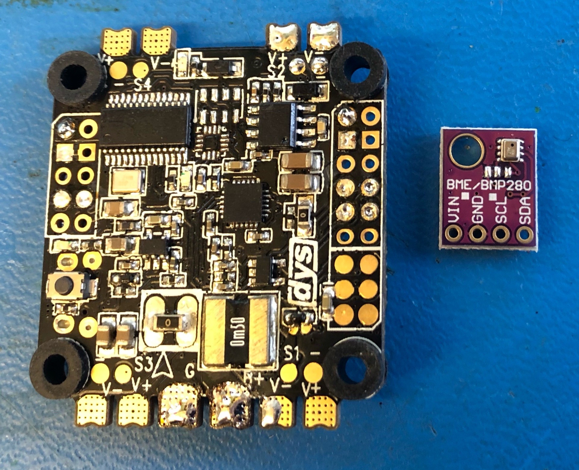

Again from stock I’ve chosen a DYS F4 PRO V2 flight controller, it’s not an all-in-one but does have PDB built in so easy connection for ESC/motor power. A minor hiccup is the lack of a barometer so I’ll just hot-glue this seperate one on the top.
It will fit in the cockpit area, just. Ideally I’d get a 20x20mm size (this is 30.5x30.5mm) but part of the challenge with this project is to re-use as much stuff as possible and avoid spending loads of cash.
