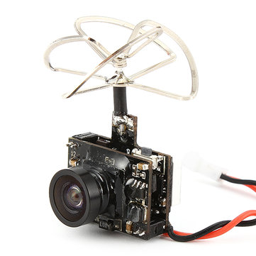

All you do is buy an AIO (all in one) fpv camera and video transmitter for around £10, strap it to your drone and wire it to 5v in your drone (this may be the difficult bit for most people), and then buy cheap goggles. The cheapest I recommend are the ev800. £45.

The AIO I mentioned is only 25mW (which is the legal limit :rofl:). There will be more powerful ones. As long as you keep good airflow over these higher power ones as they get hot quick.
It will go say 200 - 500m max I reckon without obstructions, but trees, especially damp ones will knock out the signal.

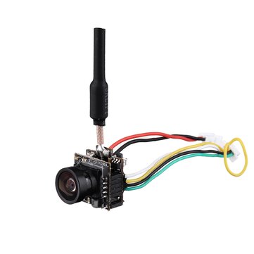

This vtx is more powerful at 200mw. But £6 more expensive :cry: lol

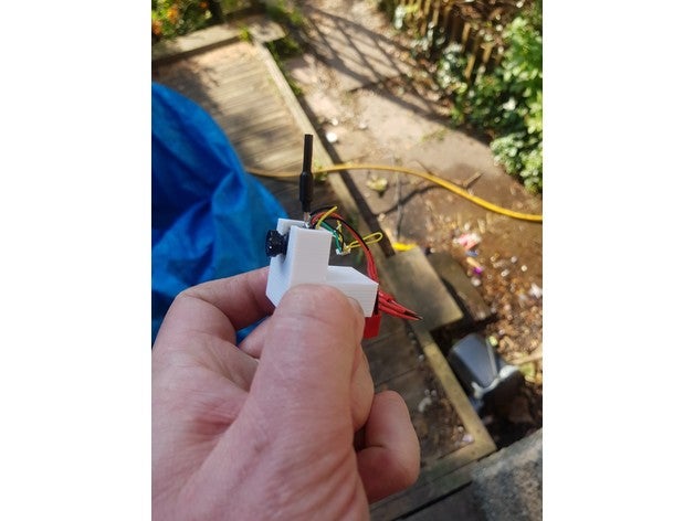

Nice flight! Yeah I should have mentioned that… It your drone can take the extra few grams, use a small 250mah 1s lipo to power the AIO. So it really is AIO lol. I did design this a little while back that may help someone.

One thing I missed in my description on thingiverse is to stick a small strip of velcro or something on the lipo to stop it slipping out! :upside_down_face:
