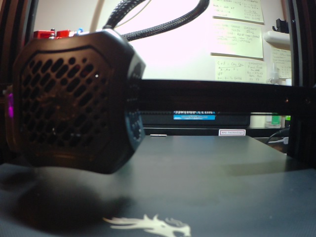

Evening, lcd stand what for :face_with_monocle:
Liquid Crystal Display :man_shrugging:t3:
Love it, I knew that, anyone in particular :smiley:
Check the live feed. its a 16x2 LCD screen
I see your hand move something, now it’s gone :man_shrugging:t2:
Yep I just see it, thankyou :white_check_mark:
