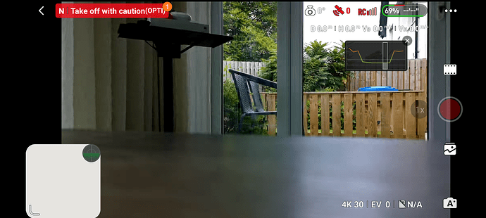

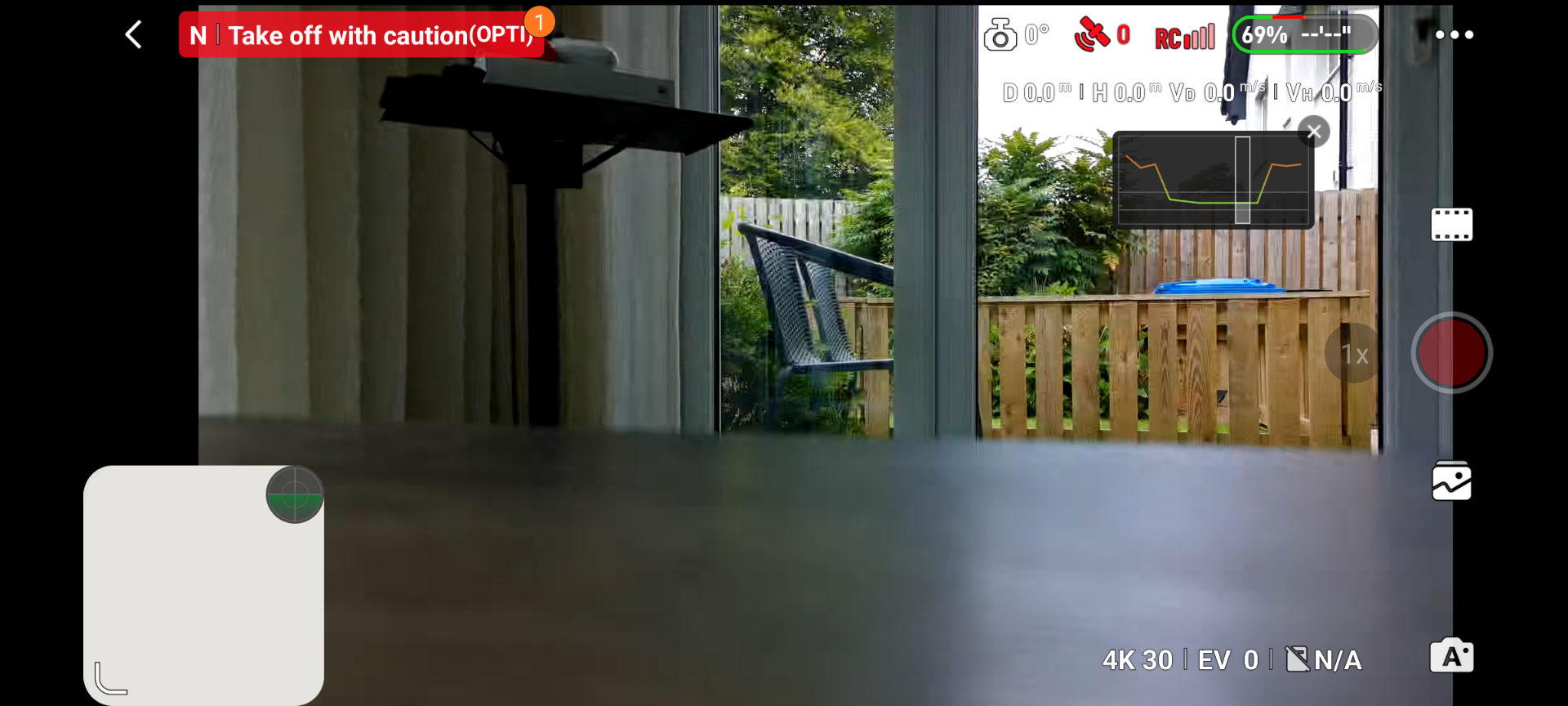

I’ll attach a photo for illustration of the icons. It has been taken indoors, so obviously no satellite fix but the RC is only at one bar despite the drone being right in front of me.
