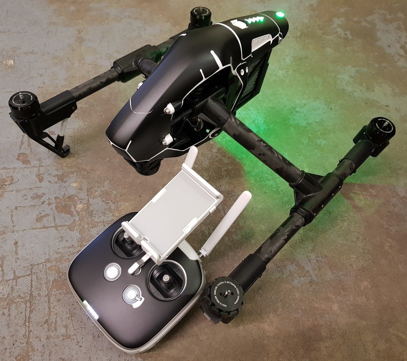

Nobody’s posted here for a while, thought I’d share my recent expedition in to the world of DIY vinyl wrapping.
This perhaps warrants a thread all to itself due to the length of the post. You’ve been warned… Get comfy
I recently picked up a second hand Inspire 1 and to be honest, I’ve never been a fan of that ugly white body!
The arms are made of some weird carbon fibre composite but they look pretty good, so I thought I’d wrap the white body shell in carbon fibre to not only match, but to hide that bloody awful white body!

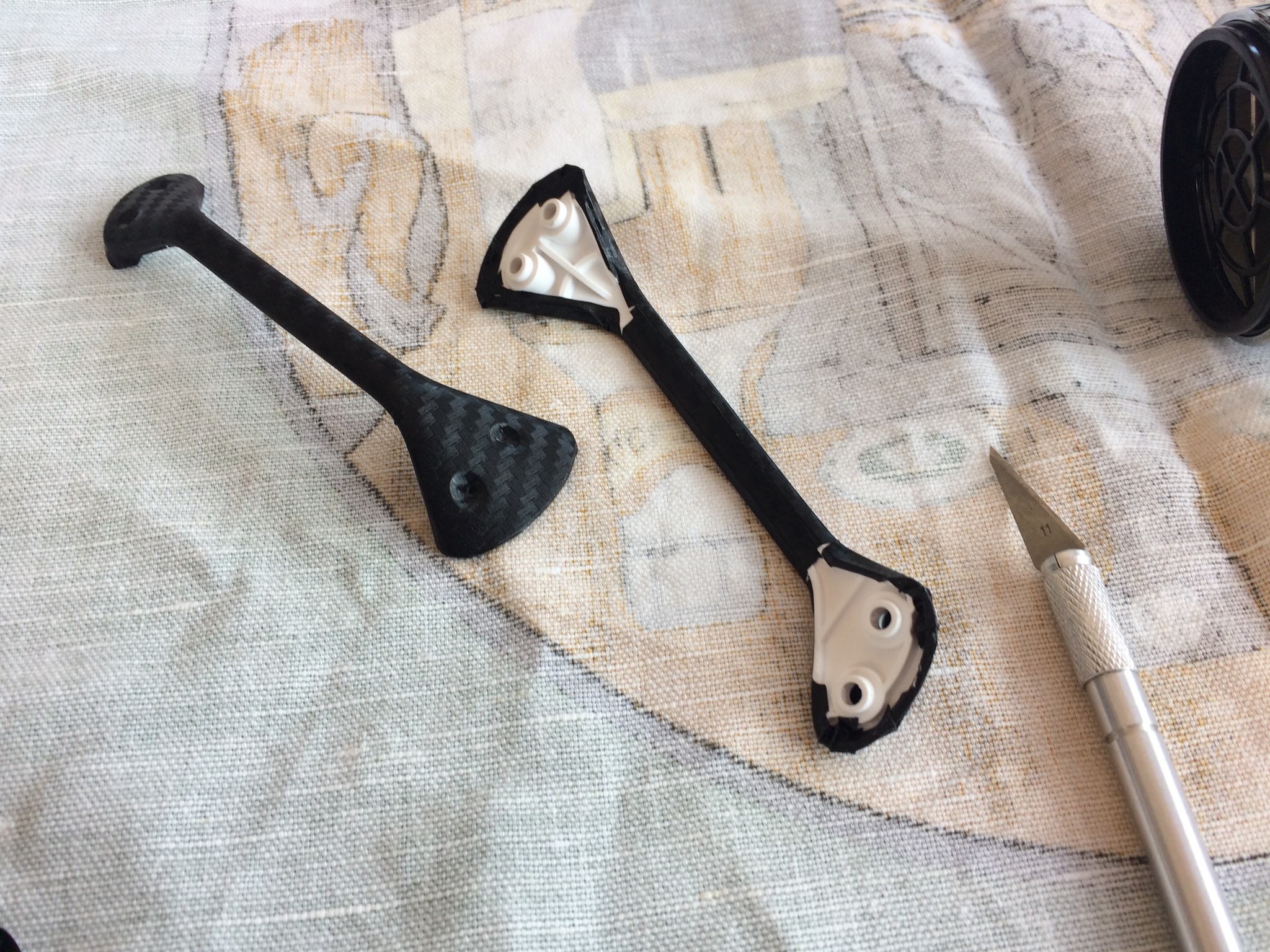

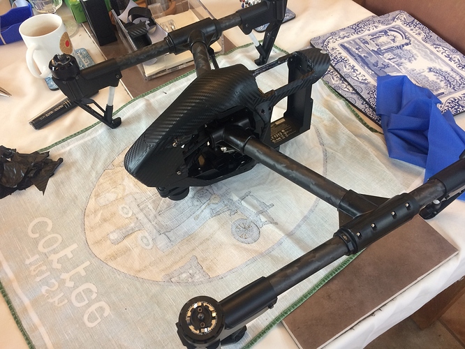

Easy bits first, right?

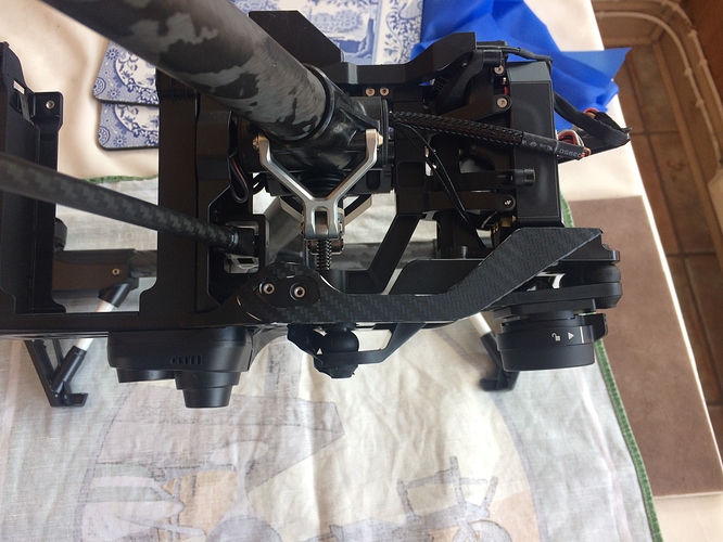

I removed the two side braces and applied the vinyl.
The hairdryer is used to soften the vinyl, it makes it really pliable and helps getting it around corners
First attempt at the lower body, I re-did these after taking this pic as I could still see some white on the tops!

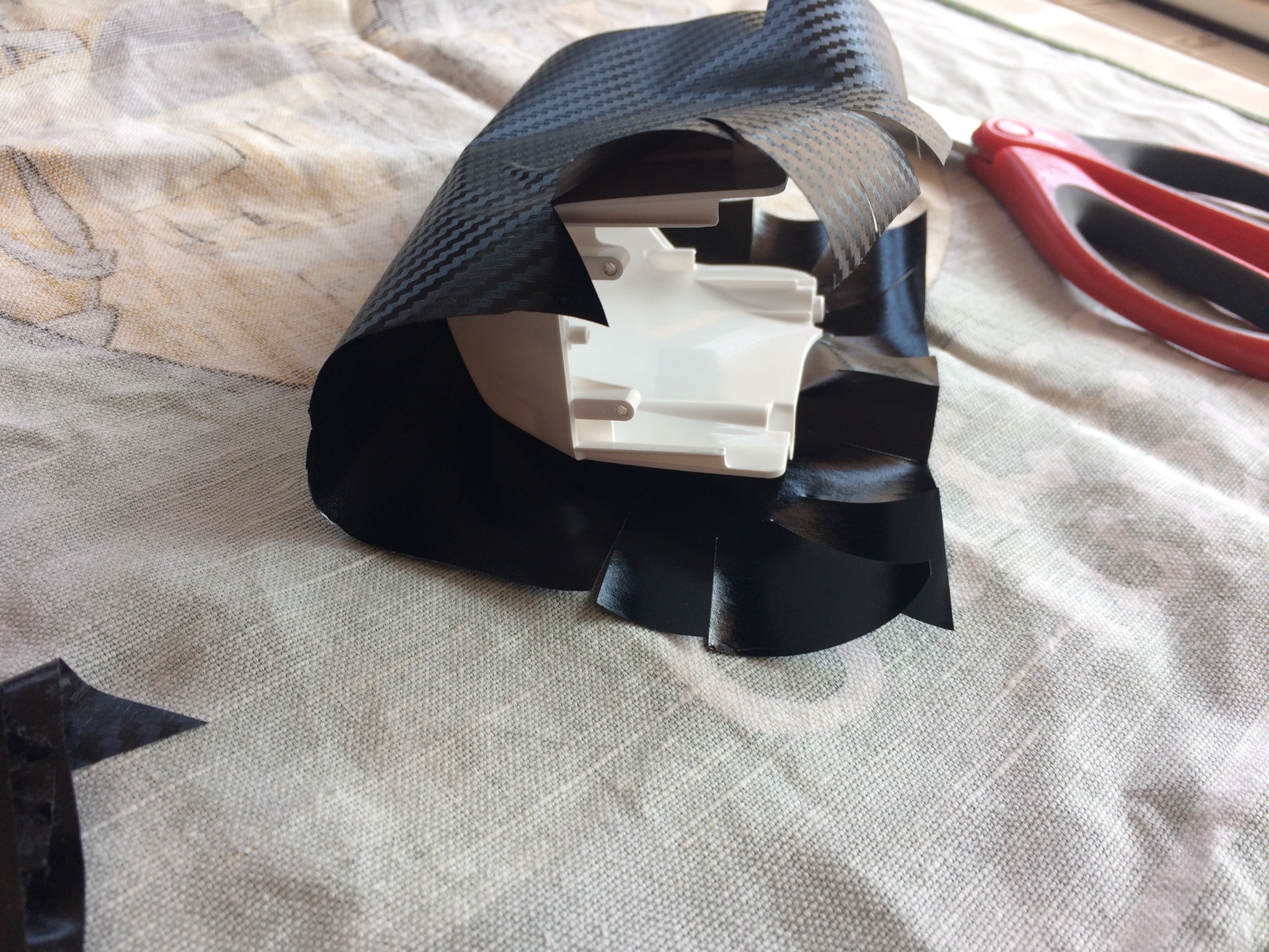

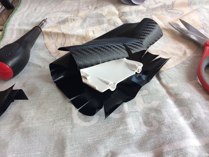

With the easy bits done, I then decided to do one of the many the hard bits - the nose cone.
I cut a piece slightly larger than needed and then applied it to the front, left and right.
Then I cut a load of slits in it, not right up to the body (as that’d expose the white) but enough to help in bending it round the corners.
Then end result?
Bloody awful!!!
It was absolutely impossible to do…
After about an hour I’m thinking it would have been far easier just to spray paint this thing.
Anyway, in for a penny and all that. I then tried again.
Half an hour later, same result - impossible.

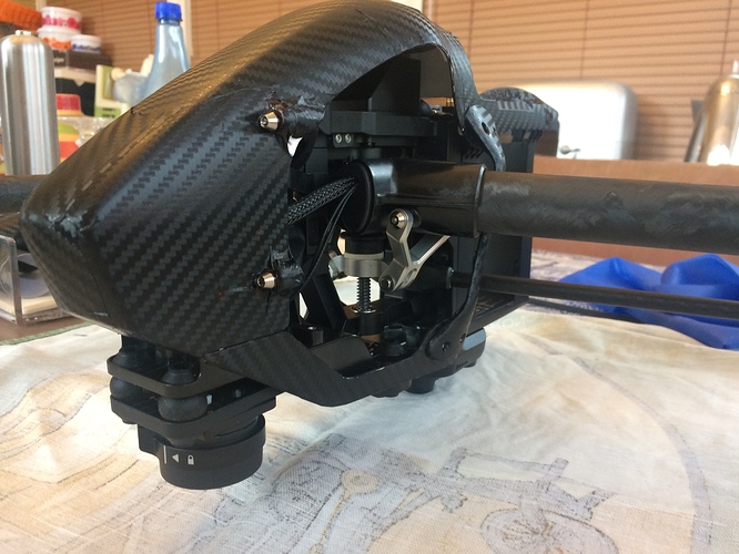

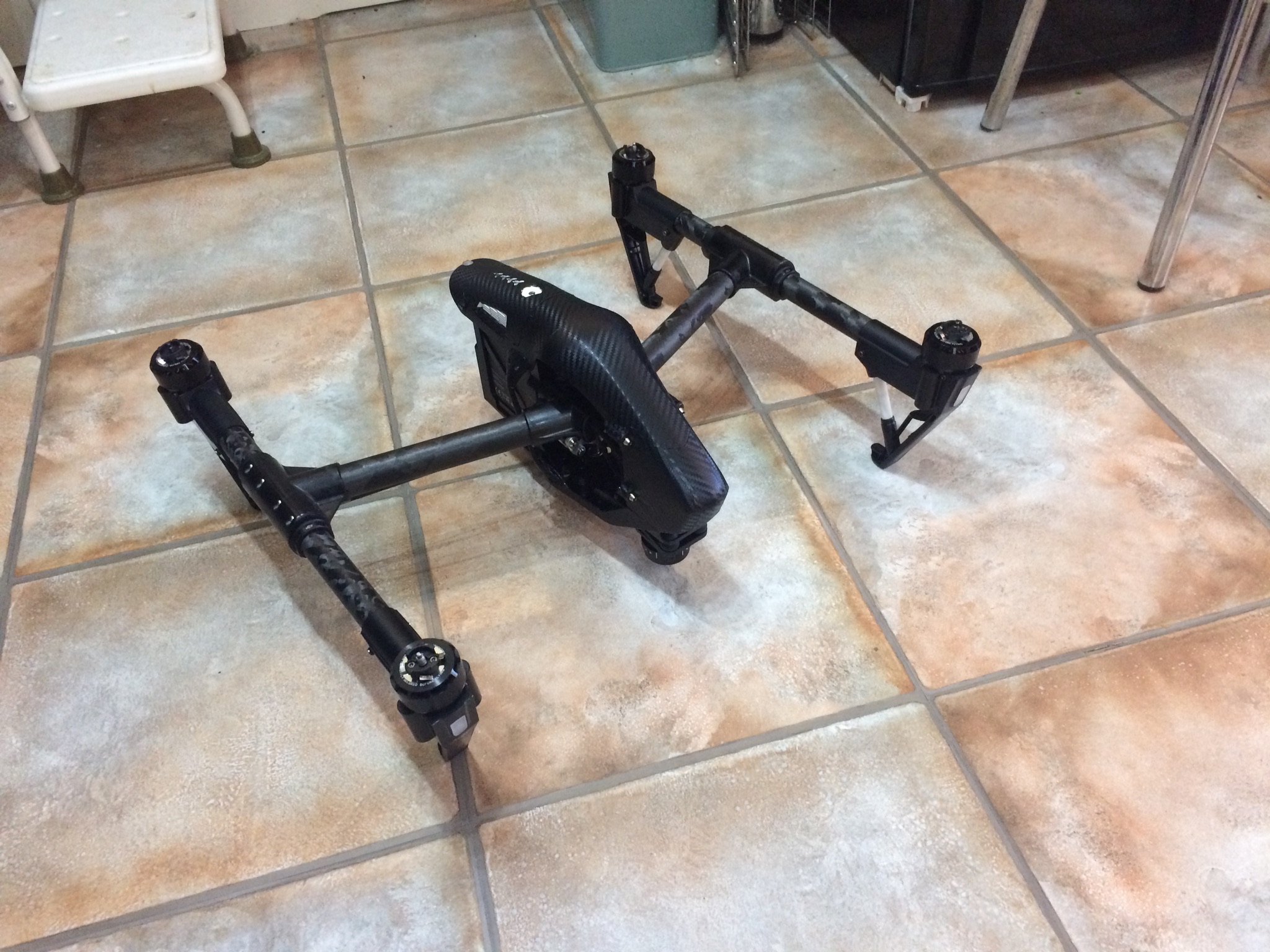

I didn’t photo this part, sorry, but I then applied one piece to the left side of the nose cone and one piece to the right. With the two sides in place, I then cut a straight ‘strip’ to cover the front of the cone, with some overlap to just about stretch over the sides too.
It’s not perfect. In fact my OCD is playing havoc with me today, but it’s the best I could do.
For some reason I forgot to photo the top while I was doing it, but I had similar issues, just too many subtle curves!
Not to the same degree thankfully, I was able to use just one piece of vinyl, but there are two tiny little creases visible. Again, this might play on my OCD after a few days, we’ll see how it goes.

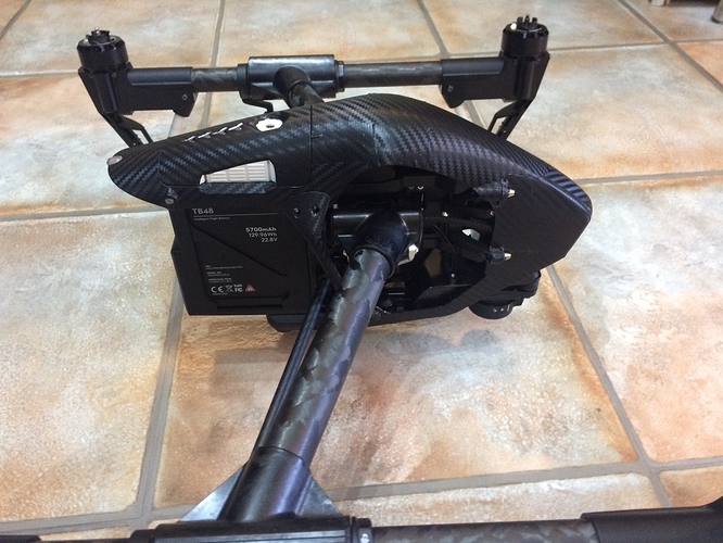

The end result, when viewed from four feet away isn’t too bad:
Close up however, and you can see the small crease on the top.
You can also see the join/overlap on the nose cone too:

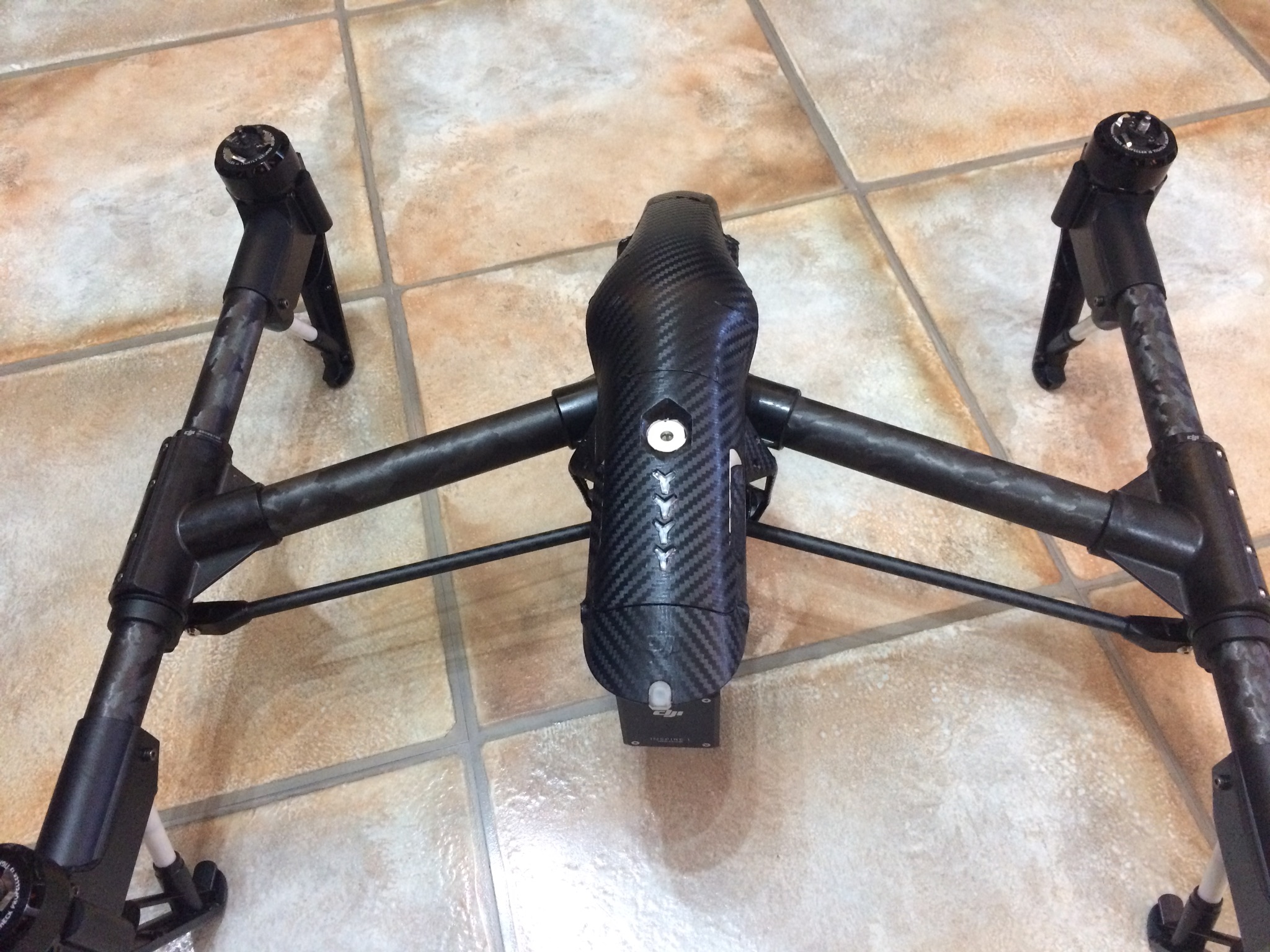

So that was the main bird done.

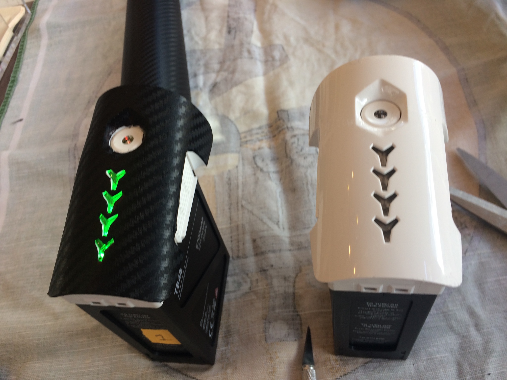

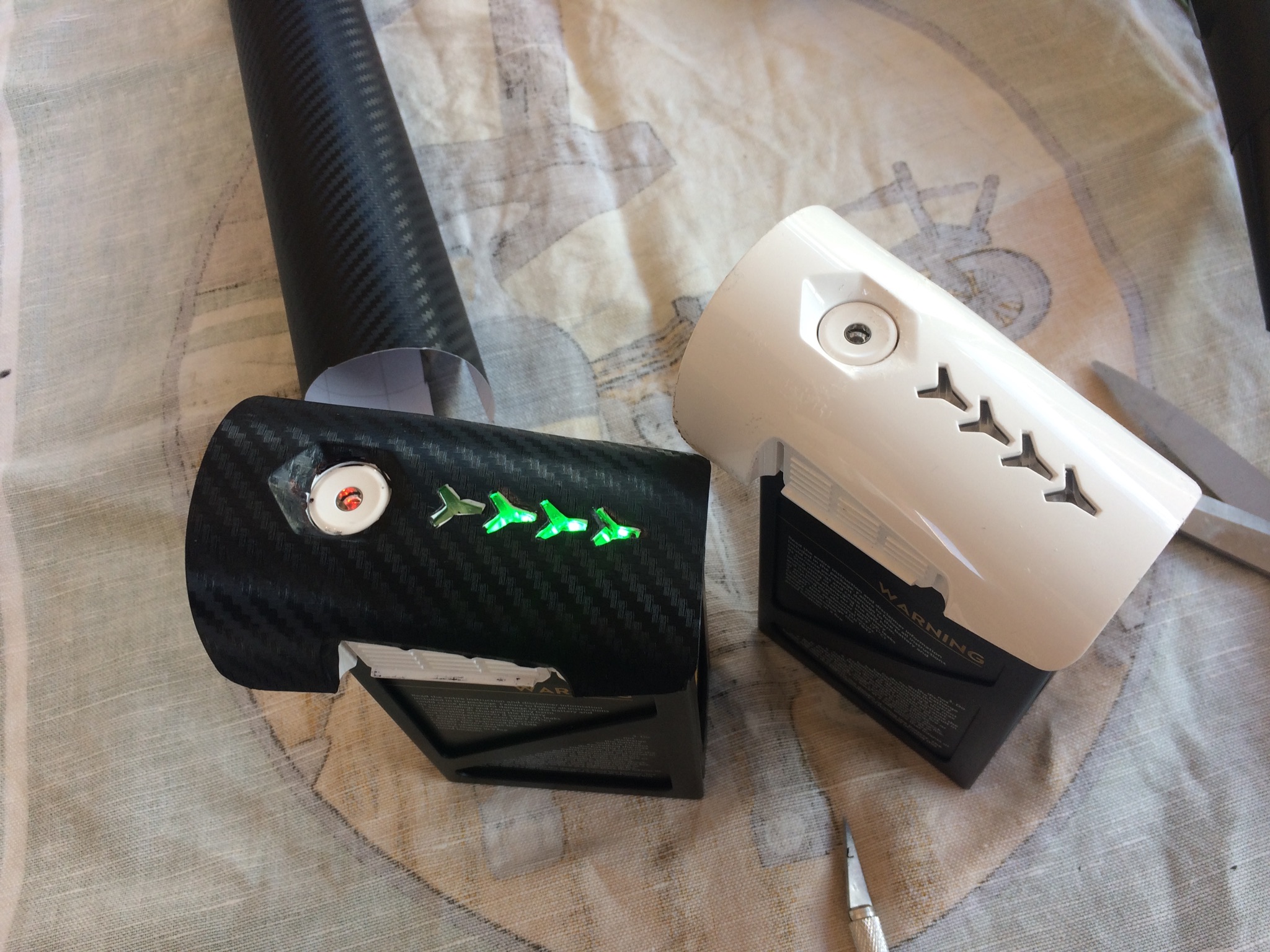

Now on to yet another nightmare part - the sodding batteries!
These things curve, only in one direction so not too bad, but the killer part here is, well, killer parts plural, the catches to release the battery, the depressed power button, and the shape of the LED lights.
See how far inset the power button is? In kinda a pointy diamond shape recess?
And!
Whose bloody idea was it to make the LEDs this shape?!??
The gap between each LED is <2mm. Nightmare to cut out!
Anyway, I kept going…
The end result?
To be honest, it’s “ok”… Close up and it’s not perfect by a long shot, but from a distance of just a few feet it looks pretty damned good
And best of all, no white slits everywhere!!
I might paint the battery release clips black, just using some matt nail polish or something? A little tin of model paint? Something like that. Not sure about the power button on the battery either.
