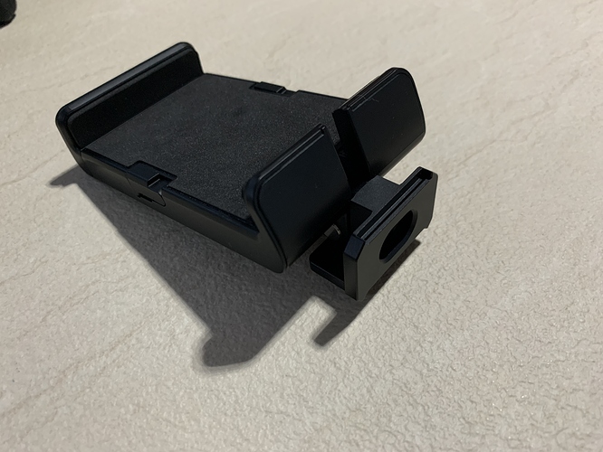

I also bought a device holder for a controller I don’t own :slight_smile:
This holder is for the DJI Cendence controller and it mates beautifully to the DJI quick release mechanism and allows you to use a mobile phone or other tablet with ease.
iPad (normal size, not Mini) fits great.
As does the iPhone.
The advantage here being that if you don’t want to use the CrystalSky for whatever reason, you can use a phone or tablet without needing to unbolt the CS adaptor arrangement.
