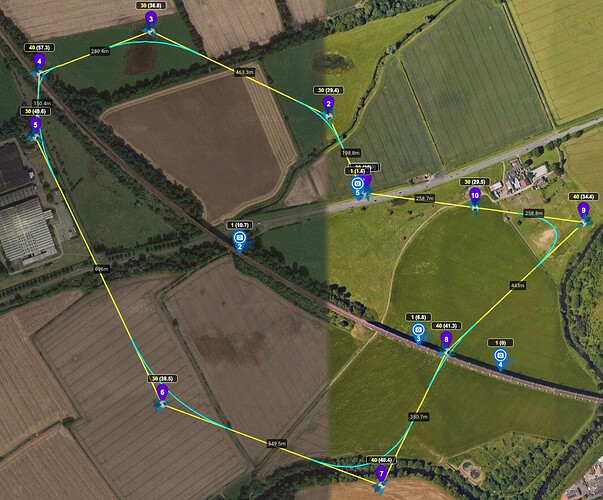

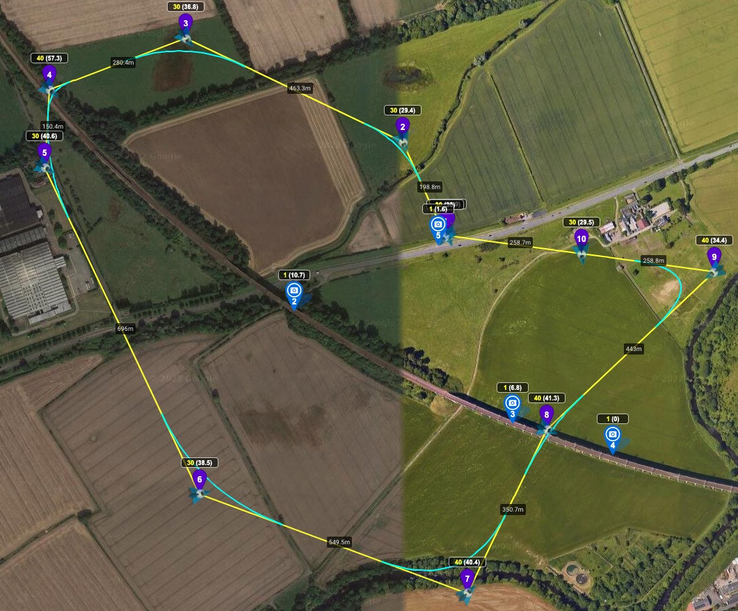

For example, this mission to film the Almond Valley viaduct:
looks like this in the planning stage:

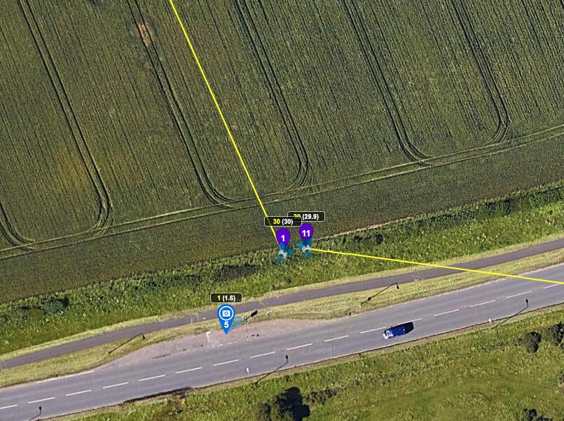

That detailed clump of data in the middle looks like this close up:
and has the starting (1) and end (11) points close together over the layby where I parked the car (PoI5).

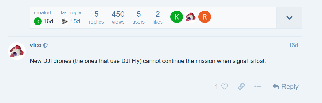

All new drones that use the fly app use Virtual Sticks and if the signal is lost will return to home/hover or land depending on which setting you have selected
Thanks for the confirmation :+1:t2:
I was wondering what their definition of new/modern was, good to know that everything using Fly is virtual-stick based, makes it much easier to work out compatibility :slight_smile:
(It also makes it a crock of shit - but that’s DJI’s fault, not Litchi’s)
