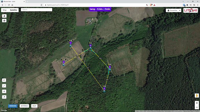

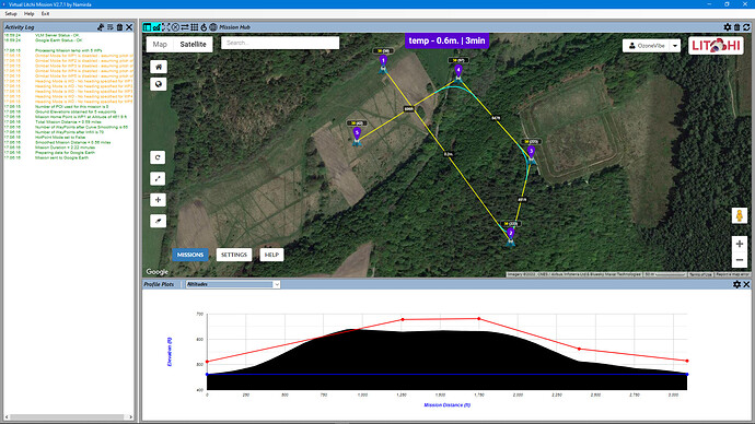

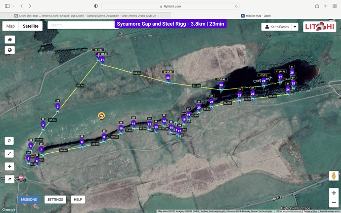

Created a quick, silly, mission in the rough location you’re planning.
Screenshot from Mission Hub …

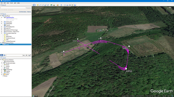

Screenshot from VLM … note path/ground profile showing hitting the deck between WP1 and WP2 …
Screenshot of Google Earth …

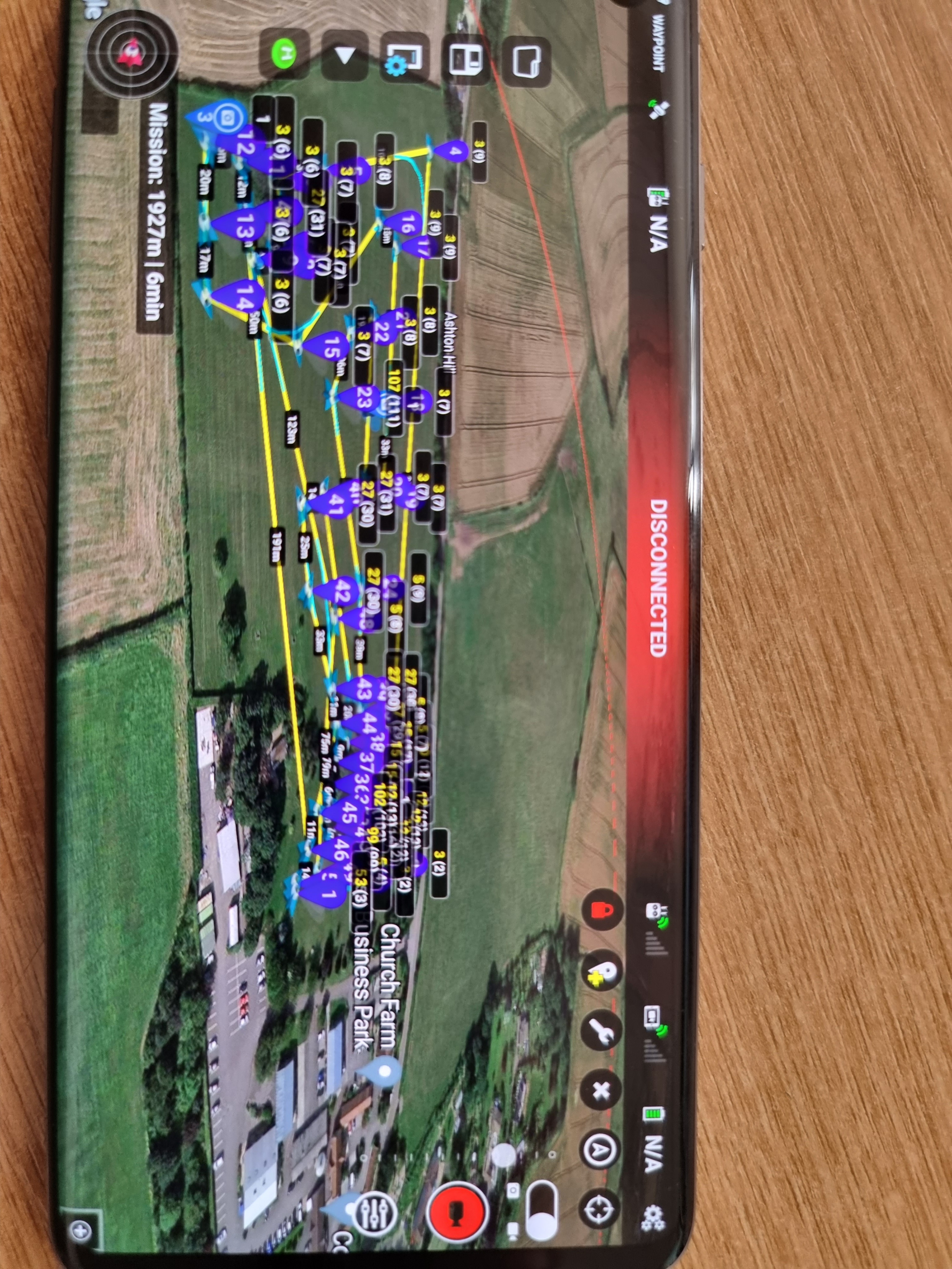

Managed to plan a little mission but need to work out adding POI for the gimble ‘follow POI’
Was just showing the 3 screens.
Right click for POI. :+1:
Best to set POIs before WPs … or you’ll need to go back to each WP to tell it the WP to be looking at. :wink:
Thanks Dave, just realised that! :joy:

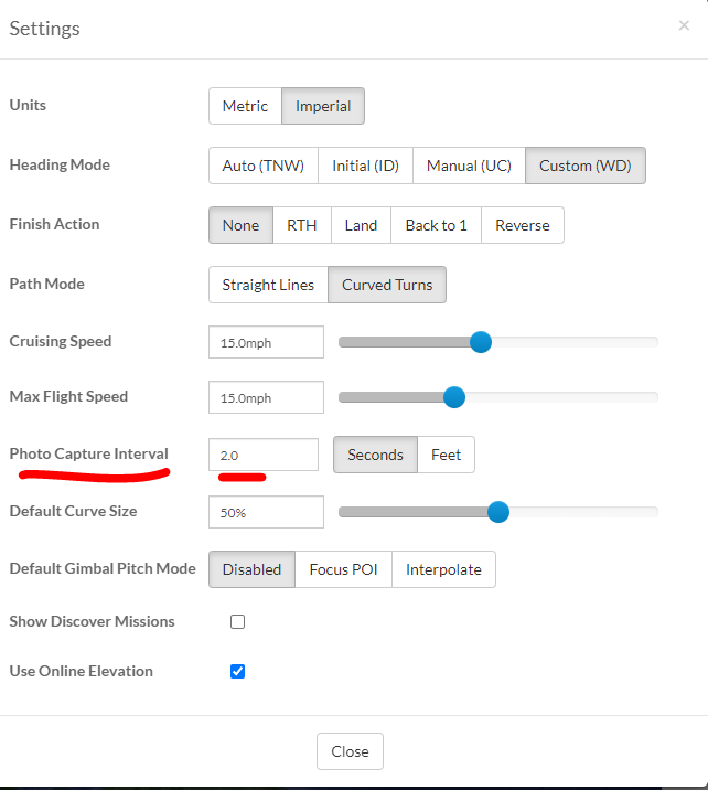

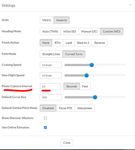

How do you set litchi to continually take photos through out the whole mission say every 2 seconds. Just as you would with a hyperlapse?
Mission settings …
Thank you
Probably the same in the app - that was Mission Hub, obviously.

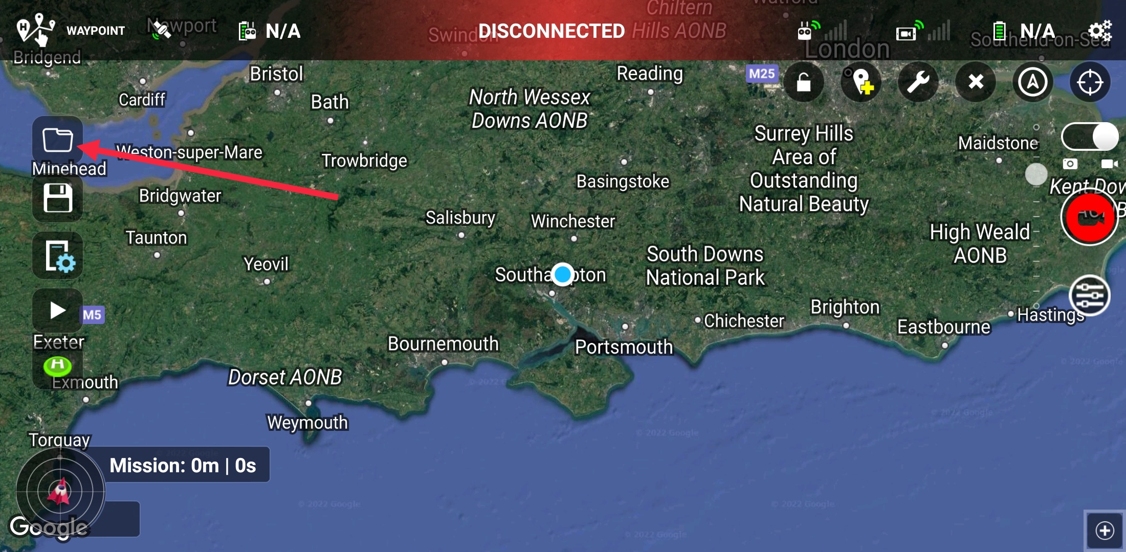

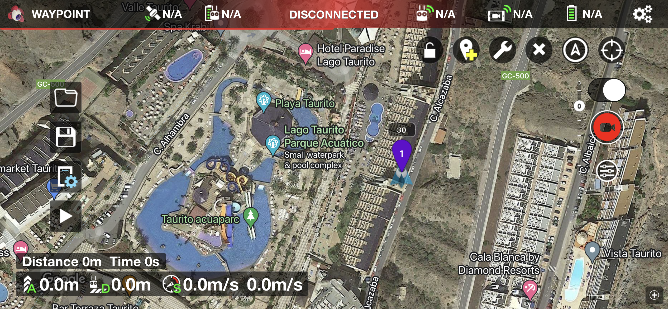

I need help!
On the desktop I am logged in :white_check_mark:
On the app (ios) I am logged in with the same username :white_check_mark:
I create missions on the desktop :white_check_mark:
However, I can’t see these on the app and when I click the open icon the loan mission box appears but is blank :x:
I really can’t establish what I am doing wrong. I have tried logging out and in on the app.
Any thoughts?
Strange. Never had any sync issues between several devices and a couple of laptops.
Have you tried creating a random mission on the ios device and saving it, and see if it appears, and can be opened, on the desktop?
If it doesn’t, I’d log out of both and log back into both. A bit of a “switch off n on again” response, but can’t think of anything more practical.
I have just figured it out!
Rookie error…
Didn’t realise that you need to go to Waypoint in the left menu, before you can open a mission.
I just assumed that as the open mission was there it could be done from any screen.
Seems a bit daft having the open mission option when it isn’t possible.
Should really be hidden or work from any screen.

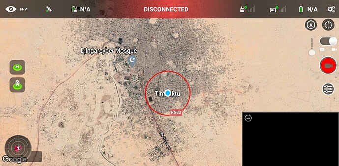

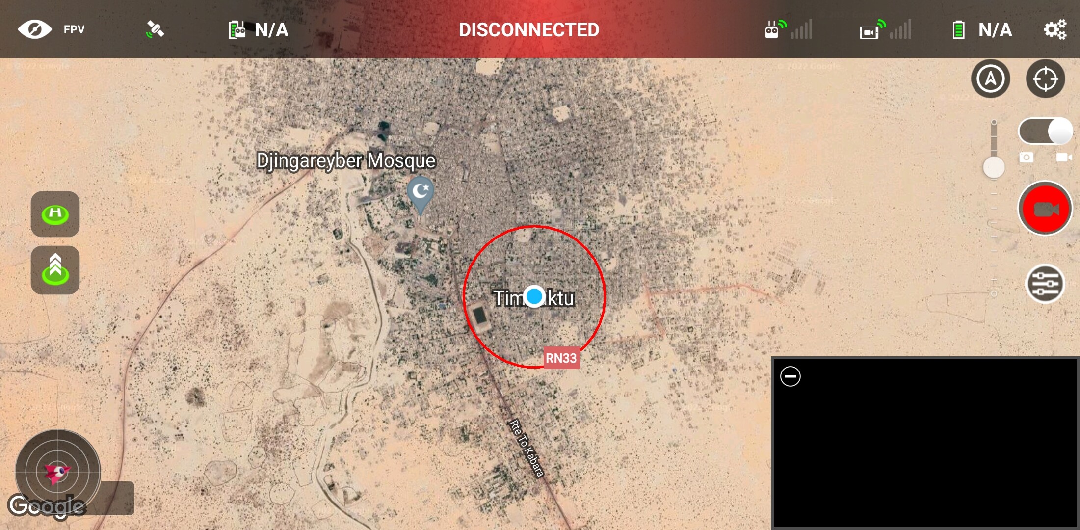

Must be an ios anomaly … the open mission icon isn’t visible in the opening screen on Android.
You have to change to Waypoint mode for it to appear.

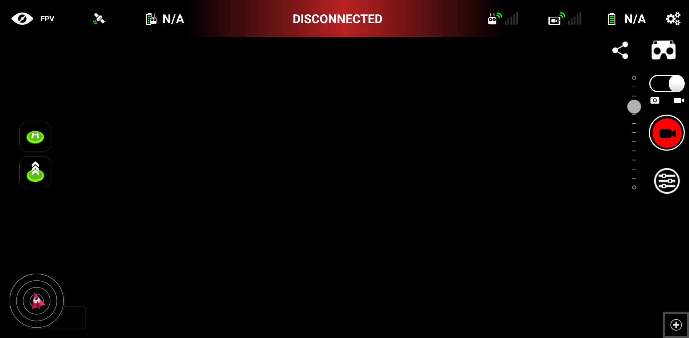

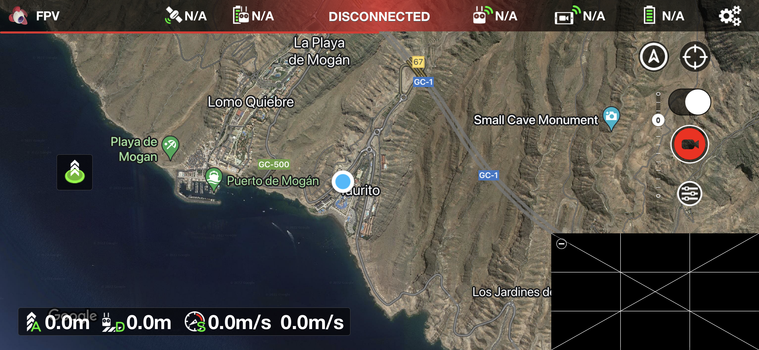

Looks quite a bit different!
Not on my iPhone ?
But, on iOS, you can’t do this …
:wink:
