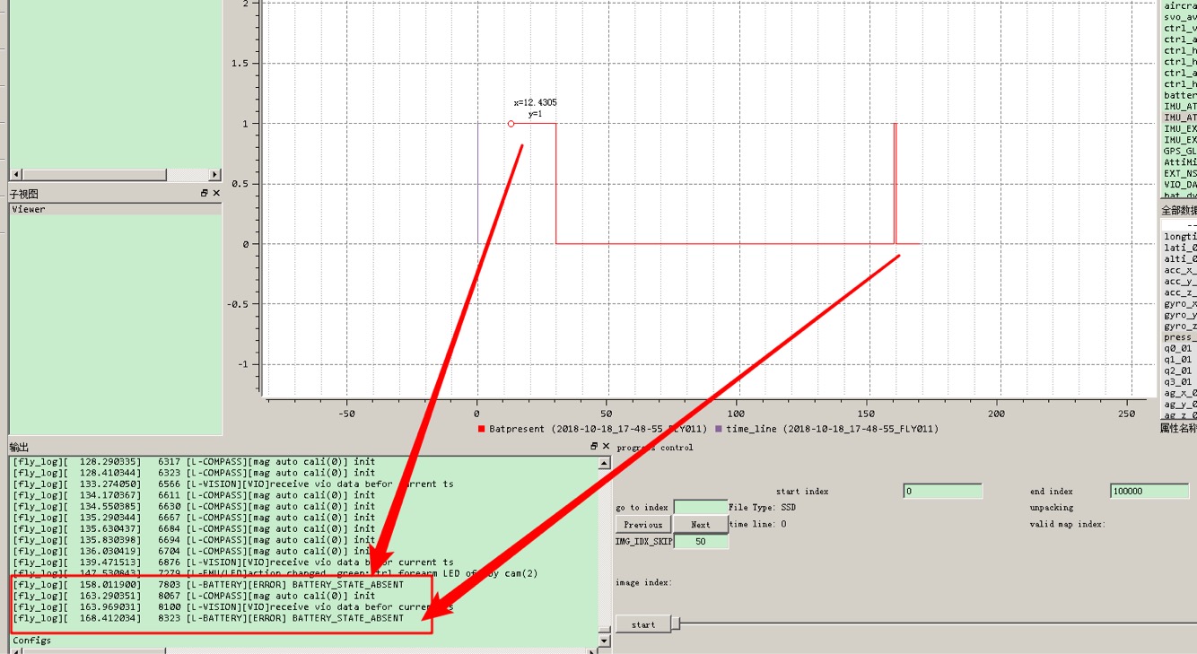

Image with email from DJI
Hmmm - that’s intresting - it’s kind of what I’ve found - but now I know the parameter name to look for “Batpresent”.
Was in the middle of a loooooong spiel … now I need to do more checking, LOL
What does this tell you? Sudden loss of power? What does battery state absent mean?
Batpresent, seems to be new, I don’t think that was on older AC.
It’s binary 1 or 0. I wonder what the conditions are for it.
Maybe monitoring the balance terminals on battery?
DatCon didn’t list it.
They’ve played about with stuff on the M2P. Even KML aren’t being correctly created from Dat Con.

I’m pretty sure it’s EXTREMELY obvious if the battery isn’t seated before takeoff. However… I’ve just tested this scenario on M2Zoom and it is possible to power on the M2Z without the battery fully seated - AND remove it without pressing the buttons on the sides while it’s powered on - It would be quite obvious to you when installing the battery but it looks like it gives DJI significant wriggle-room :frowning:
Mavic 2 Battery Loose Test.MOV (7.8 MB)
Firstly I checked the battery before the flight. Secondly you have to push down on the button to turn the thing on. Thirdly, every thing was fine until a sudden moment when the aircraft was hovering. Why would the battery pop out while hovering?
