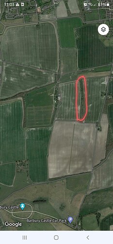

Agreed but the wind at the time could have been strong enough to pick up the drone. Have you checked out that location? You know, just in case.
I would be very tempted to check along this tree line if you haven’t already
As already mentioned …
… and Chris has several times too.
Ah ok I was under the impression you guys were concentrating on this area
My bad. Yup. You had marked the other trees.
Actually. Those trees no longer exist.

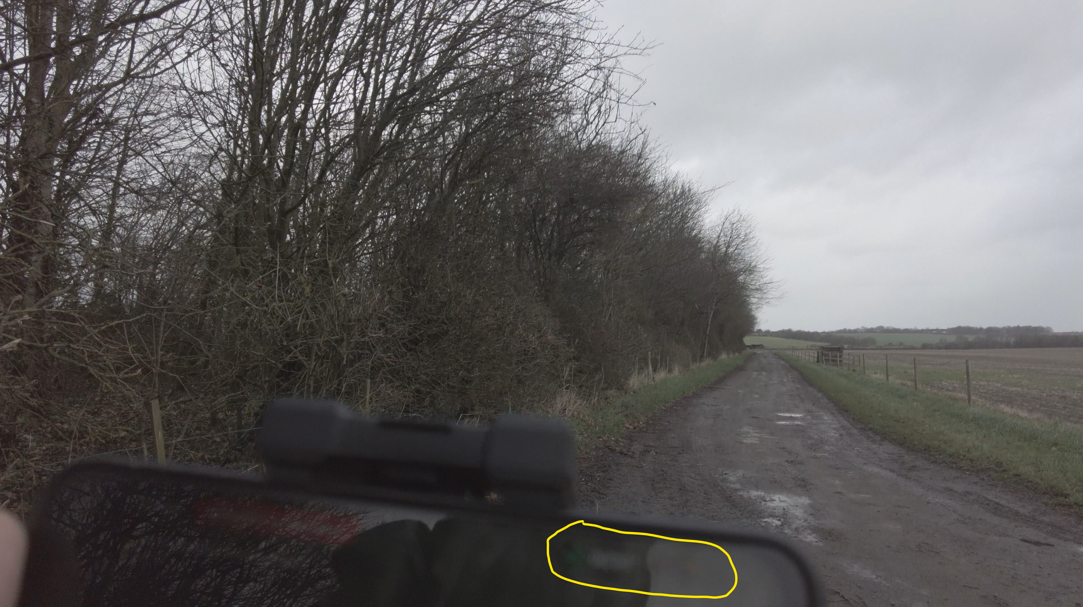

Yes they do. I walked from the T junction following the predicted flight path, to the opposite end of the field. I then did the same but using the M2P. You can see my footprints, and the trees that @SirGunner is referring to.
Same trees, but looking due East from just below the T junction …
The weird thing is that it failed to reconnect when going back to the same spot. I am guessing it could have either fallen from where is was, or the battery died. Also note though that it did not reconnect at all when walking up the West side of the trees (in the field with the cows).
Ah. Indeed … the field looks wider than the satellite image.
Looks even wider on the ground!
But i don’t think you’d have had a reconnect if it had been that far away and in the trees?
