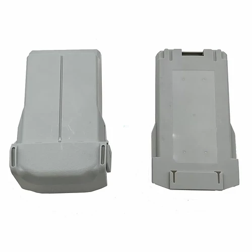

You can buy the shells for these if you ever needed to here’s a link from another thread for the replacement parts, wasn’t sure if you knew as this has been discussed before :+1:t2:
