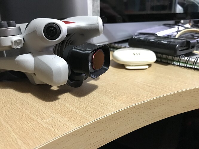

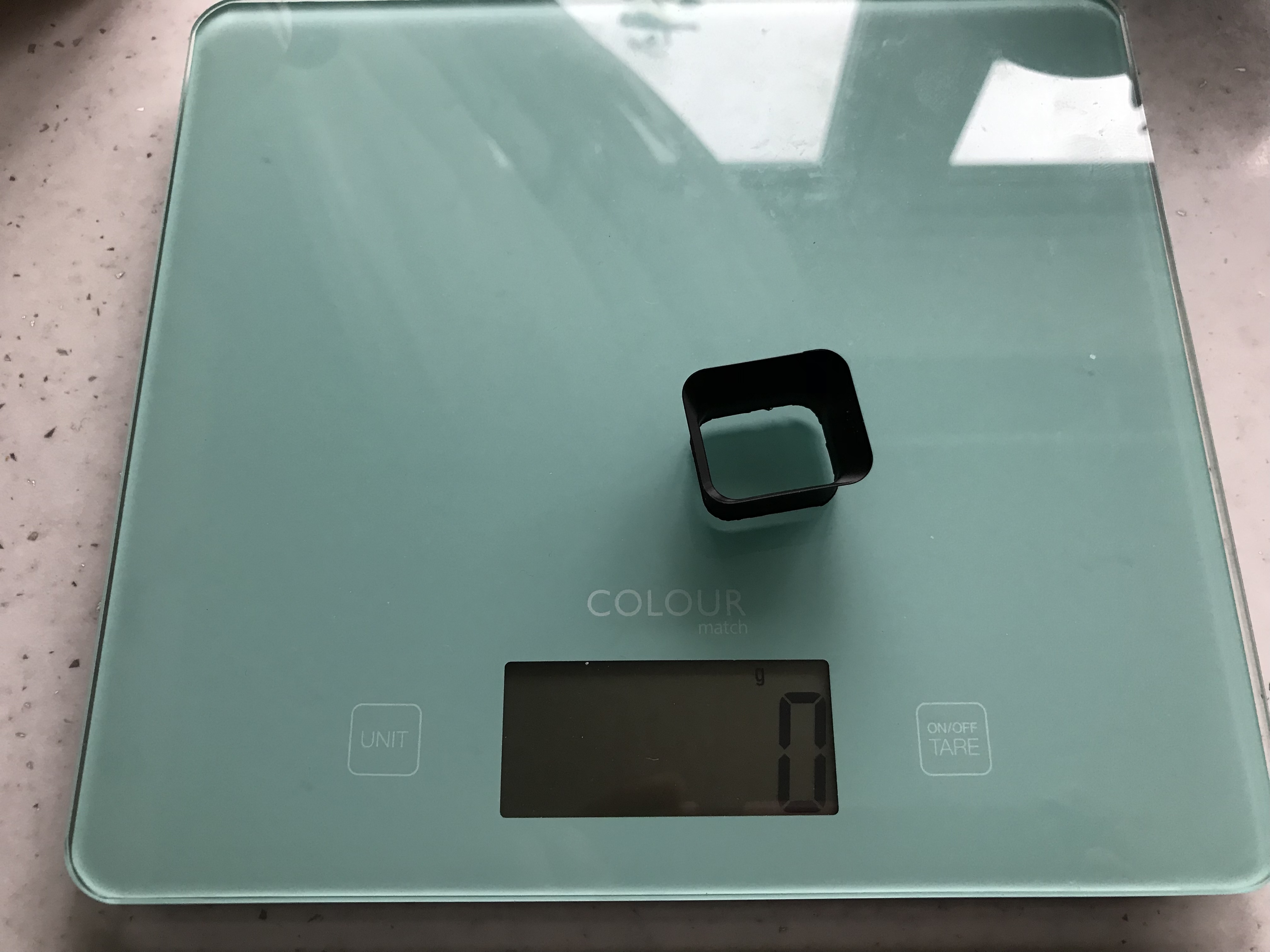

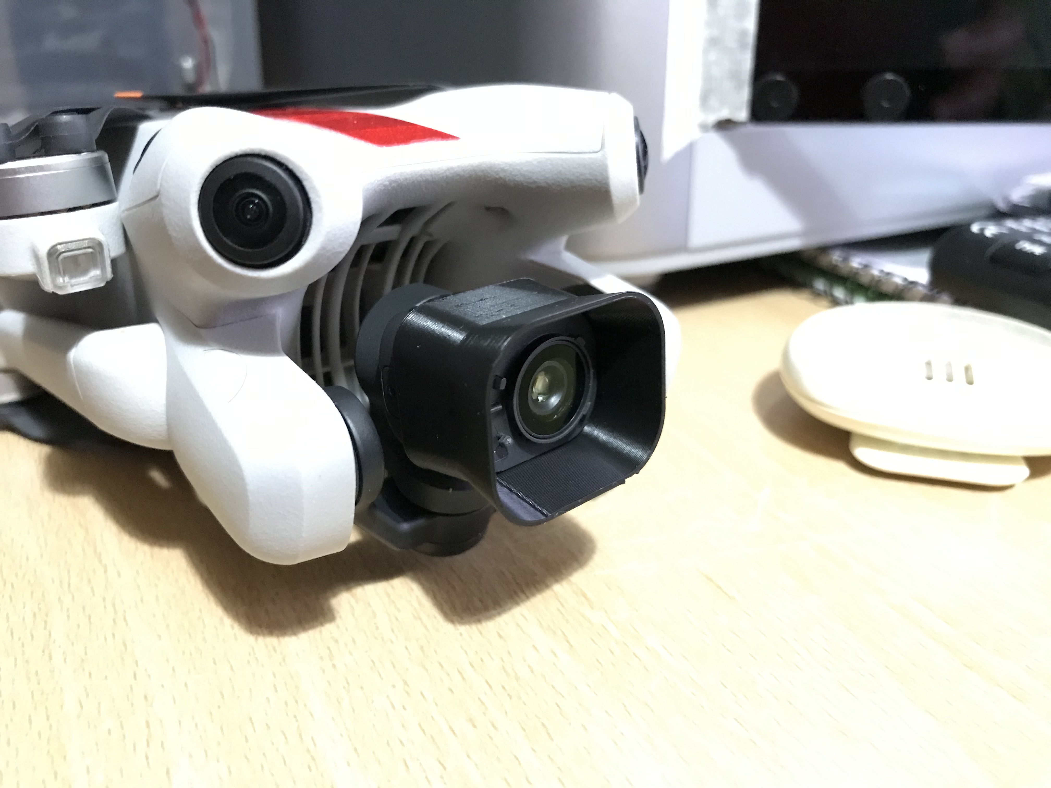

An experiment, not weighed as battery is dead in the scales, the hood isn’t affecting the gimbal calibration startup.
Lens flare in bright sun is a pain with naked ND filters.
These will be tweaked if they are too heavy, the printer returned a 1.07g on the heavier one.
The heavier one looks better suited to the task.
The lighter one has big enough gaps around it to still suffer with lens flare ![]()
Agree, serves to see how much weight I can shed too. I’ll be testing sometime today.

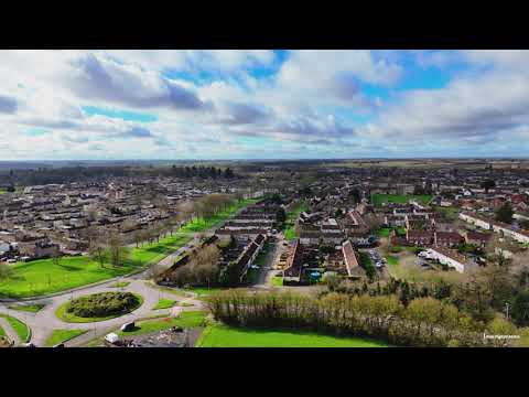

In to the sun with the heavier hood UV glass which always throws glare, I’ll post video later…D-log screen capture, and no added output LUT

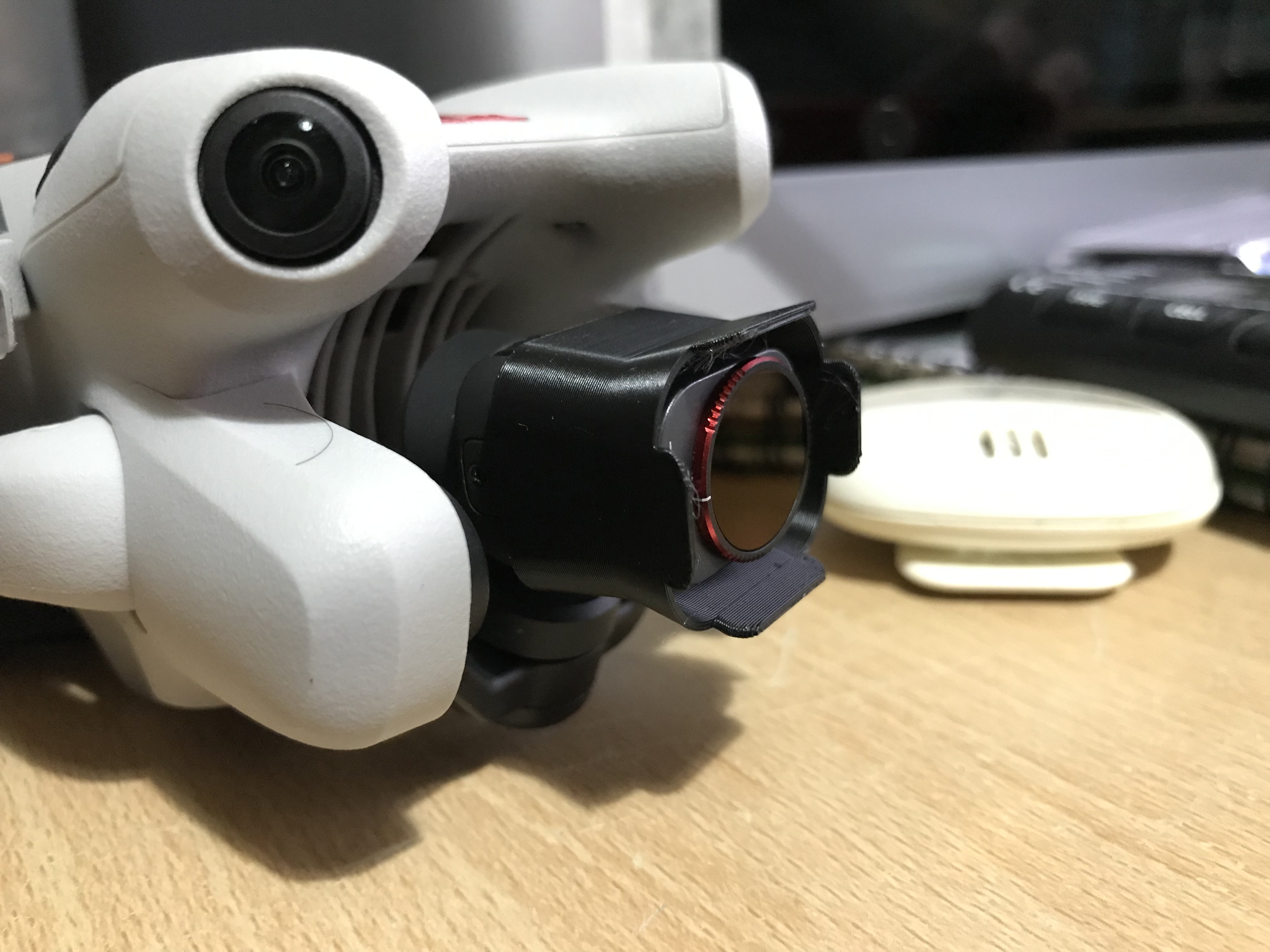

Just off the printer, redesigned to shed weight to 0.91g printer estimate, will see as soon as I get a battery for the scales….

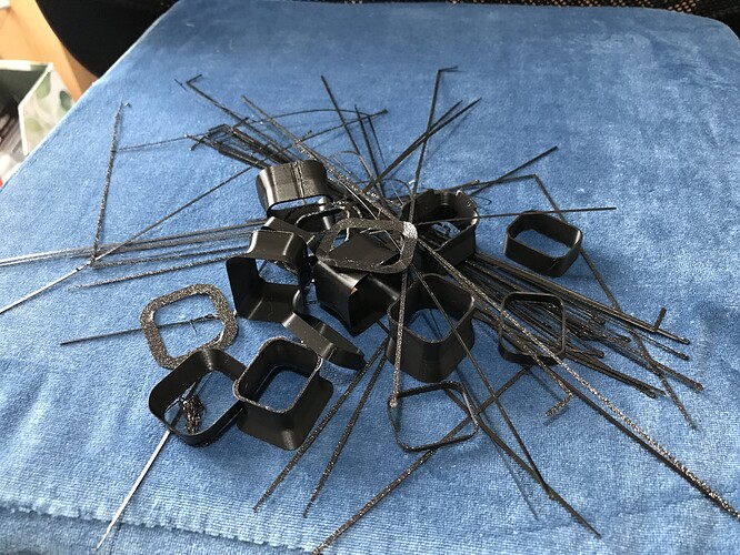

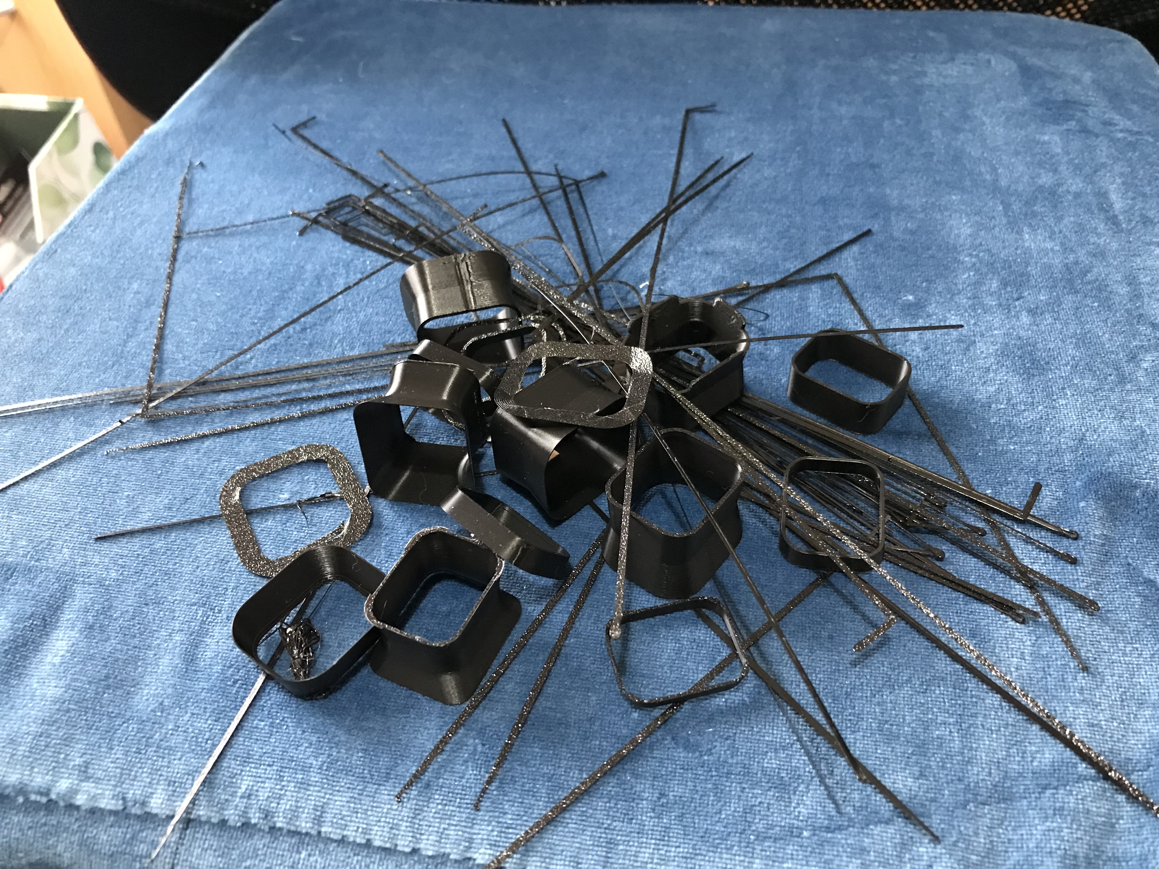

Most of the filament used to bring to fruition this design…![]()
Forgot the time it took…
There’s a potential market for these Lance, you could recover those losses by flogging them for a few quid on eBay ![]()

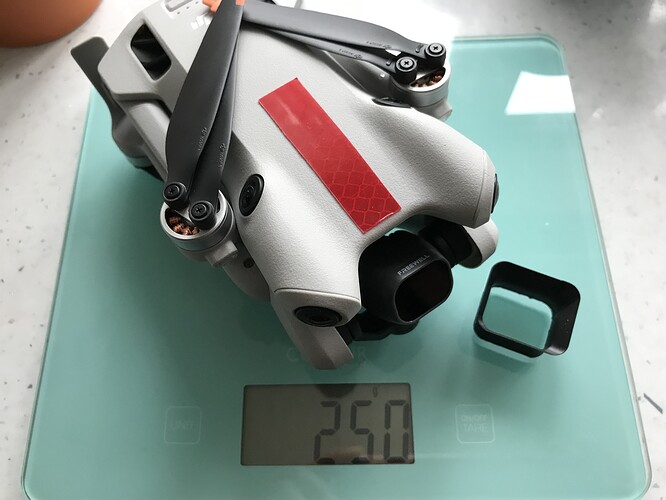

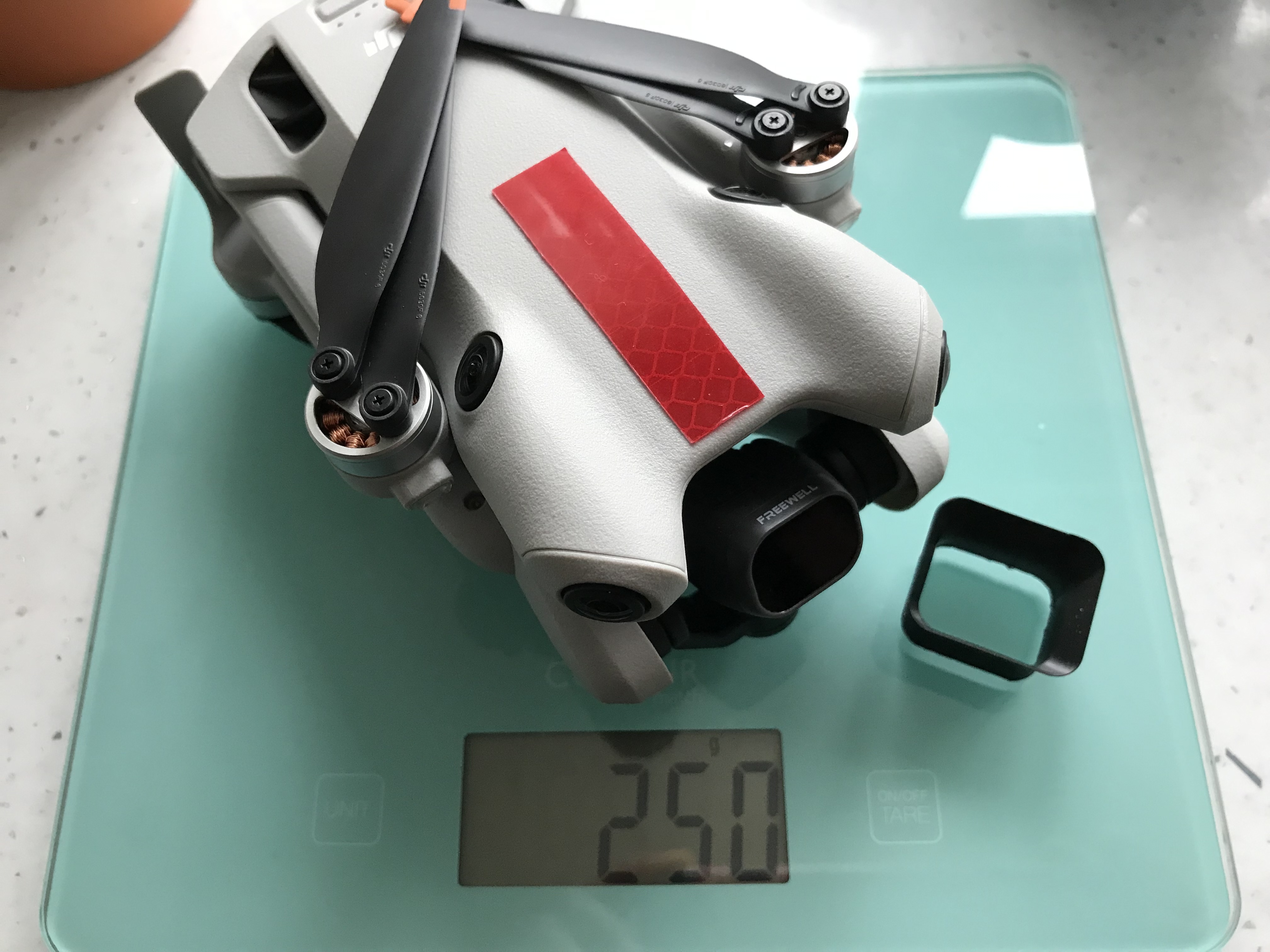

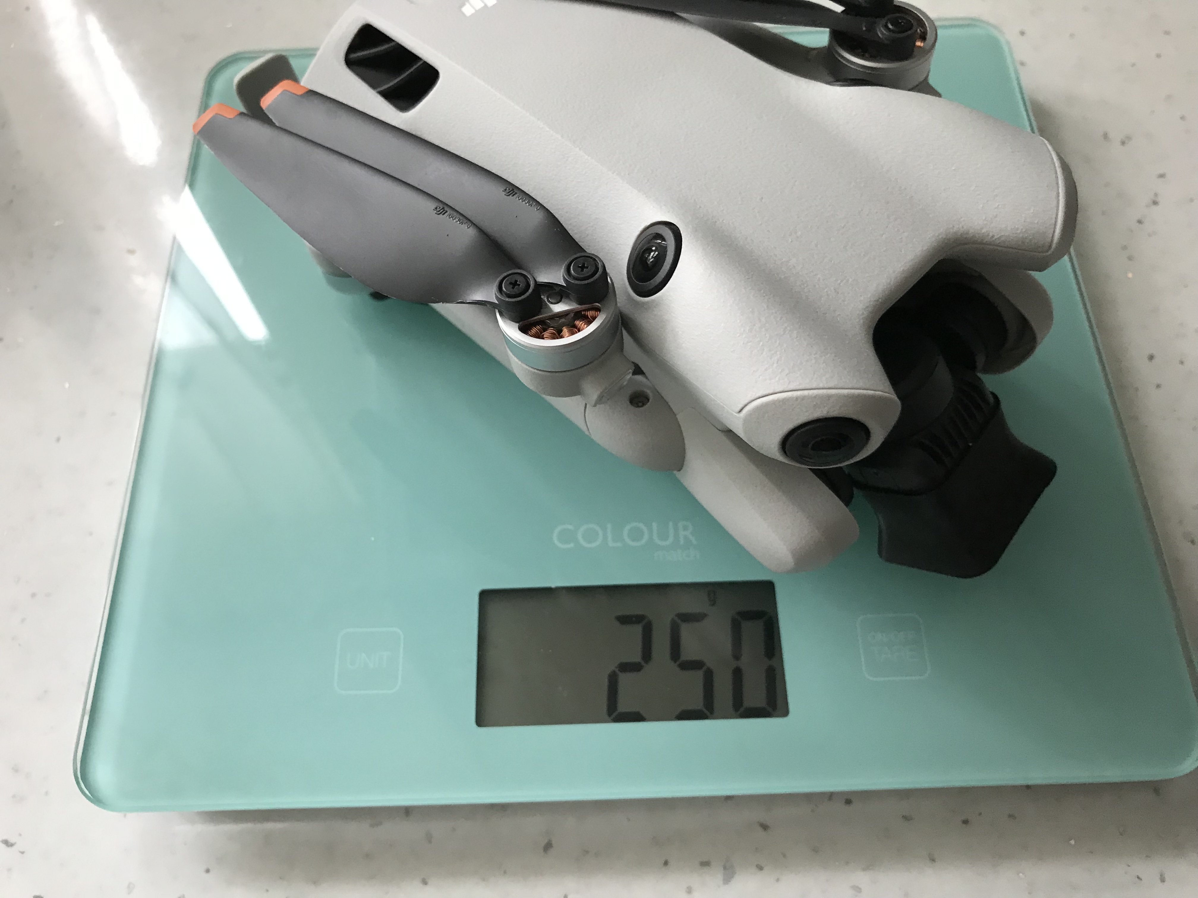

Weighed and has passed QA….![]()
Just realised I need to weigh it with VND filter on which is heavier…
Rid of bird scaring sticker and we’re back in business…
