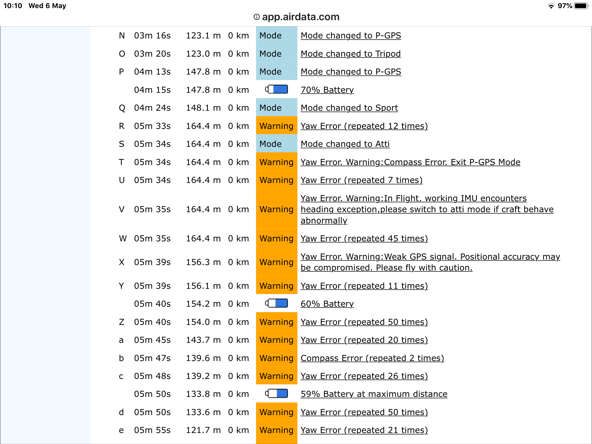

One issue that has been extensively reported with the respect to the Spark is a cascade failure. This is where the operator will be happily scooting about, more often than not in Sport mode. First a Yaw error will be reported. This could be due to the compass/IMU/GPS heading conflicts. Because of the repeated Yaw errors the FC will decide their is an issue with the Compass. Because the compass data has been reported as erroneous the GPS data will be classed as unreliable but reported as “Loss of GPS-Switching to ATTI mode”, when in actuality 12 or more Satellites are still locked. I’ve never been convinced that the Spark actually does a clean switch to ATTI mode in such a scenario, hence when such failures are reported it usually ends in tears. That’s one reason I’ve set my Spark up so I can manually switch to ATTI removing any input from the GPS and Compass.
An example of one of these failures is shown below.
Nidge
