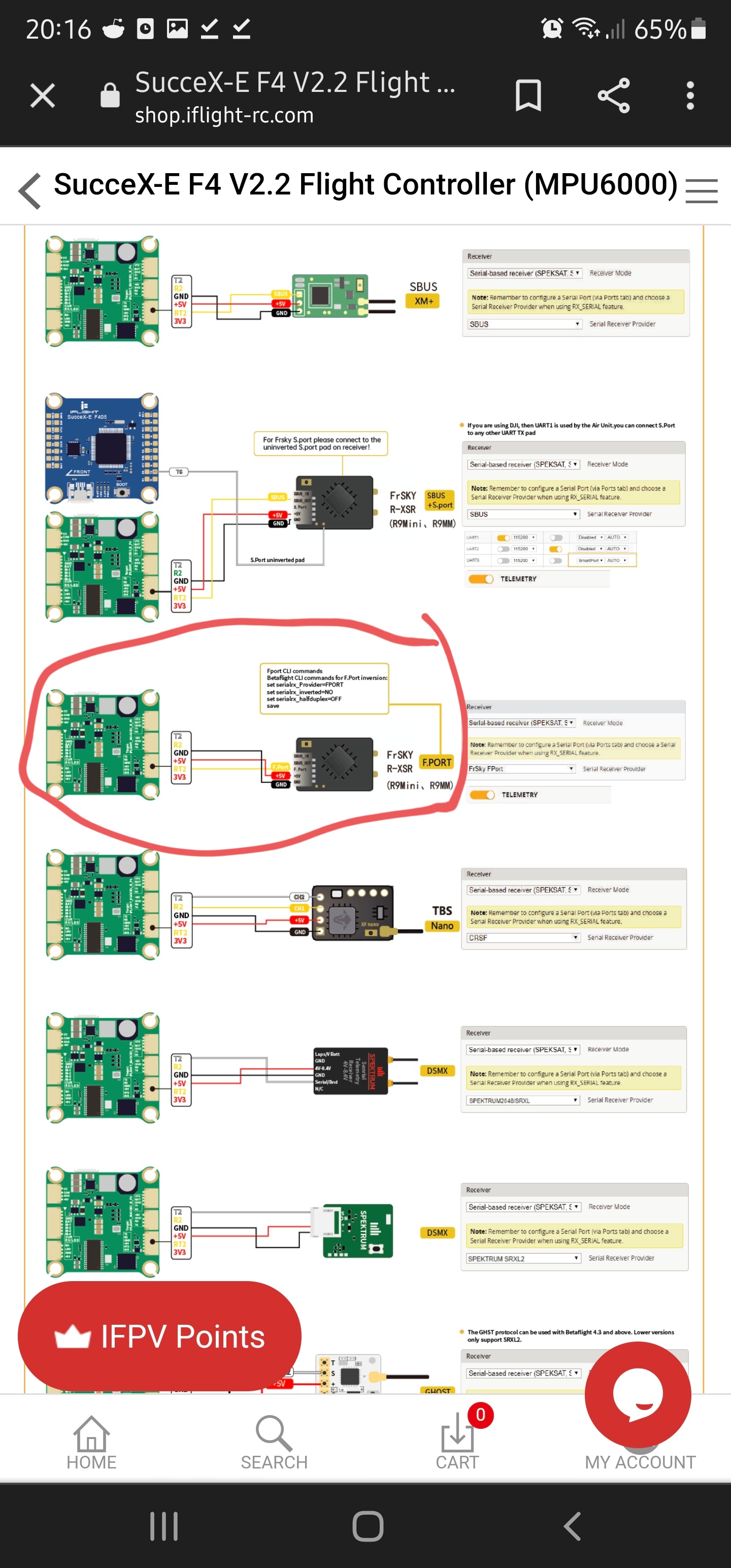

If this is your fc, isn’t the yellow on the wrong pin?

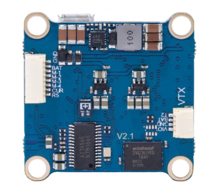

I was going to say, it looks the same as the F4 on my Nazgul V2 and as the FC is mounted “upside down” it looks like the RX may be plugged into the BZ/LED port, according to my diagram. But then that’s for the F4 V2.1 which looks different again from the picture @notveryprettyboy posted that clearly says V2.1 on it.
All rather depends exactly what the FC is. Sorry, ESC?

Thats the esc diagram Jez. The receiver plugs into the flight controller
I’m going to have a guess that the RX isn’t correctly connected to the flight controller.
In this case we’d need to know what Flight Controller is in your drone it will either be the F4 or the F7.
Older Nazguls came with the older F4 board and the newer Nazguls came with the F7. This is important information because the way you connect the RX is different on each board.

this one
