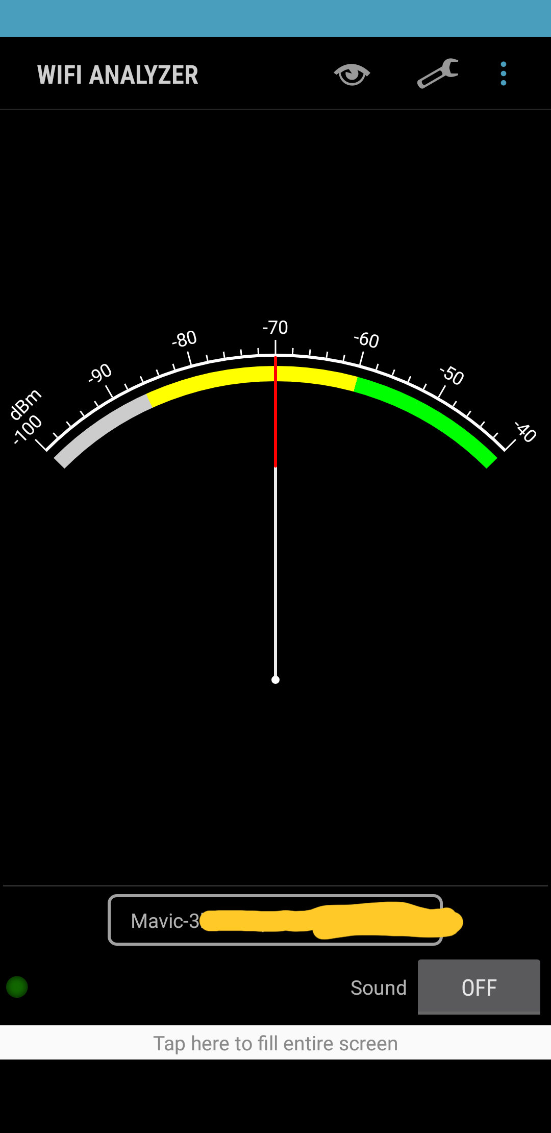

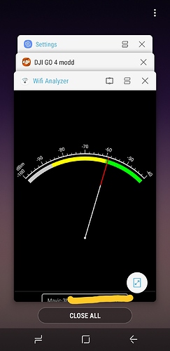

Ok spent an hour on this and managed to confirm that my modded app is switching to FCC mode!
There’s an assumption here and that’s that if the WiFi mode is working in FCC so will the RC on occusync. I think thats a fair assumption.
How I confirmed.
Set mavic to WIFI mode with switch and connected through my phone.
Used a WiFi analyser app to check 5ghz signal strength at a set distance from mavic (downstairs in a corner).
Started original GO4 and again checked 5ghz signal. Same as before. Noted that 12 channels available in app 1-12.
Powered everything down and cleared all apps from memory.
This time I did the same with modded app but would not connect. I had to start and close original app first then it connected.
Noted that 13 channels available but proof is that signal is 10dBm higher in same location.
Repeated this to confirm and consistently at least 10dBm higher every time.
There would probably be a bigger difference if I had did at a further distance.
Good enough proof for me.
