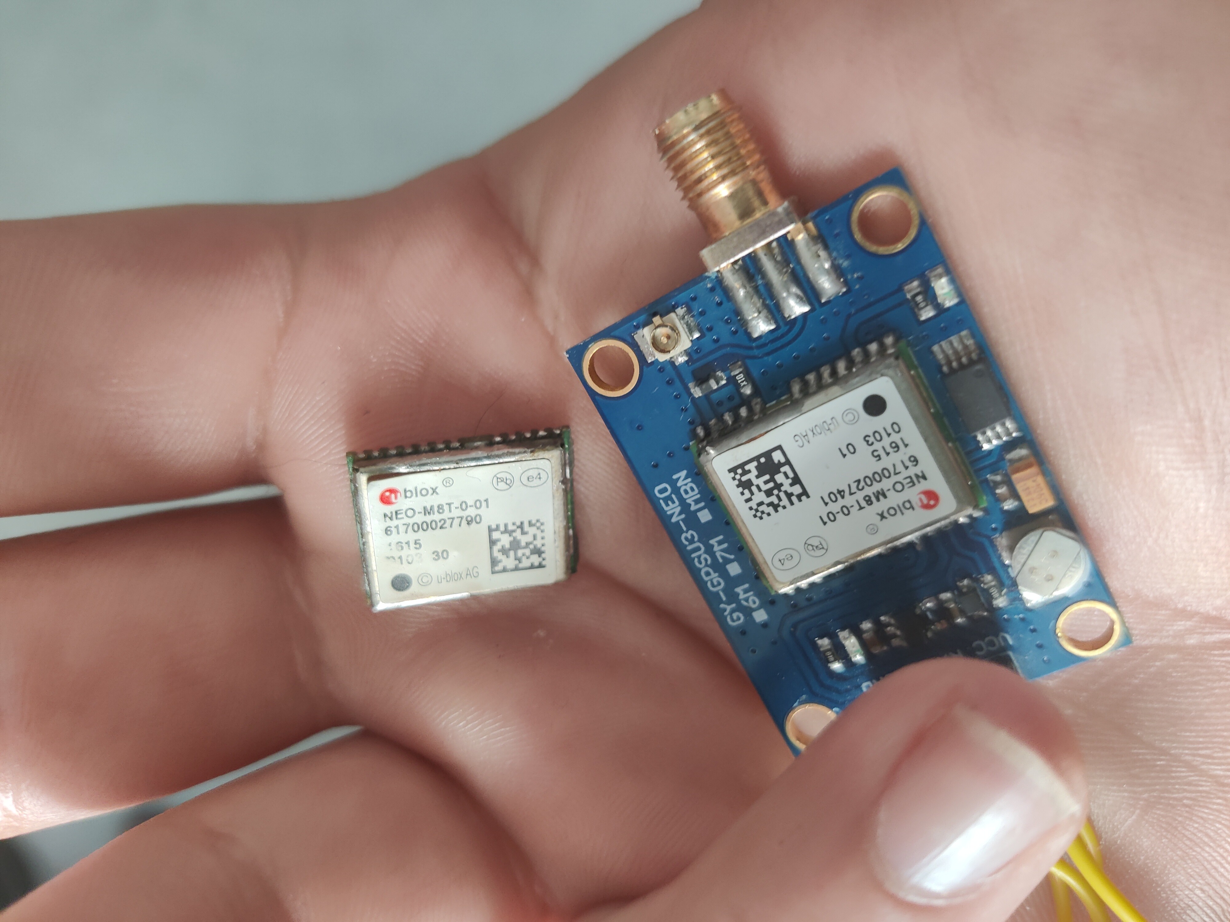

DJI use Ublox chips, and I actually wrote my thesis on how you used to (hard to find ones with the old firmware now) be able to bodge them to do RTK, and I’ve actually got a few RTK Ublox chips sat around.
Had the temptation in the back of my mind to pick up the cheapest old mini or mavic I can find on ebay and see how it behaves if you swap out to a higher tier chip (they share the same package size and pinout), only thing is you’d have to get the radio corrections to it as well
