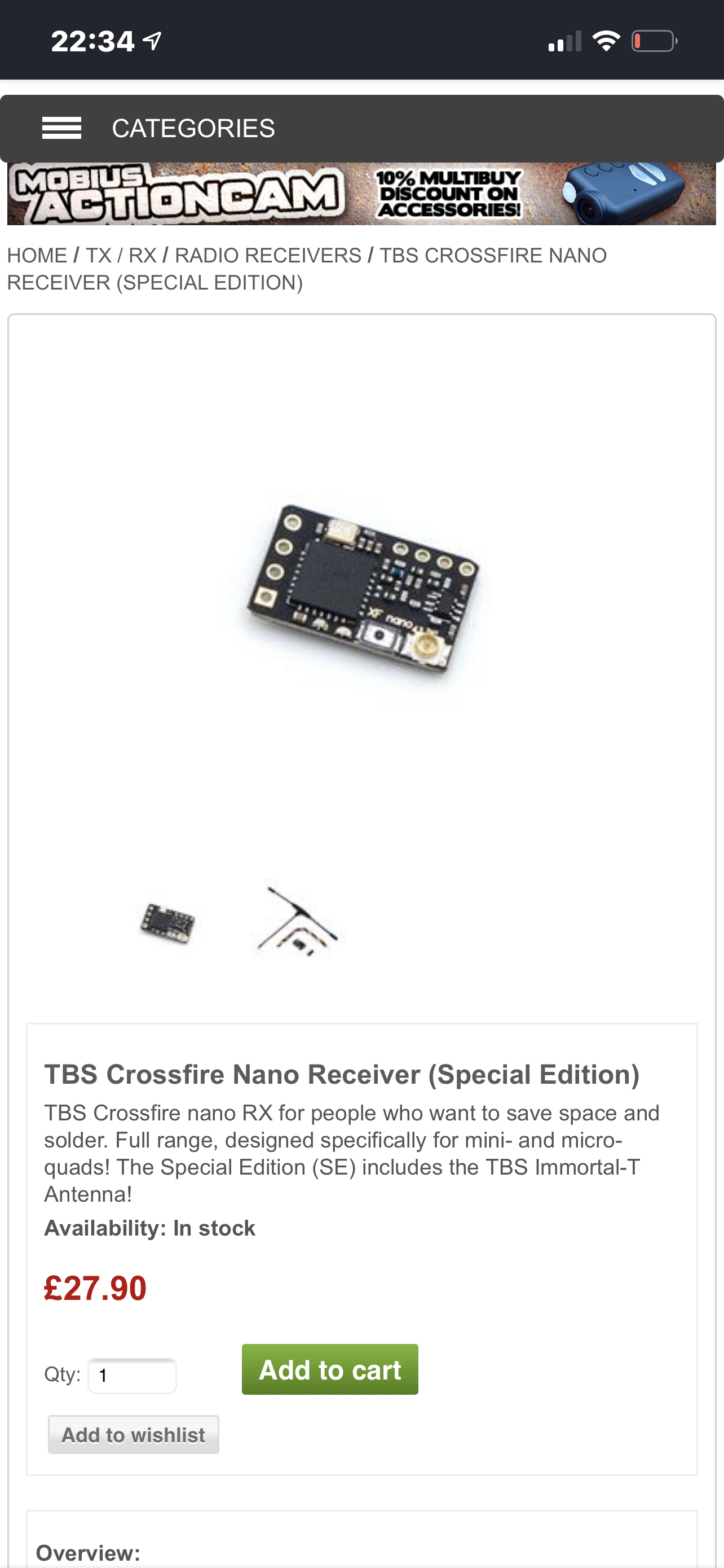

Yes mate they’re the ones. You can also get the nano rx with immortal T antenna as a kit which may save you some money possibly? They also do multi kits of 3 nano rx and 3 immortal T antenna if you have more quads that you want to mod or if you are likely to in the future
This is the thread you should be looking at, it’s all in here
First things first fitting crossfire to the THFS2 is a pain in the ass and I wouldn’t recommend it for your first dip into soldering/building. Crossfire is definitely one of the best control links on the market.
@SirGunner is correct you will need the micro TX V2 crossfire module for the TX16S. And yes you will need a nano RX. But if you buy the SE version you won’t need to buy the Immortal T antenna. And if you are going to fit it to the tinyhawk then you definitely don’t want the Immortal t. Just buy the standard RX and that will come with a whip antenna.
Also @SirGunner is also correct about the kit that was the route I went down you get the Module for the back of the radio and 3x Nano RX 3x Immortal T antennas and 3x Whip antennas. Well worth money even if you don’t have 3 quads to upgrade it’s always nice to have spares
I have been listening @DeanoG60
I didn’t realise the immortal T won’t fit the TH2FS sorry @speatuk but I guess that’s a bonus if you don’t need to buy one
Oh it will fit but it’s just bit big and heavy. The whip antenna is more suited

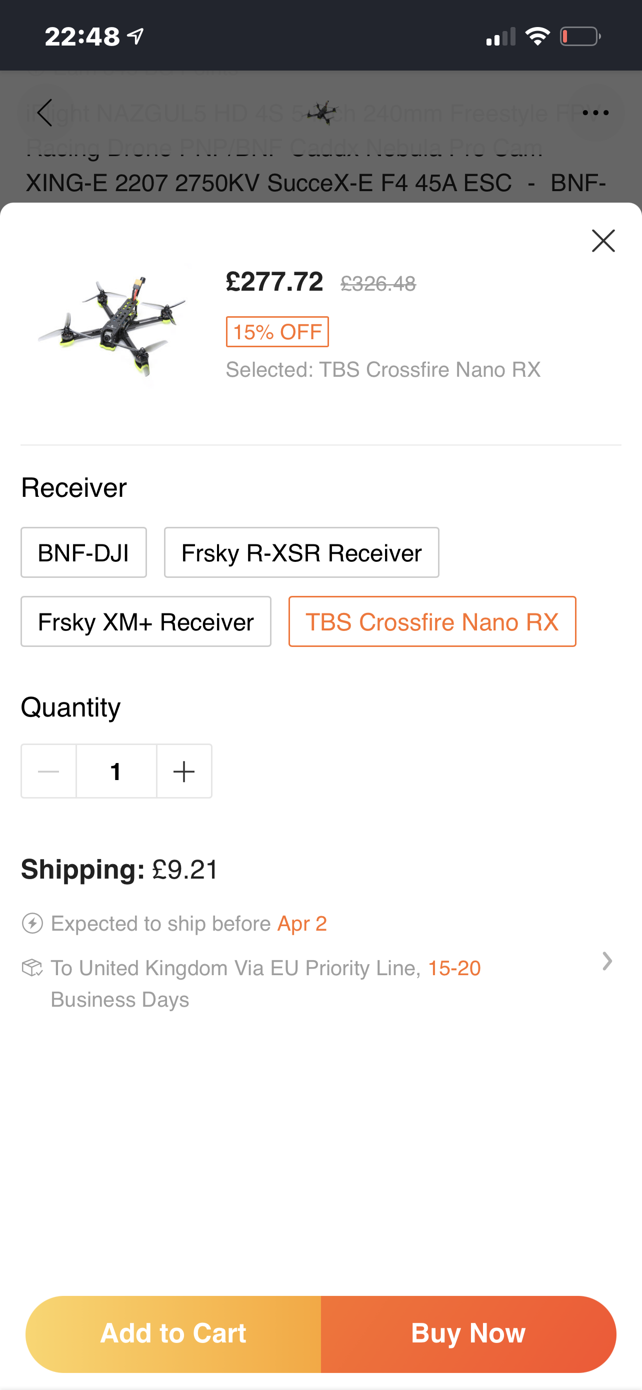

Could get yourself a BNF Nazgul5 V2 with a Crossfire RX
Ohhhhhhh
Didn’t think about one of those. Is it ready made or do you build it
EDIT
I didn’t read it properly it’s BNF
I keep umming and arring about whether to jump straight in with a new build or buy a ready build to start with. I’m really tempted to have a crack at the self build
And this one should work with your DJI goggles
I was just about to say that’s a link to the HD version then remembered Steve has the DJI goggles ![]()
Yeah that’s the one.
