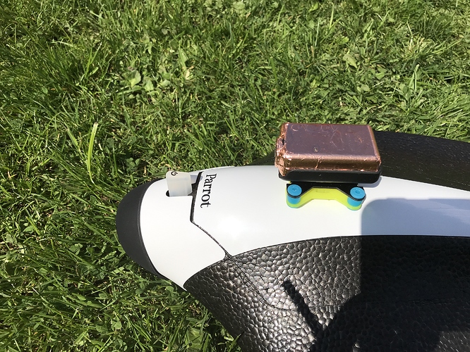

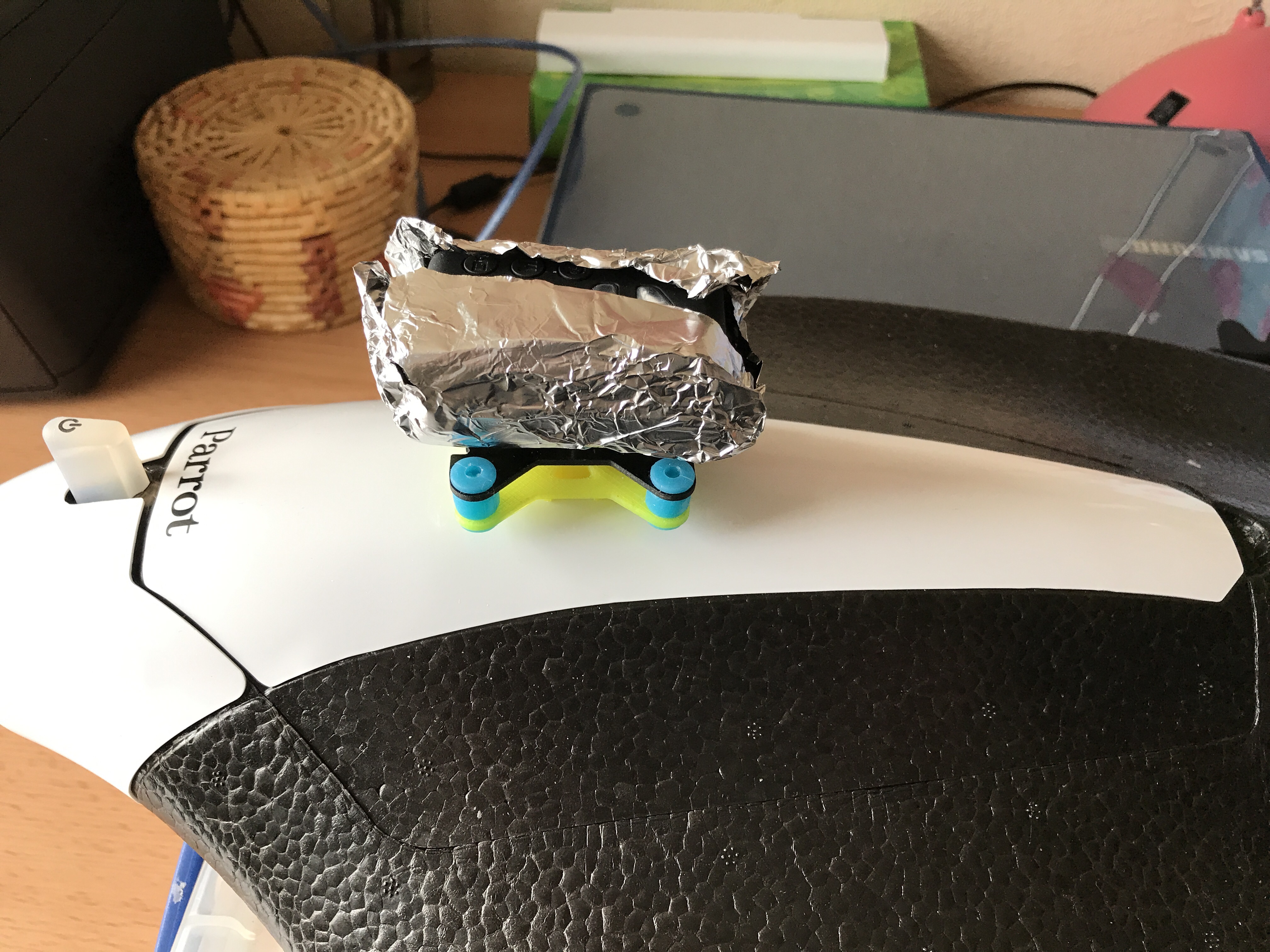

I’ve a bit of an issue with the Mobius camera being too noisy for the Disco GPS antenna at the preferred mounting point.
Here
The foil works well as a RF shield, I’ll be looking at some other solution for the shielding.
What issue were you getting without the tinfoil?
It knocks out the GPS lock when the camera is in recording mode. It’s a known issue with the older Mobius although they improved it a lot. The Disco GPS is just behind the switch so anything giving off RF at that location my impair it’s Function.
