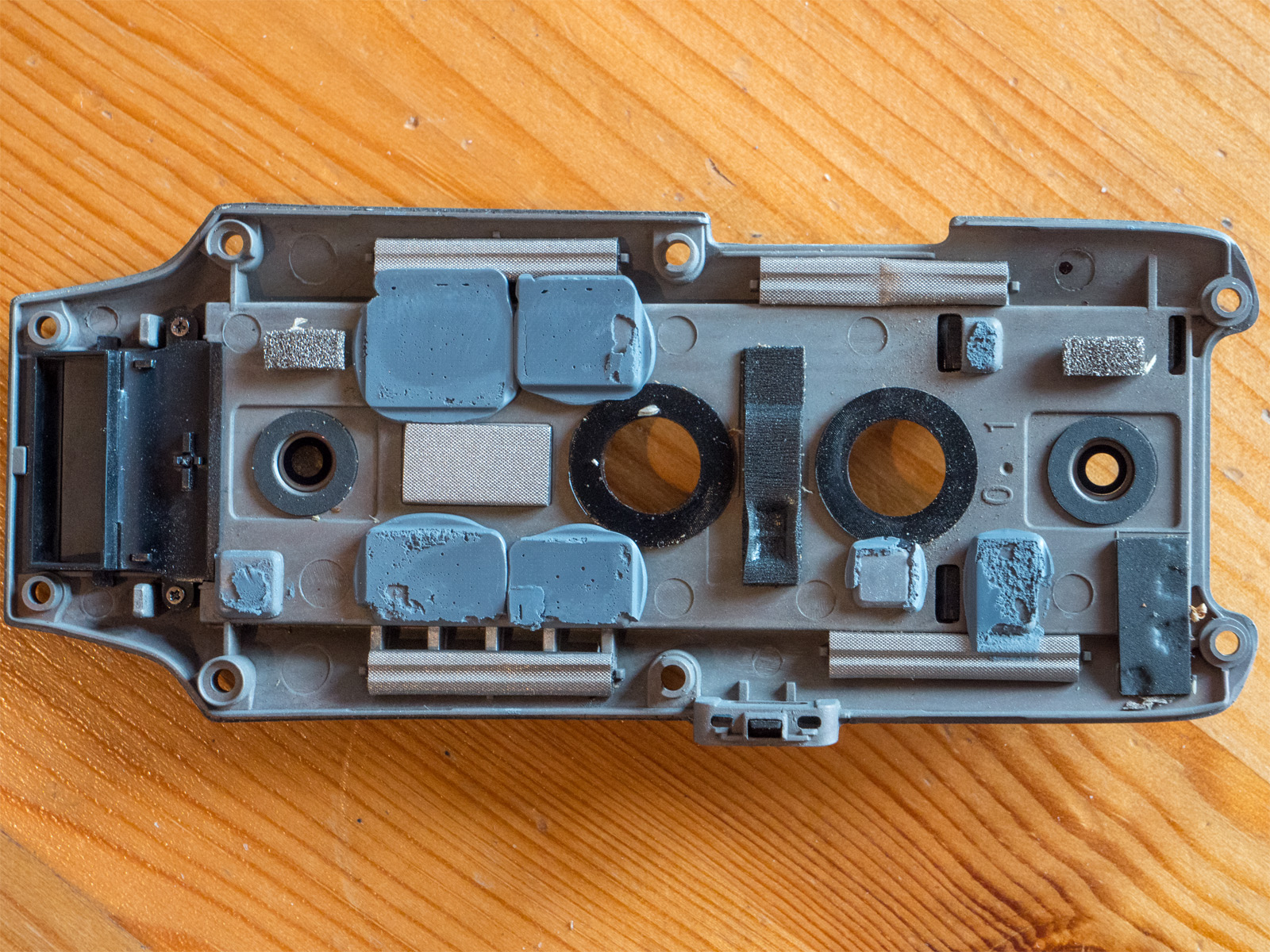

That will be easier than trying to get the skids off. They are on really tight locator pieces that are more likely to break, and one is covered by some screening.
Also - you’ll need to use some thermal compound to ensure heat from the components is properly disipated through the finned base-plate.
This is the stuff you need … quite viscous so it can go in thick.

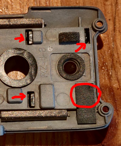

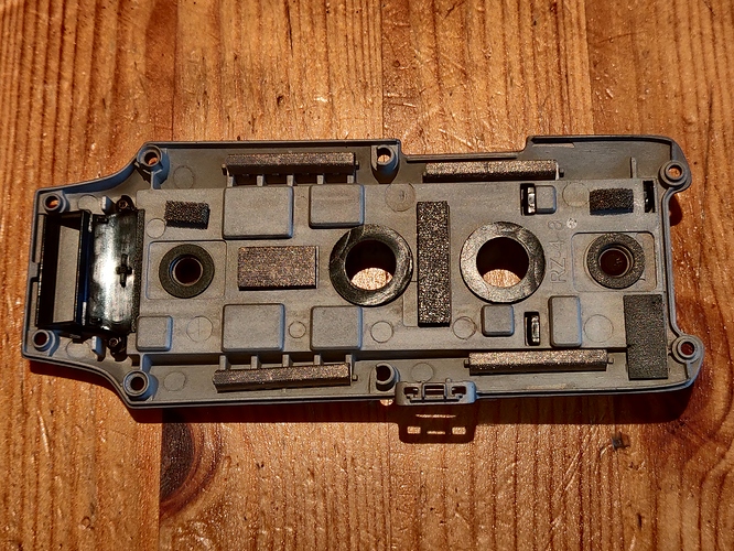

I have a new base-plate here - as per the pic above - I can’t get one off without using more force than I’m prepared to use.
Where they are fitted …
