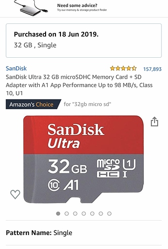

I just bought a Mavic 2 and bought a new SD Card which is 128GB with a transfer rate of 100mb/s. I am getting an error message from the drone saying ‘transfer speed too low, cannot record video at 4K’. What is the minimum transfer speed for 4K video please? Do I need a new card? At what speed?
@Joe The stated transfer speed on most cards is the data “read” rate and the date “write” rate is often not stated but is significantly lower. You need a UHS 3, sometimes called U3 card at least for 4k as this will have a better write speed of min 30MB/s. SanDisk and others have this capability.

From your answers it looks like I need the ‘Extreme’ version?
