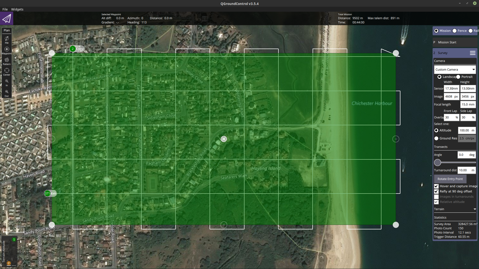

One workaround I have yet to try for real is to use QGroundControl on the desktop - it’s free software designed for PixHawk type controllers.
Set up your mission - it allows you to set area, height, pattern, photo overlap, focal length and sensor size and will then calculate each point where a phot should be taken.
So this is a mission using an Inspire with an X5 using the standard 15mm lens with a 30% overlap and an up and down pattern. Shame the Inspire uses a DJI flight controller and noot a Pixhawk ![]()

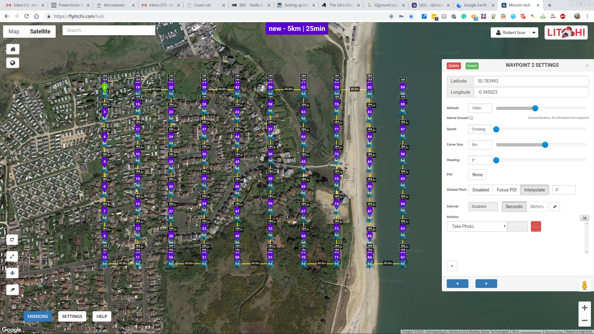

But - if I save the mission as a *.kml file I can view it in Google Earth and, more importantly, import it into the Litchi Mission planner. Tick the box for the take photo at waypoint option and you now have a search pattern with a photo taken at each waypoint. The only thing I’ve not found yet is a means to set default gimbal angle to minus ninety degrees.
I played around with this when I was asked to map a field for a planning protest (no payment offered or sought!) but then found out all that was wanted was a few oblique snaps so I haven’t tried it out for real. But you have converted a QGroundControl mission to Litchi, keeping all the waypoint data, just need to change each waypoint gimbal direction to -90.

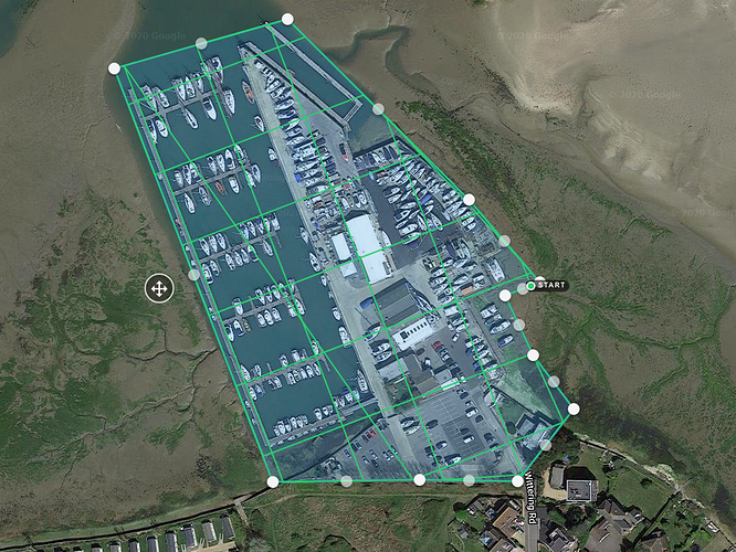

The version of DD I have allows me to plan, much the same as the free QGroundControl:
Unfortunately, when trying to upload the mission this appears:
Which is why I went the QGroundControl planning and import into Litchi route ![]()
You should only get that if you try to upload the images to DD.
