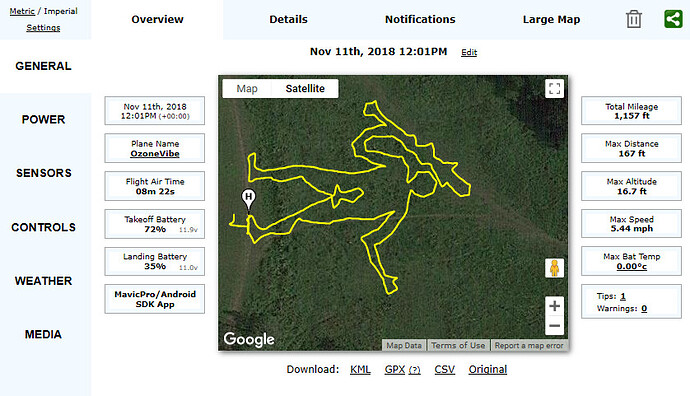

I had quite a few discussions with the Lumecube guy, above, about how he planned them.
Basically, he used 3D software, exported all the points, and wrote software to convert them to the points needed by Litchi. He’d create them at 0°N 0°W, then use Virtual Litchi Mission to relocate the mission to where he wanted to fl and adjust other factors in that.
The mission files on your phone can be opened in a text editor to see the format - and for something like that cube, above, not too(!!!) difficult to do manually - for a few points.
Curves, and shit … that’s another story, and his software needed.
Even getting ground shots of my “vertical” Cerne Giant were a problem.
The size I needed was almost a 10 minute flight … so many points it had to be slow to prevent it looking crap at the points. (Yes - something more simple would be quicker … but I wanted an “erect” Cerne Giant, didn’t I.

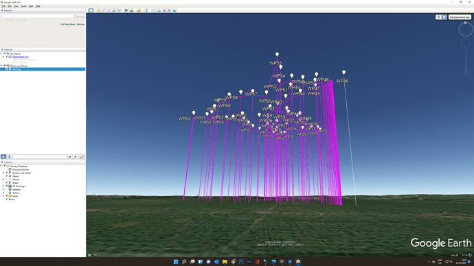

VLM is your friend for this kind of thing … tho power cables and the like aren’t seen.
But the mission can be exported in 3D to Google Earth and rotated as far as 90° to see what it would look like as a horizontal shot, if not far enough to be looking up at it.
Easy enough to do? I see it says export as 3D path… ![]()
From VLM it’s easy, yup.

That was my flat Cerne Giant. Gave up and deleted the attempt(s) at the vertical version(s).

Using VLM, and selecting the CSV option, as above, it’s automatically fires up GE. No “export and load”.
VLM is so useful for 3D/terrain visualising … and the result in GE can generate a virtual fly through of the mission, too. Check out that thread … think most things are in there.

When i try exporting KML
Hmmm, I see what you mean, This looks shocking from the ground
Going to take some serious work.
