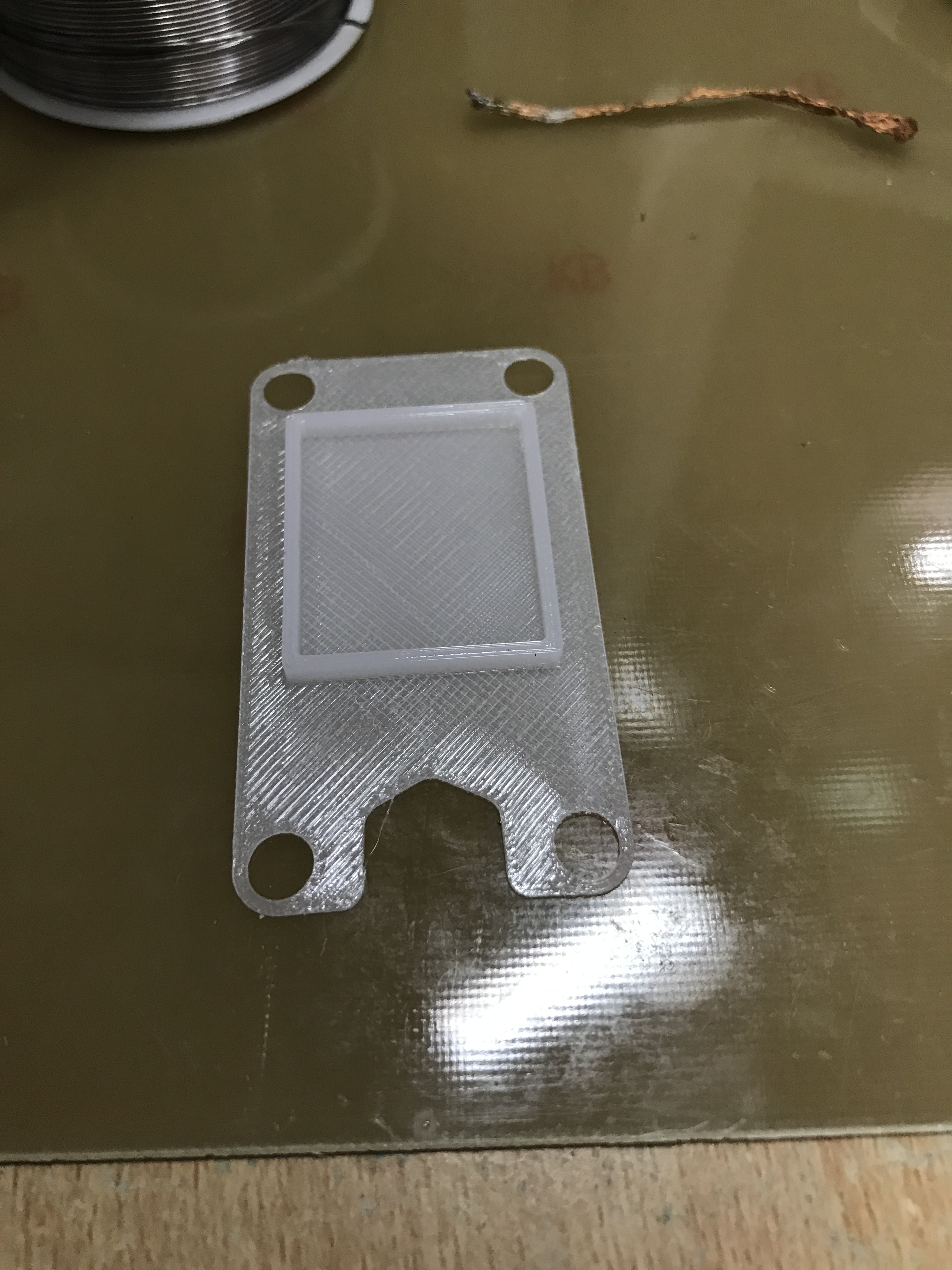

Just gave it a try. Jello has pretty much gone. There’s still a little bit, but hardly noticeable. :+1:

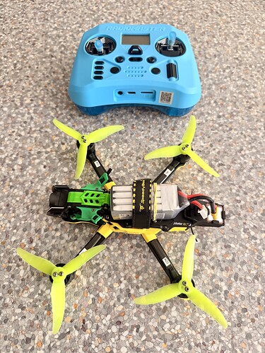

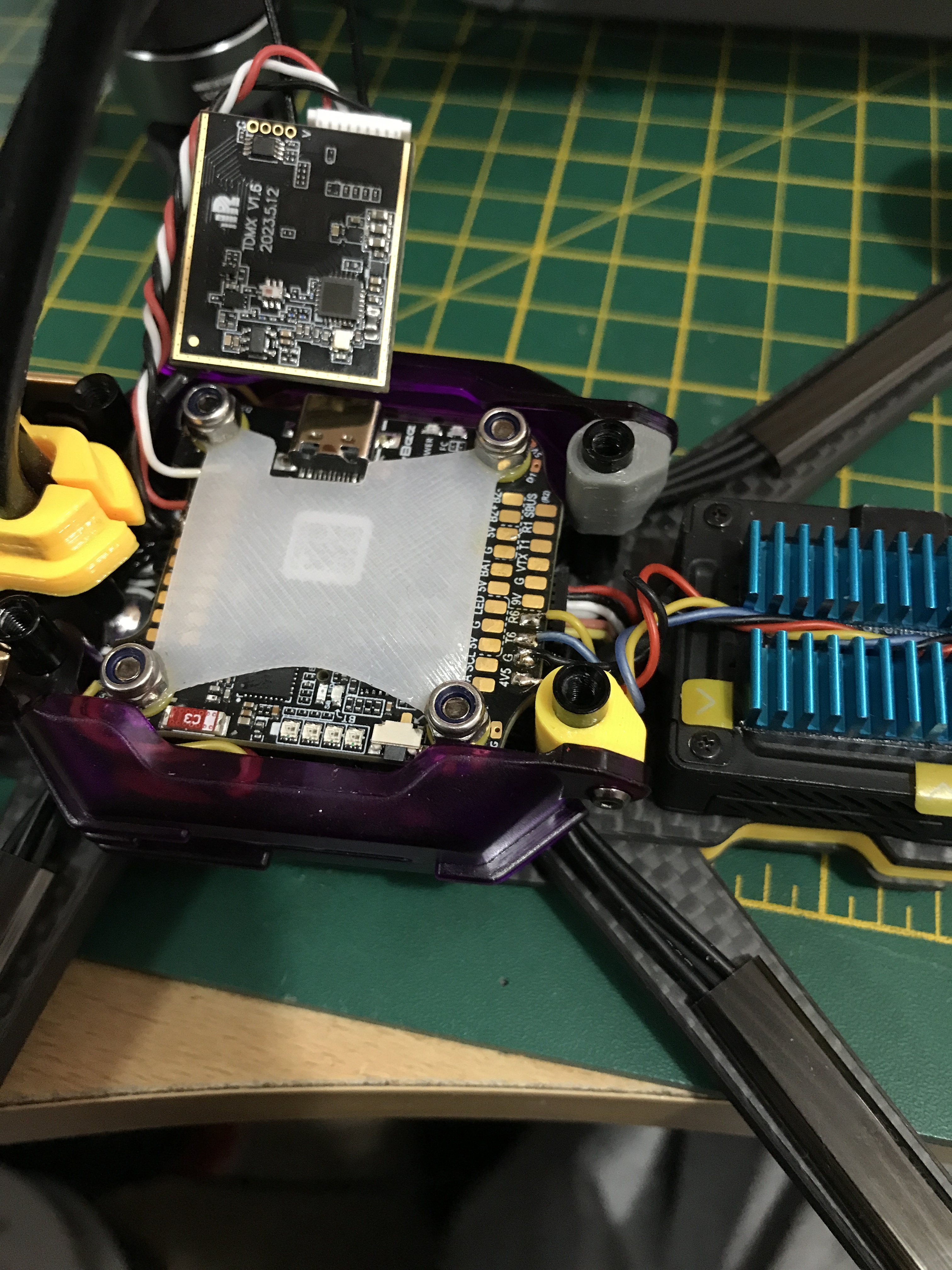

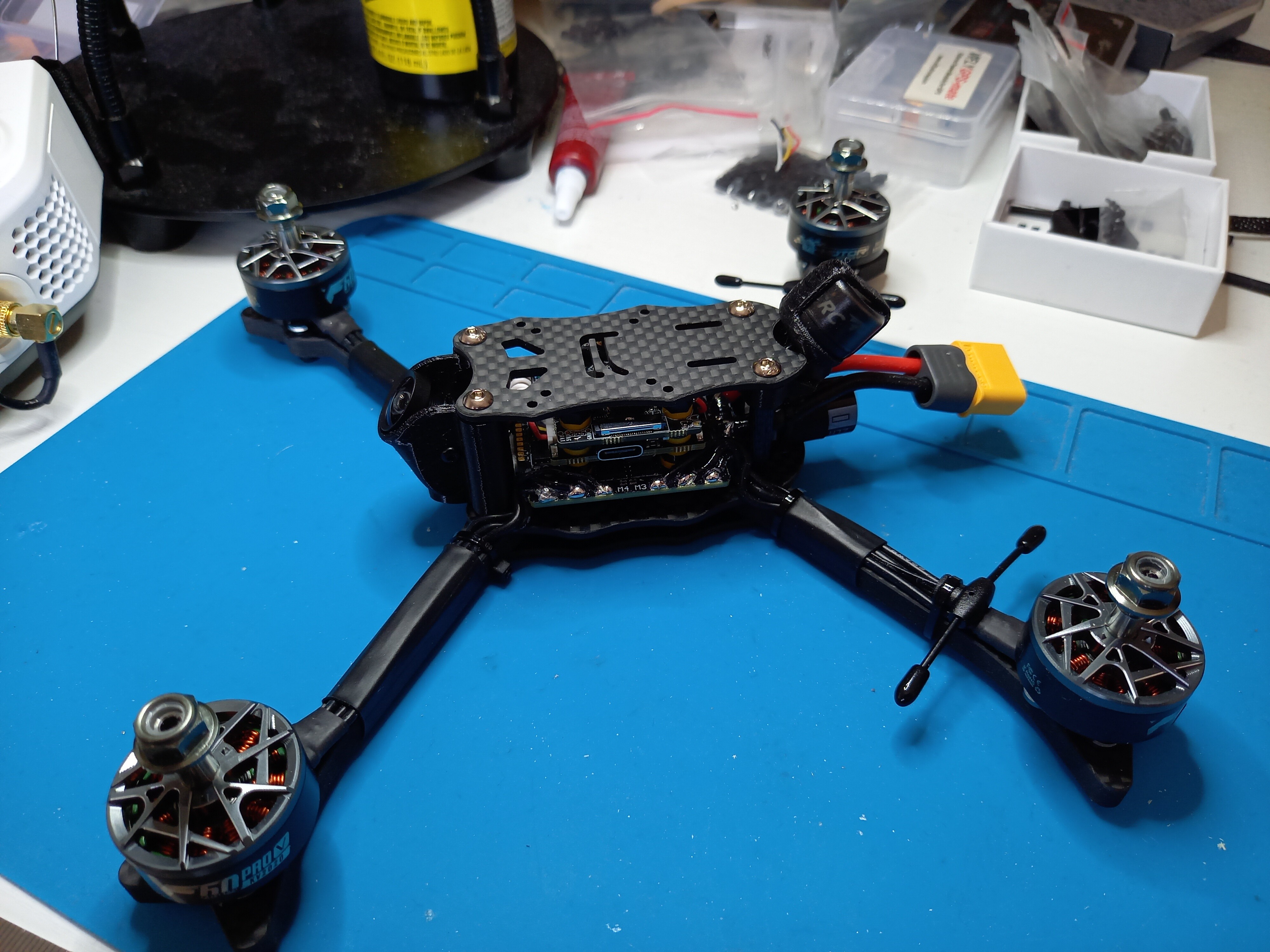

‘Typical’ 5" racing quad
AOS5R frame
T-Motor stack with F60 2020kv motors
HD Zero Race VTX with Nano 90 camera
RP-3 receiver
TrueRC singularity antenna
Beat me to it @Cedric
Not yet configured in BF, I’ll bring it over for your inspection tomorrow…

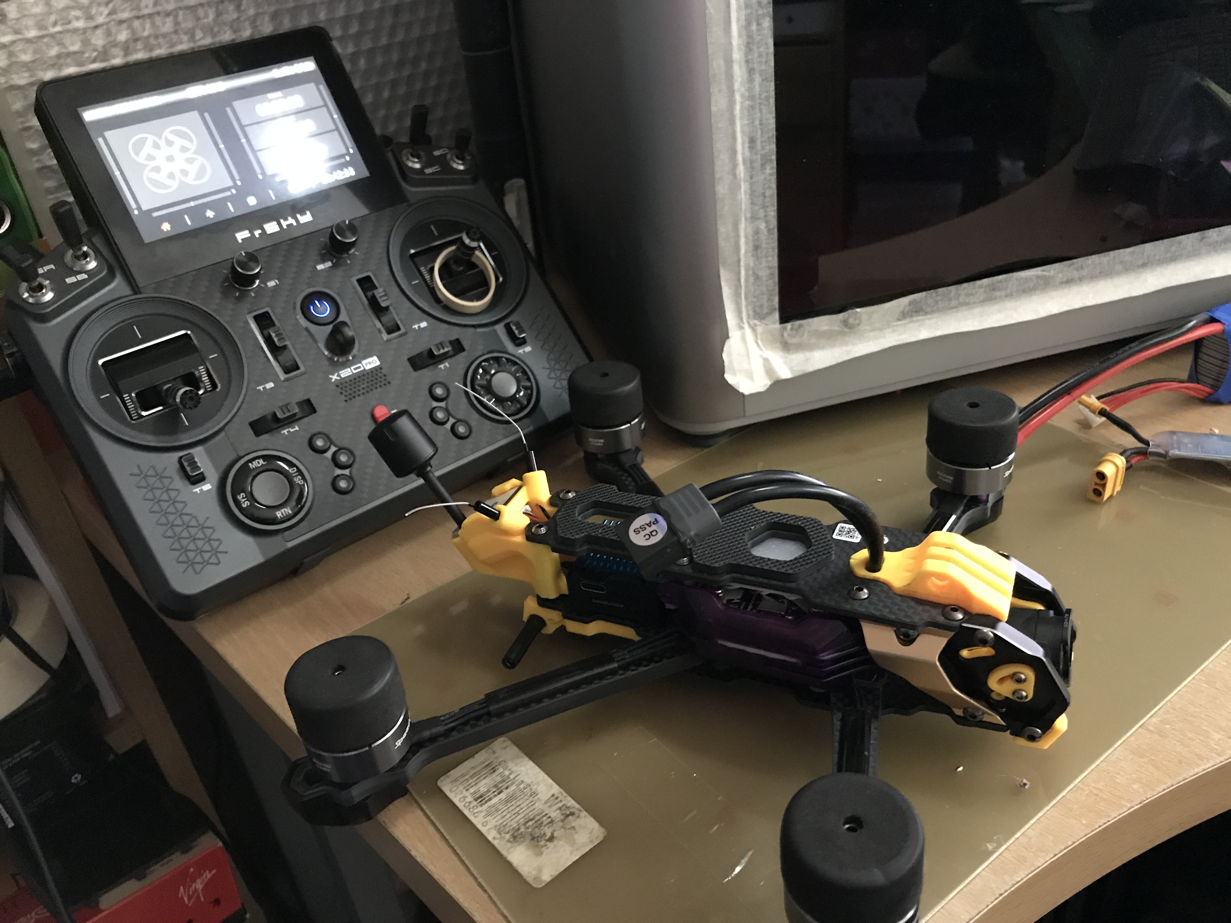

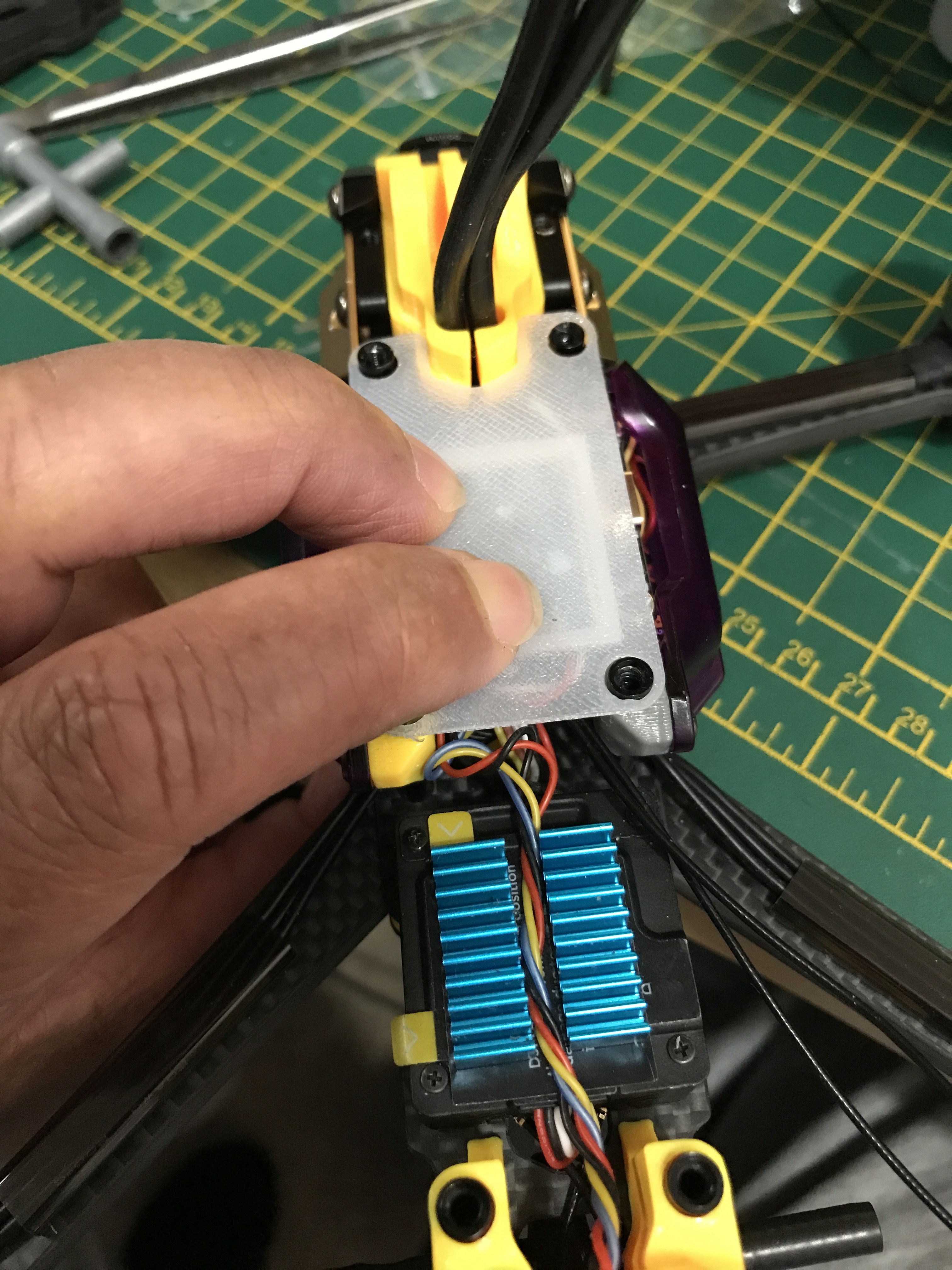

Can I ask,
1- what are those black covers on the motors?
2- have you added extra protection to the receiver antenna (the ones that are sticking out the sides at the rear) - if you have, what have you used?
TIA
They are foam thread protectors while in shipping, handy to leave them on while working on the quad, saves on the constant scratching of fingers and arms too.
No, that’s how they are made, they are Frsky Tween Dual Fequency 2.4 GHz and 900MHz, they work on both frquencies at the same time.

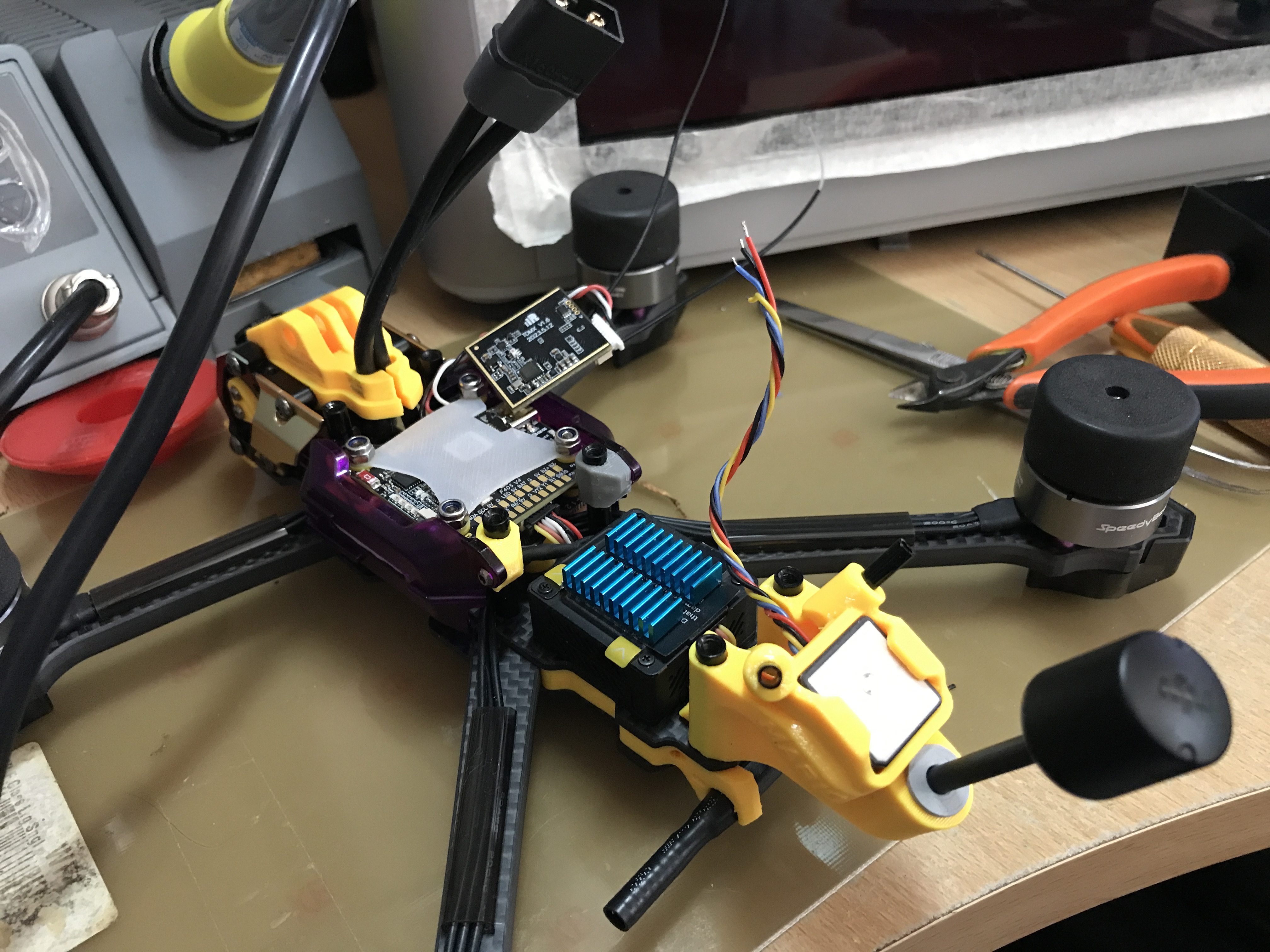

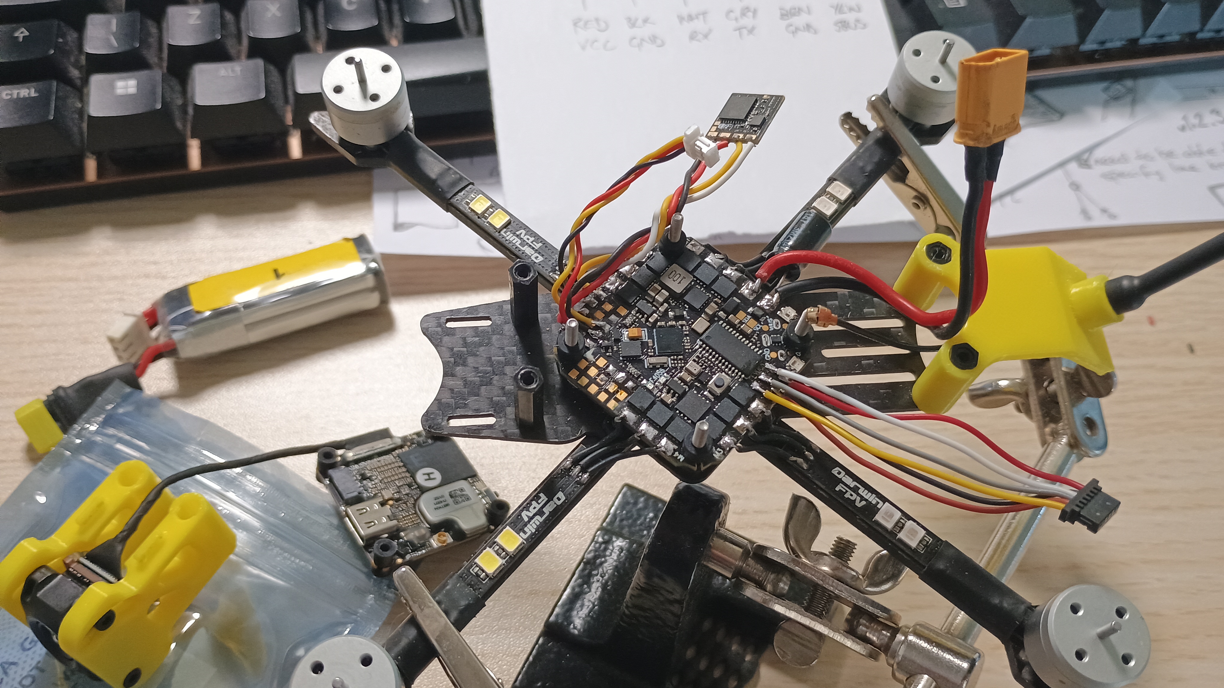

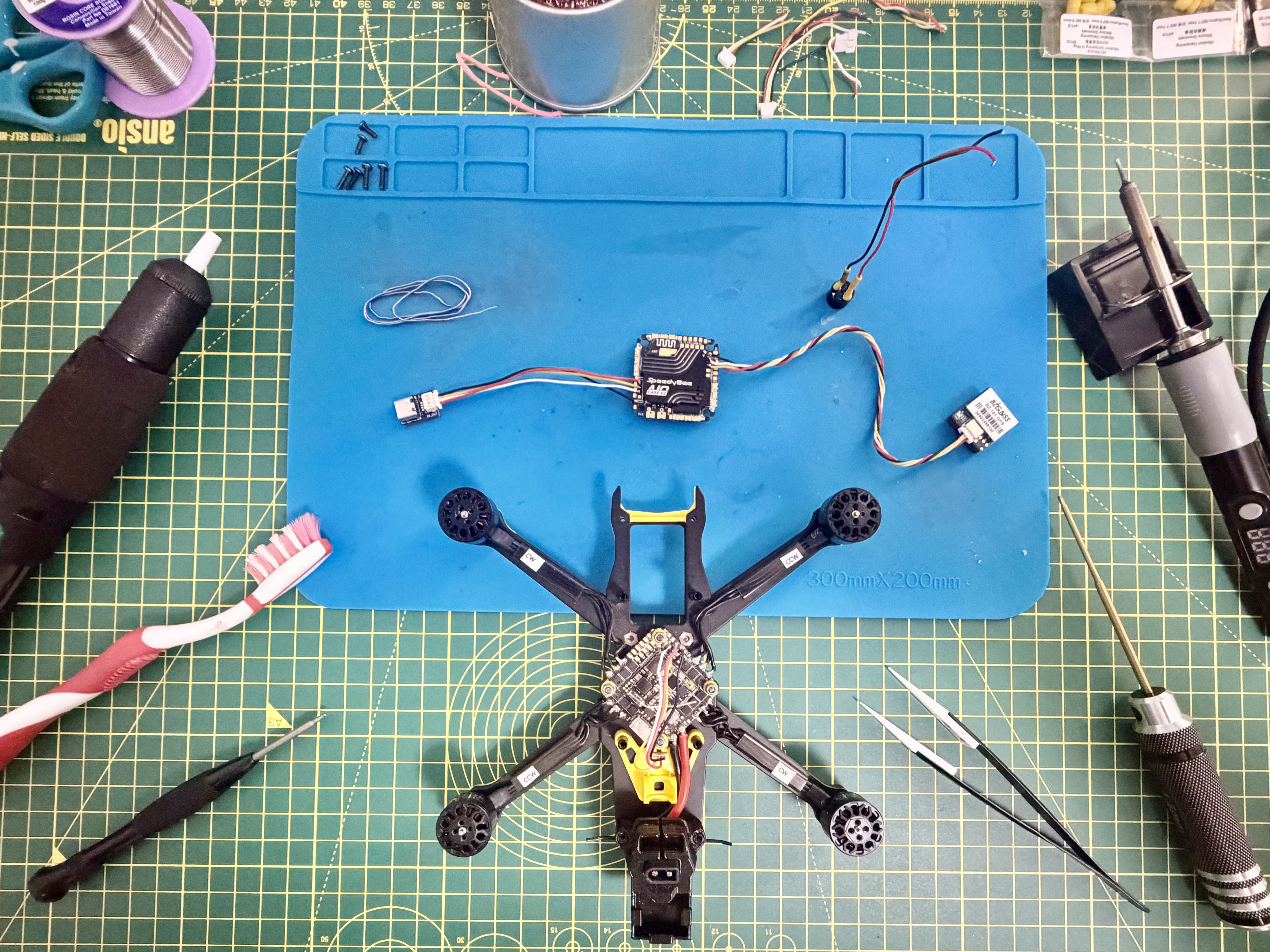

Installing a new Speedybee F405 AIO V2 FC into the 3", that I built last month.
I had transplanted the FC from a previous quad (Speedybee Bee25) into my First Build, however after couple of flights, I show how managed to f-up the ESC’s on that one. :scream:
So progress made thus far this morning :hugs:
Particularly striped the quad :white_check_mark:
Fitted and tested the USB C extension & GPS :white_check_mark:
Buzzer, ELRS receiver & Lipo connectors to install, before unsoldering the motor from old FC and then refitting everything.

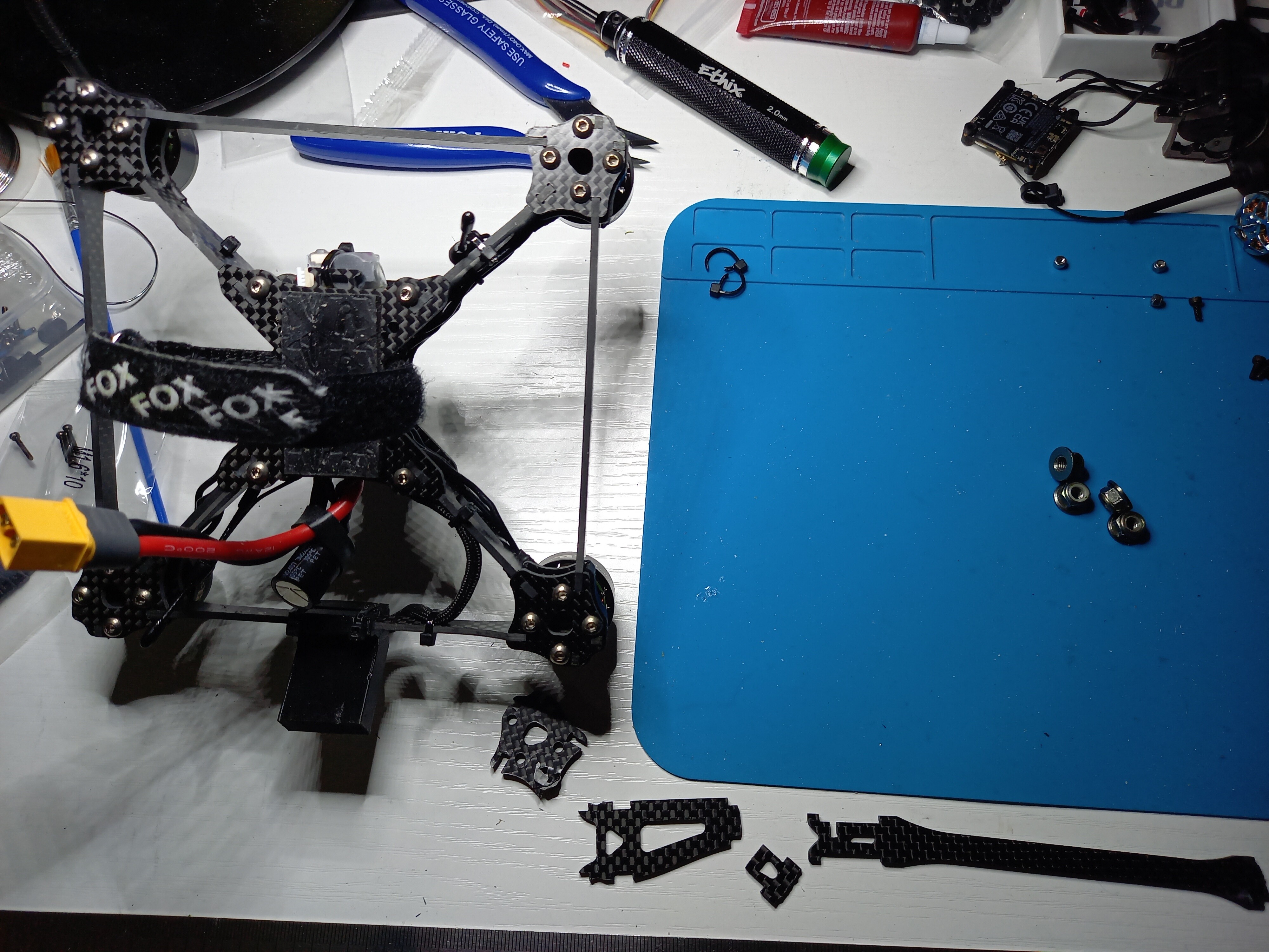

@SparkyFPV is this desktop a little more organised for you? Note - I’ve tried to keep it symmetrical (sorted of) for you. :+1:t2:

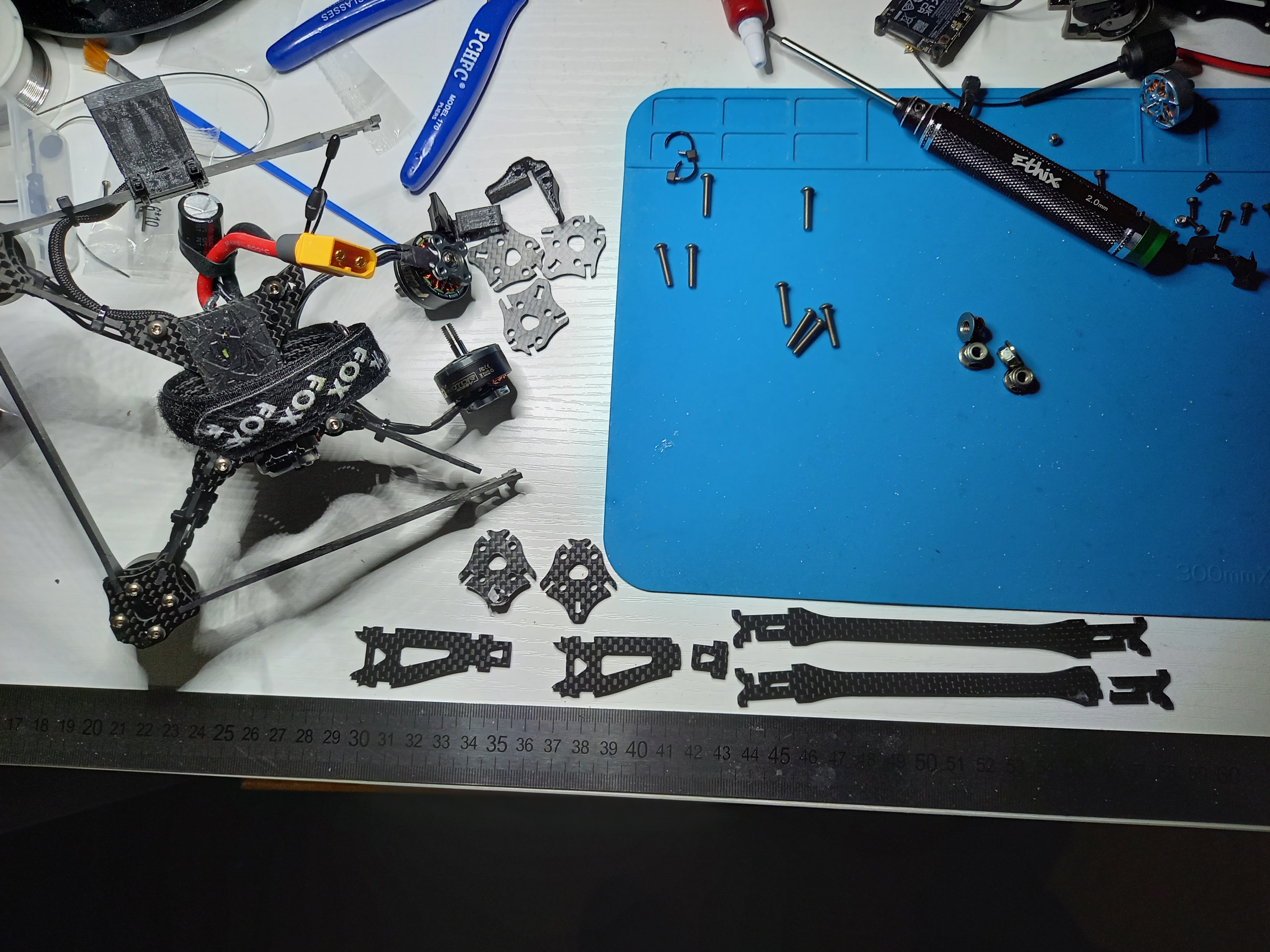

I replaced the broken bits on the Crooked 5 (I bought a second frame as spares at the time - bottom 3 bits of the pic took the beating shown close to the matching replacement part) - took me a whole 15mn and we are back in business :slight_smile:

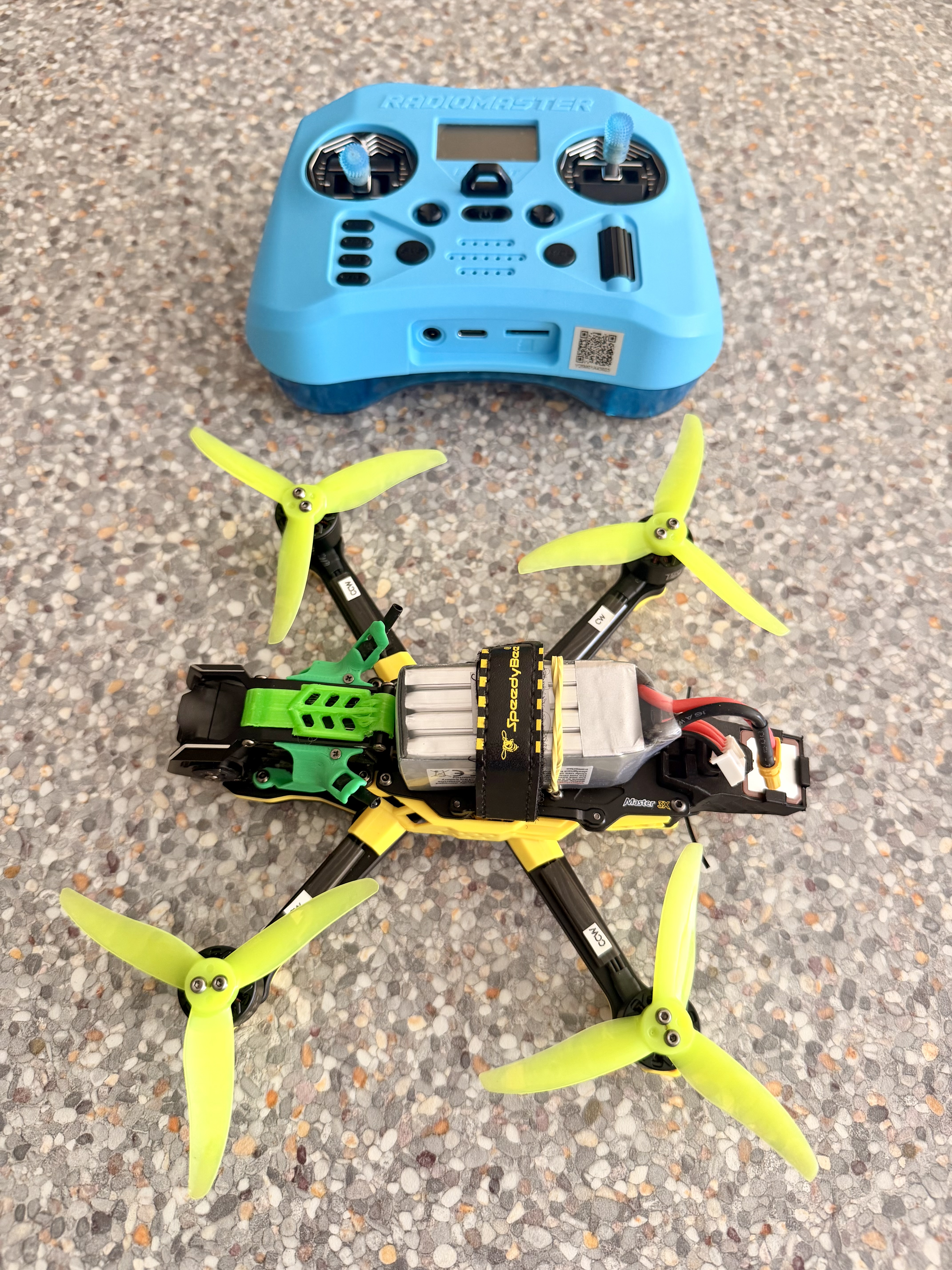

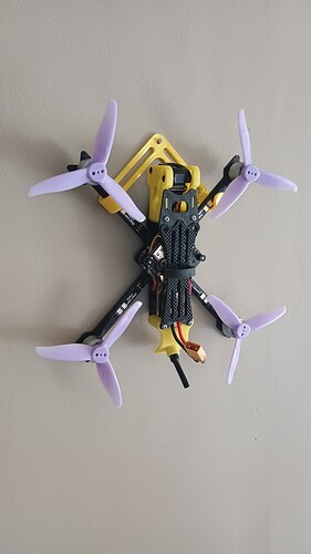

New flight controller installed, finished rebuilding the quad and tested it, everything works as expected.
Don’t have time today to conduct a maiden flight​:enraged_face:, but have completed the essential hover and directional move tests in the garden. :clap:t2:
So it’s already for BM26 for it’s official maiden flight :+1:t2:

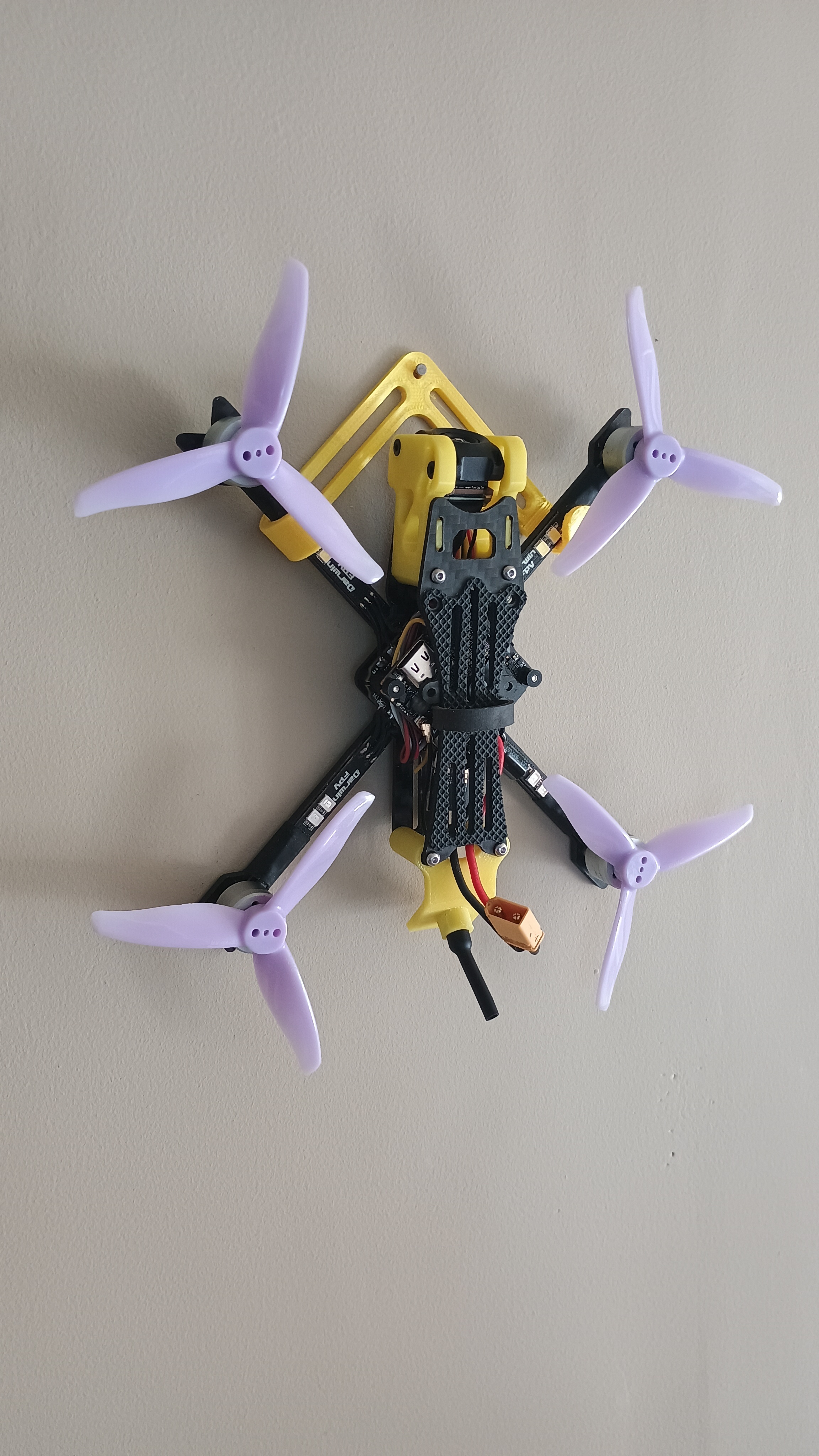

Just waiting for my delivery of yellow TPU, so I can reprint and replace the green parts. Which is a task for next weekend.

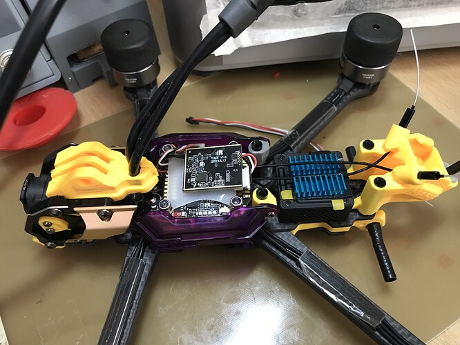

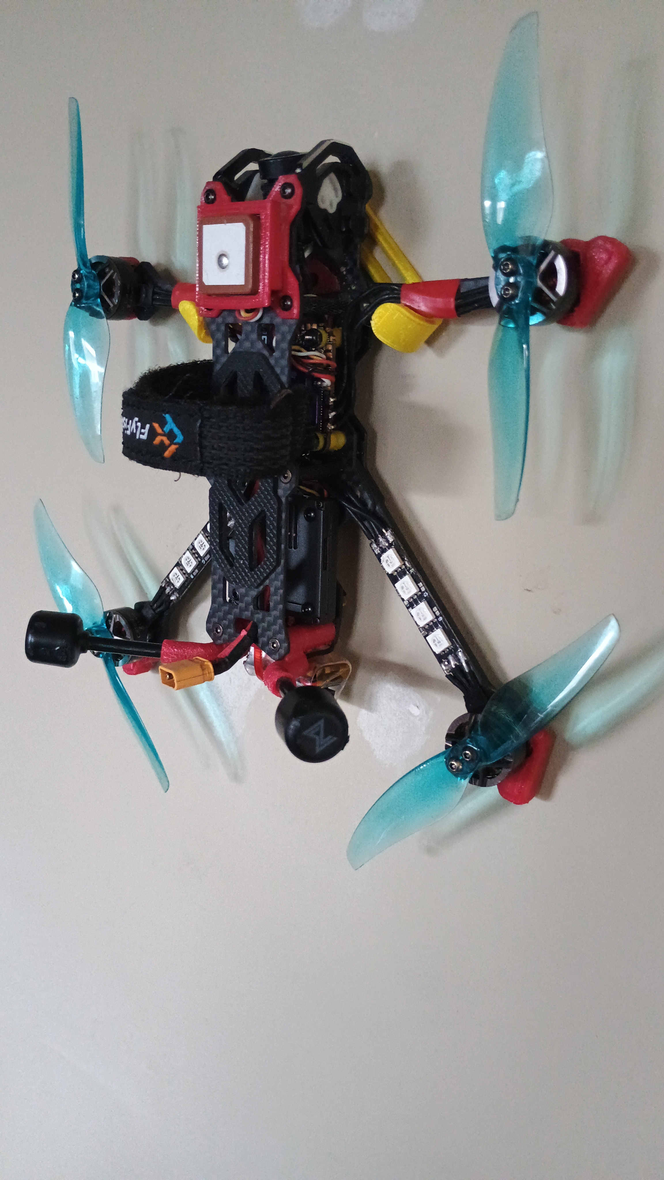

On a roll…FlyFish Atlas 4 LR now with working GPS since a brain transplant with a new SpeedyBee AIO.
At least it was 10 minutes ago when I hung it up. Hopefully it will stay that way. :laughing:
