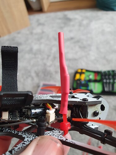

Repaired my VTX Antenna on my tinyhawk freestyle 2 after a bottom plate replacement the antenna was just flopping about and was heading straight for the props to get chopped up so recreated the original mounting position with a new zip tie and new shrink tube so now it’s back to being as good as new although its had a colour change lol
I’ve found that rerouting the VTX antenna so it pokes out of the back of the quad has resulted in a better range with less dropouts as it has less opportunity to be blocked by the frame. It’s also less likely to break in an unscheduled bouncy landing.
Nidge.
I was thinking about doing that along with shrink tubing the RX antenna to a zip tie as well. As it’s just flapping about out the back at the moment and could end up getting chopped by the props after a crash or something. But didn’t bother in the end lol

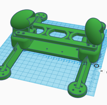

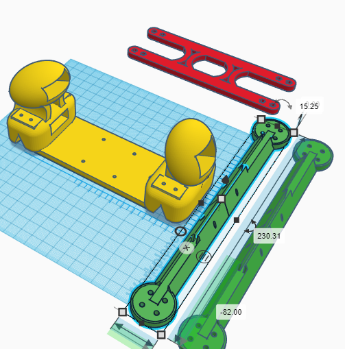

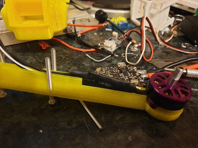

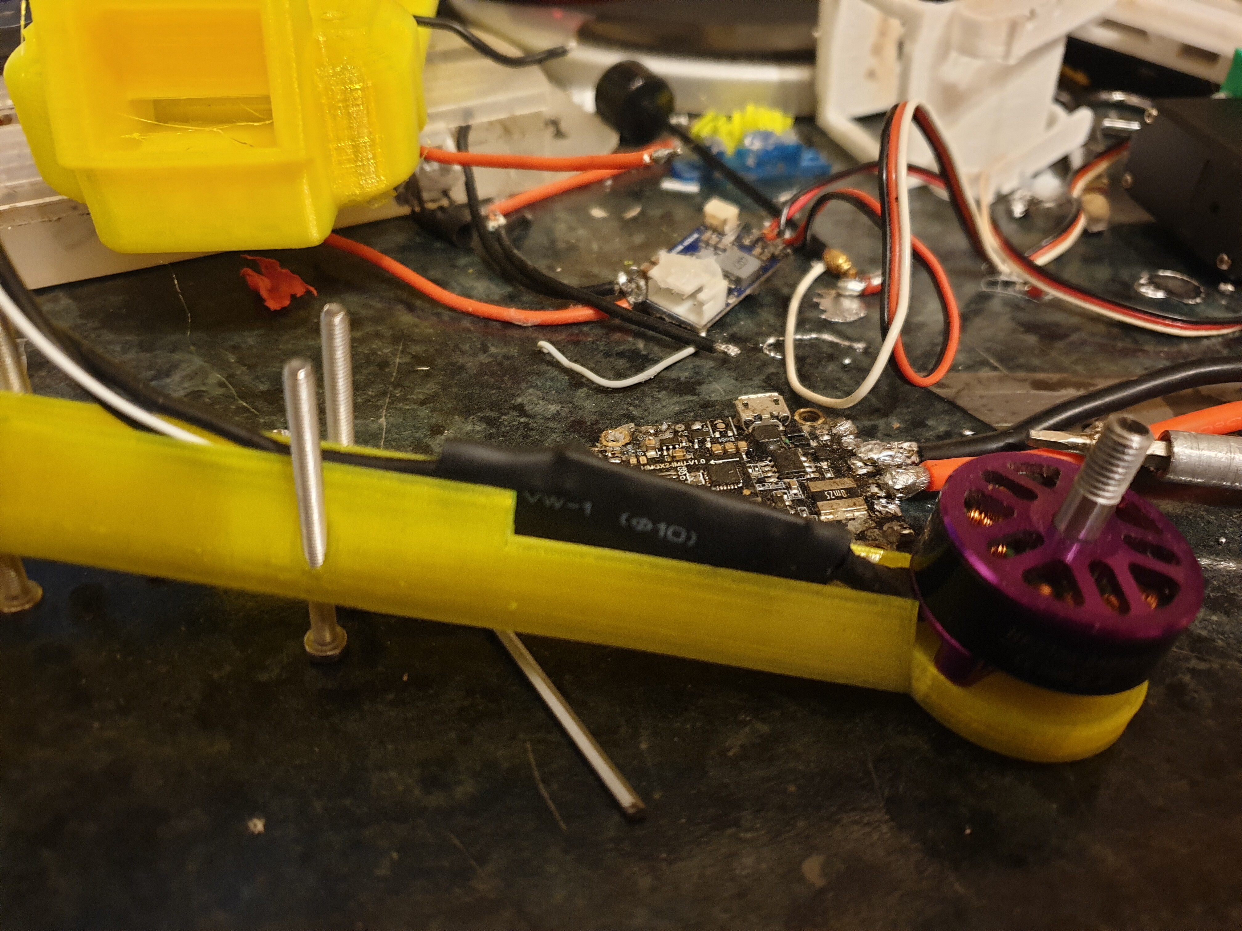

Funny you should mention that. I have some bits so just printing a frame for a 5" cruiser on Inav.

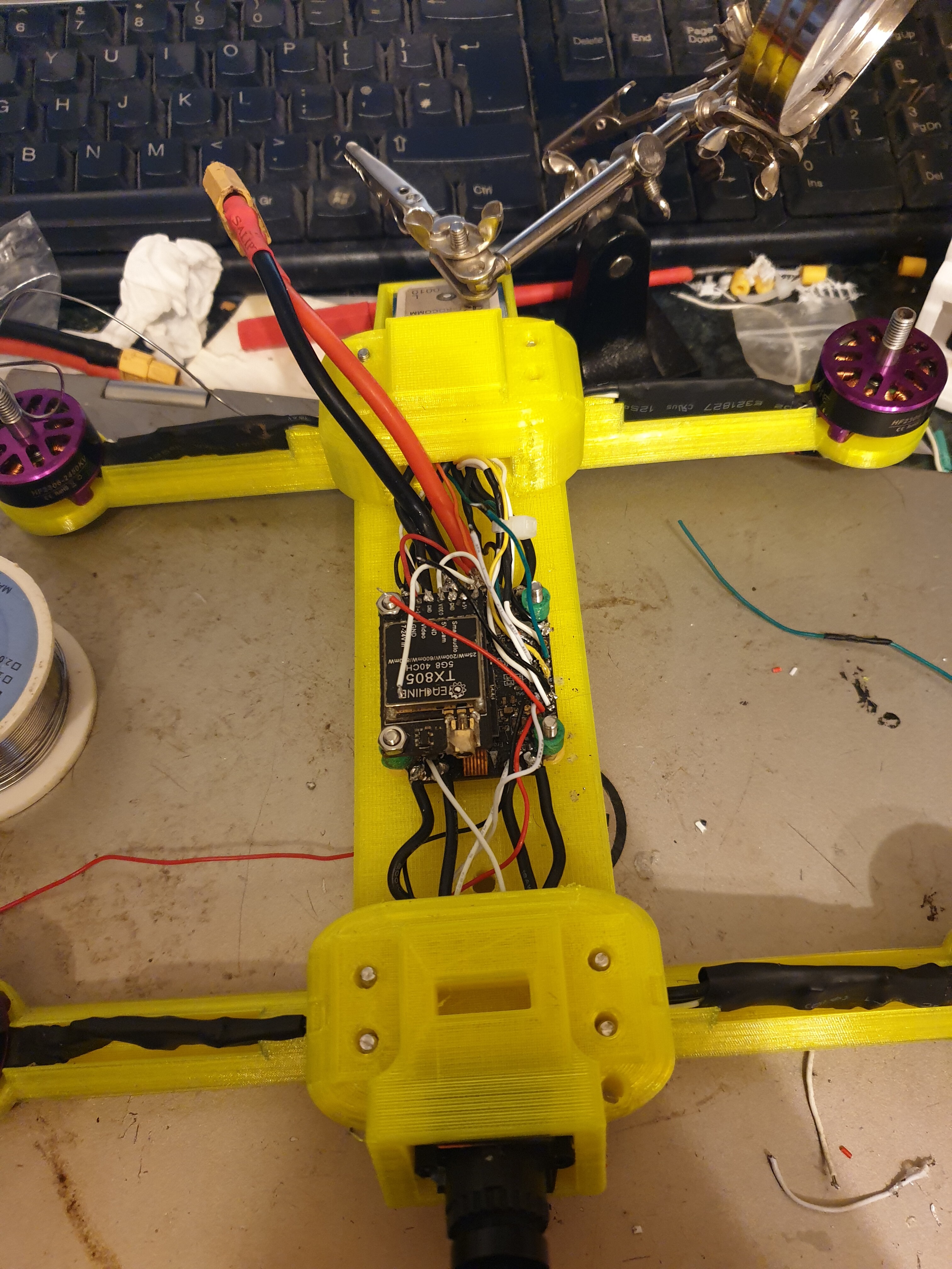

The vtx antenna will pop out the bottom for zero obstruction. I will obviously be careful landing, or design protection. I always would have thought the antenna should be at the front. So when coming home, you’re guaranteed the best signal. But obviously the camera is in the way! ![]()
@notveryprettyboy, I take that’s PET-G?

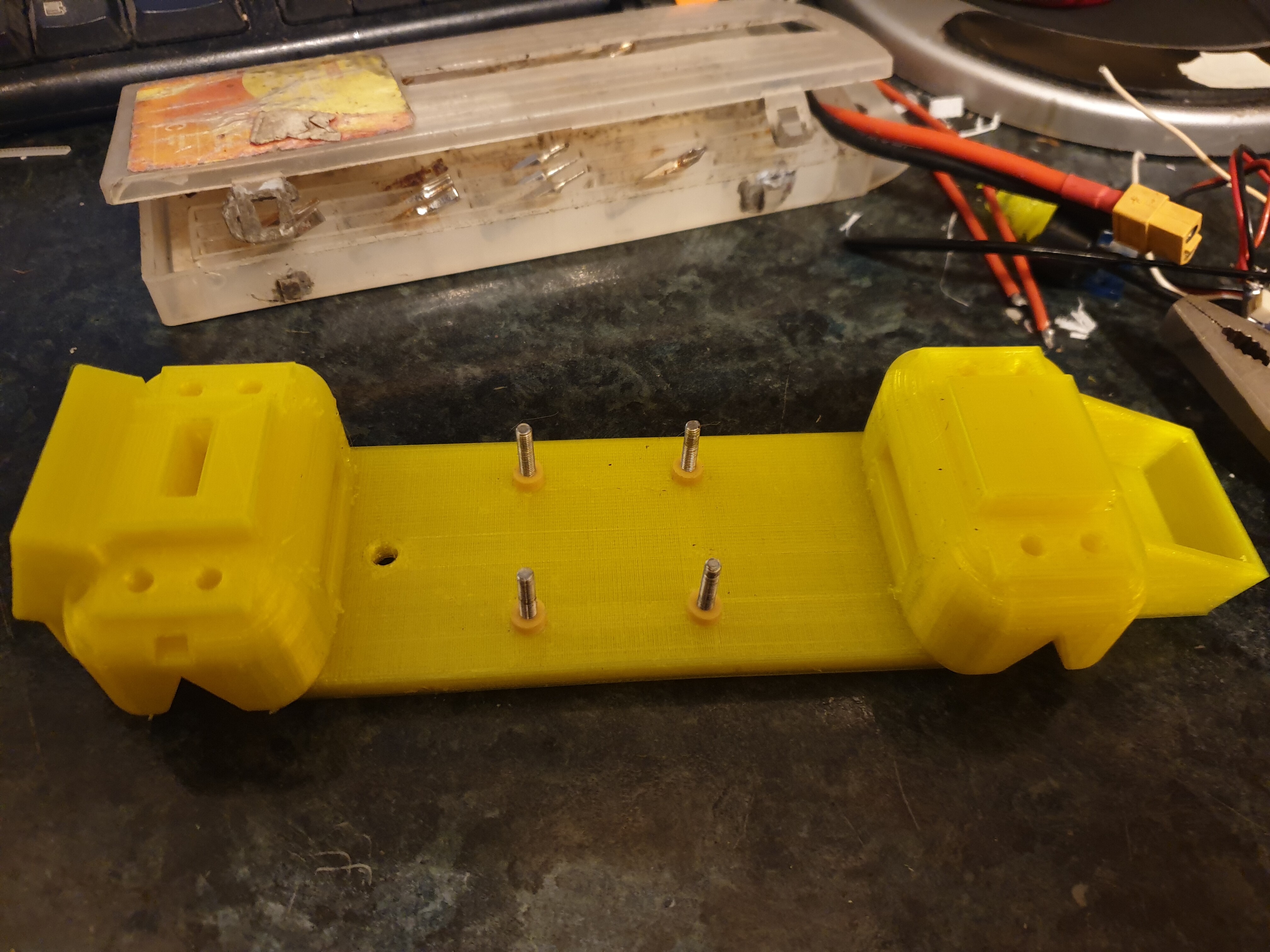

It will be. I’m printing in some moisture infected pla to prototype it at the moment. I’ve been through, and scrapped, two designs so far.

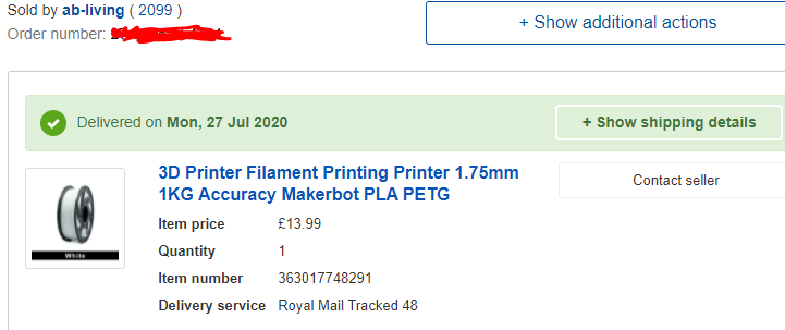

I never got to print mine as at the time I found my last unopened box of PLA was a Chinese con. It fizzed and popped while printing, binned and made a note of the Ebay seller…
Tried to find mine but can’t find it, I buy from Hobby King. There own brand has been excellent so far.

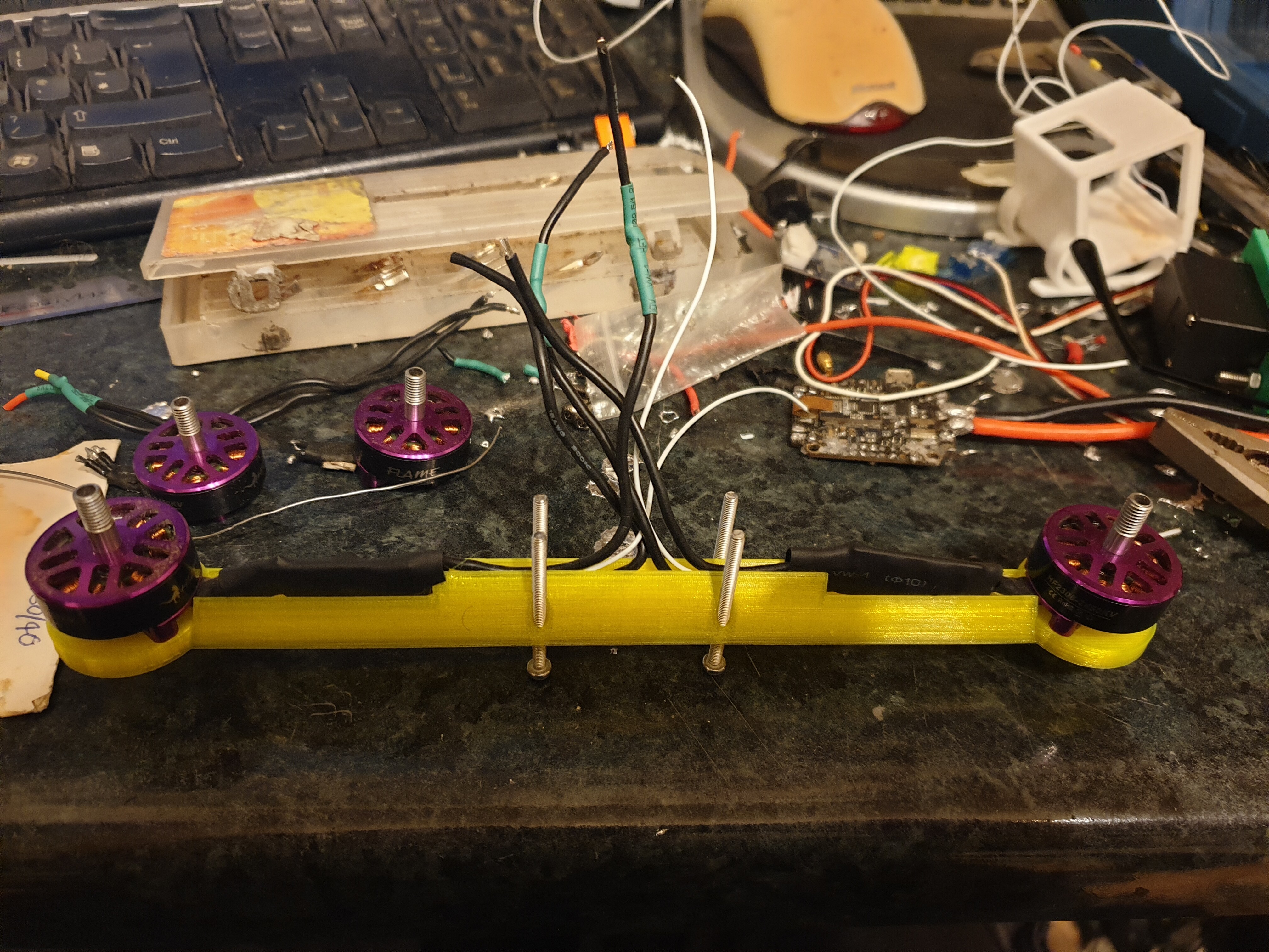

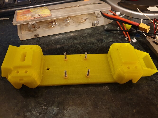

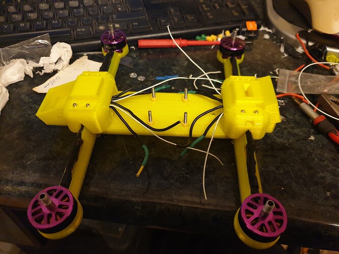

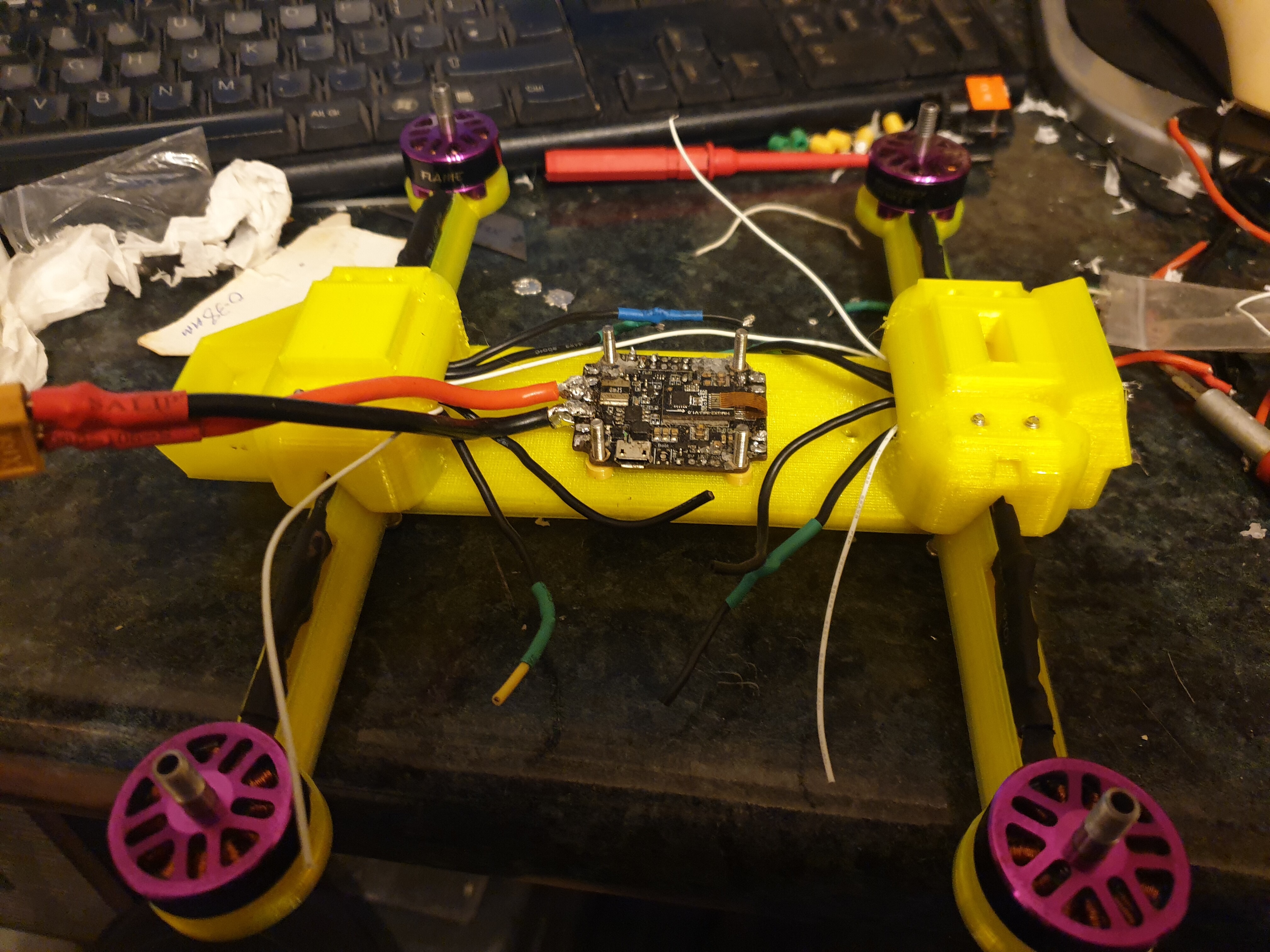

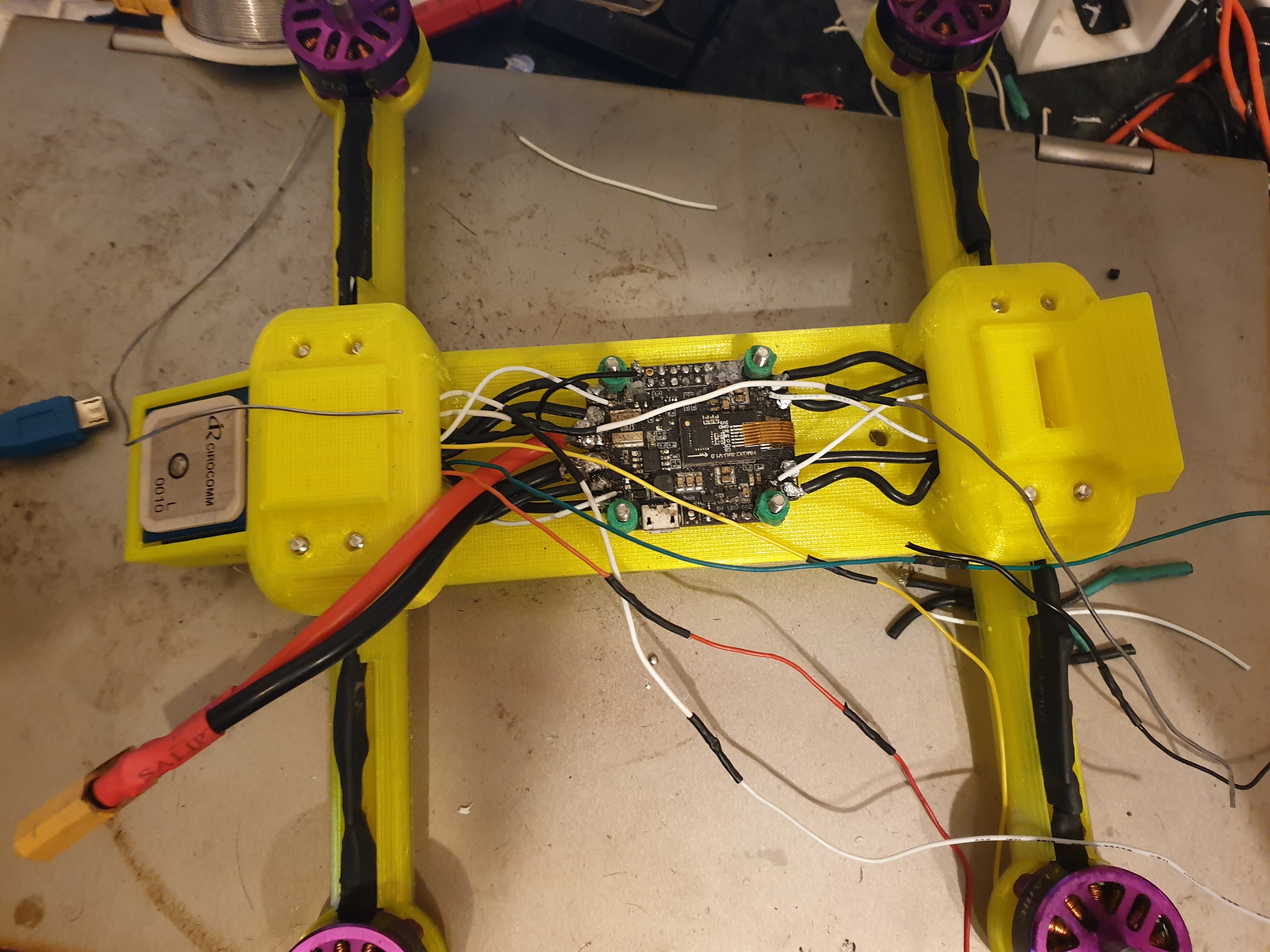

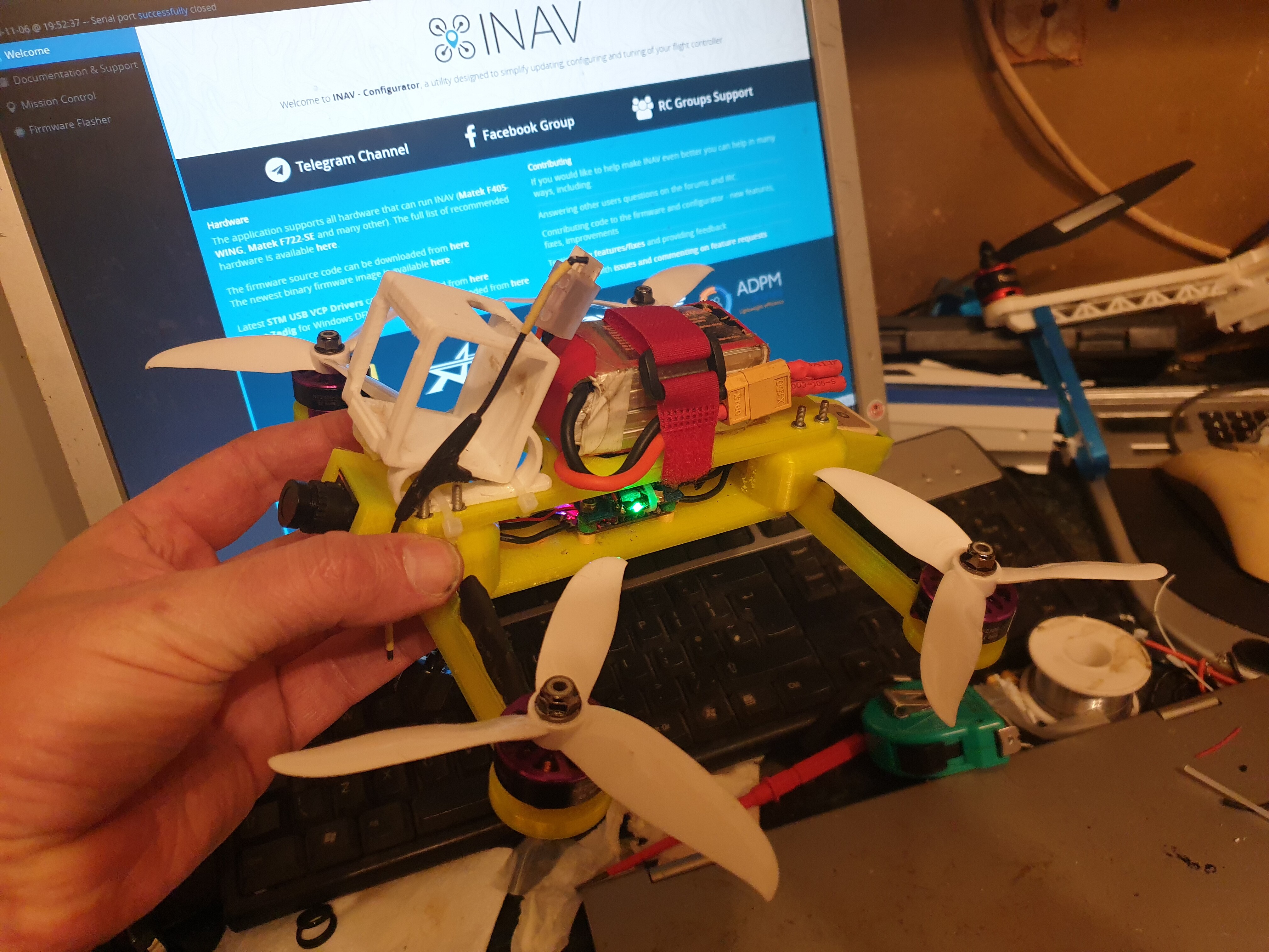

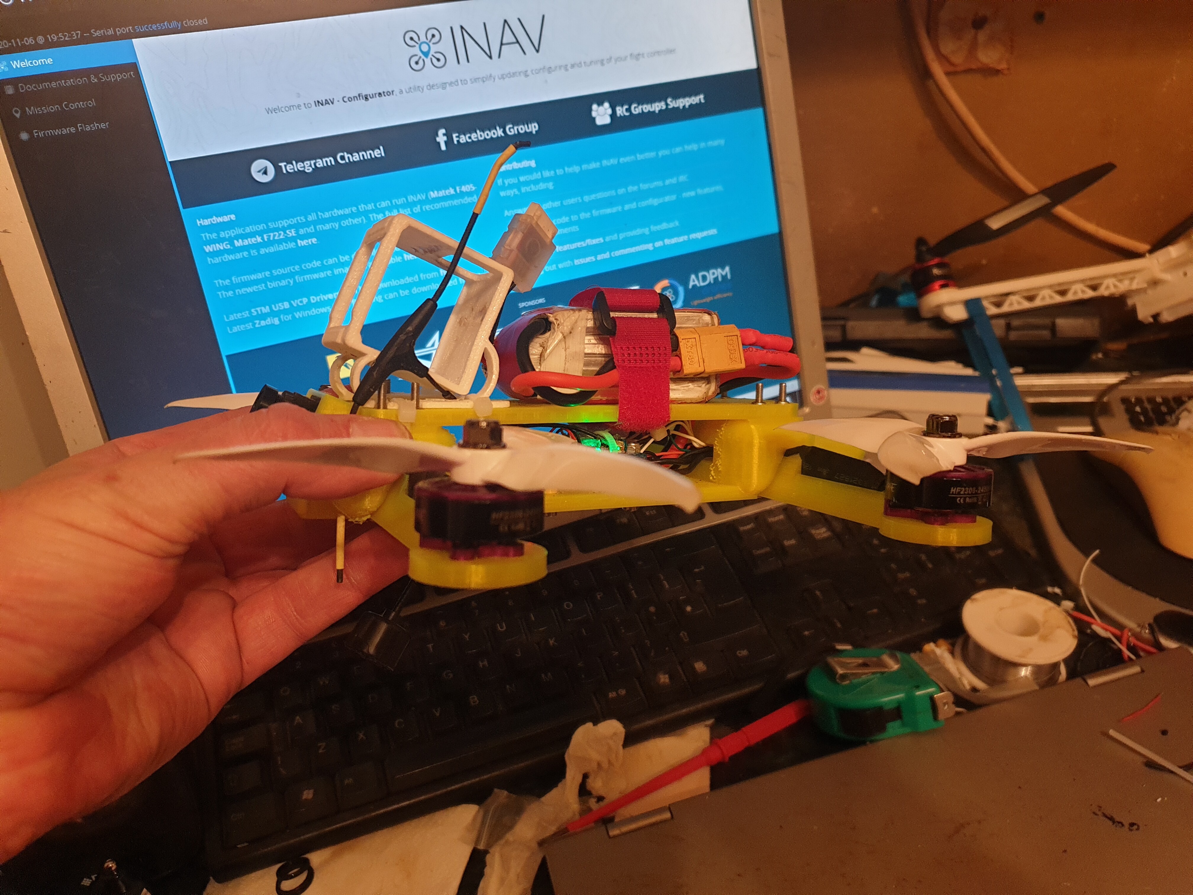

A fair few evenings later, scraping round for bits in the house and it hovered first time tonight!
I felt a great sense of satisfaction making something that flys from spare bits.
Yeah, my soldering if naff. But I don’t care

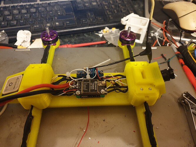

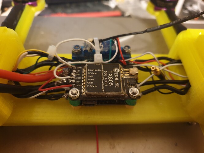

This is a 3d printed 5" quad using Inav, kakute f4v2, tx805 vtx with the antenna out the bottom, crossfire, 20a esc’s (bit low, but it’s all I had), bn880 gps and a cheapo fpv camera.
This one will be a cruiser, and not a stunt quad, because if it crashes, that’s it.
