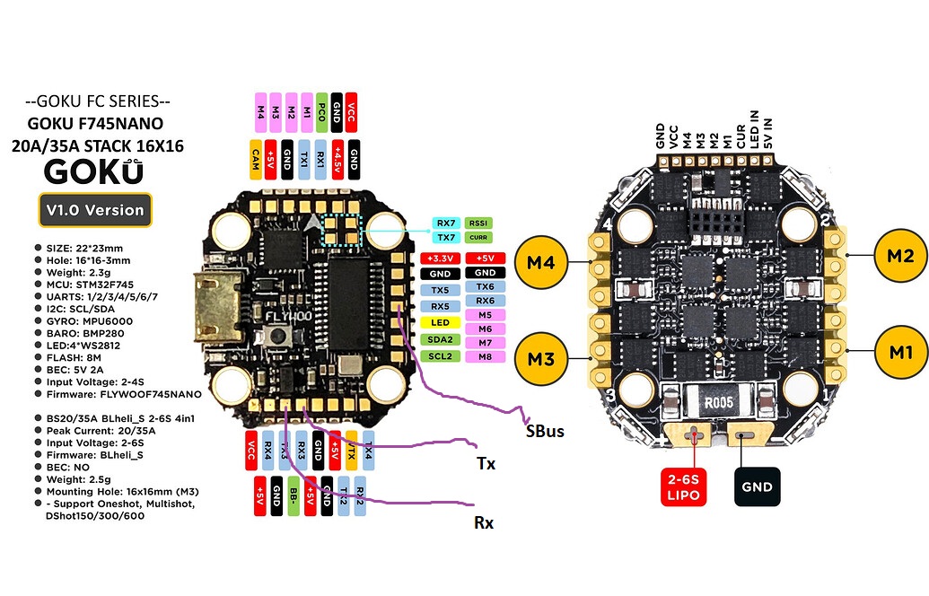

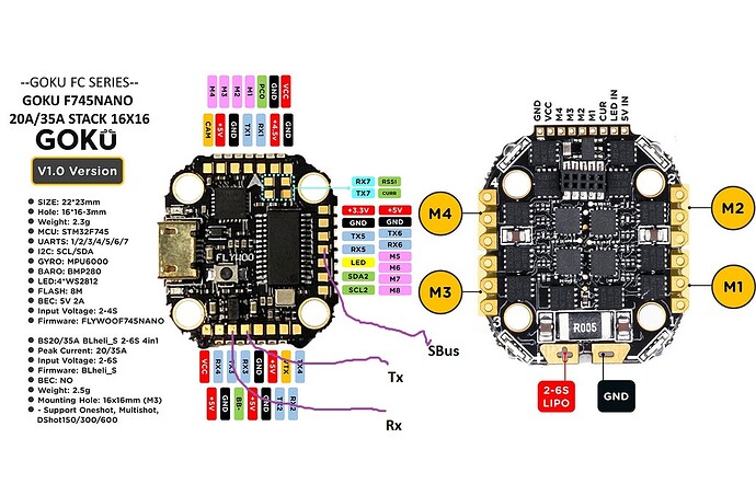

Ok Im loosing the plot at the moment, everything firing up nice on the firefly and my controller connects to my Vista but not my goggles hence just want to check im on the right track with the wiring. Below is what I have hence would I be right thinking Uart 3 for msp and Uart5 for Rx
That said Iv also just discovered my goggles wont pair :man_facepalming:t3:
Correct
What do you mean? You cant see video at all or you cant see OSD? The video side will be the link between your goggles and vista, the OSD side will be the link between your visat and the fc. Theyre both completely seperate.
I dont use the DJI FPV controller that you use but I do know that when binding to the goggles it has to be done in a specific order
Iv got no video at all just wont to bind the goggles.
Yet I get a green light on the controller is as both and vista.

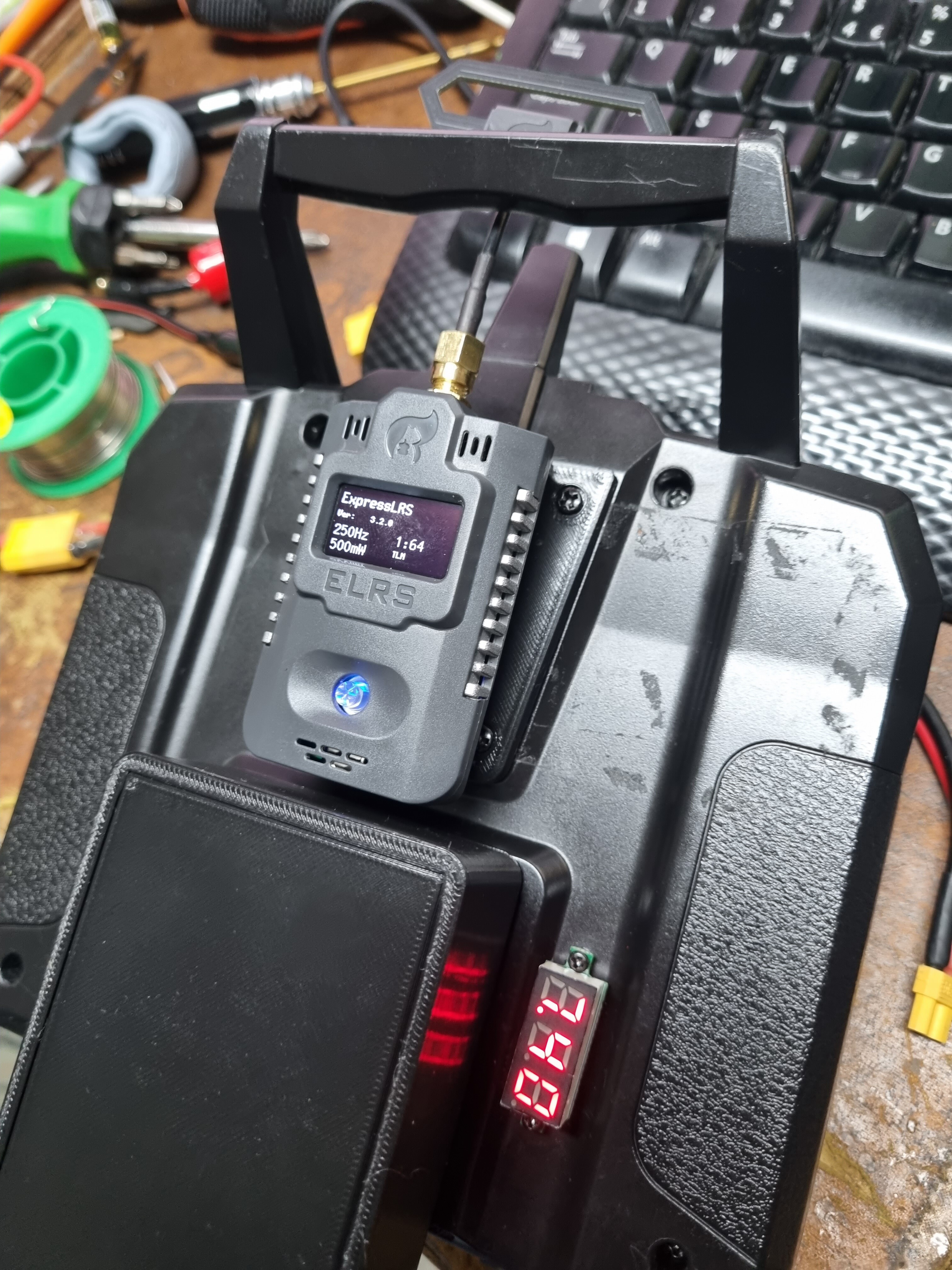

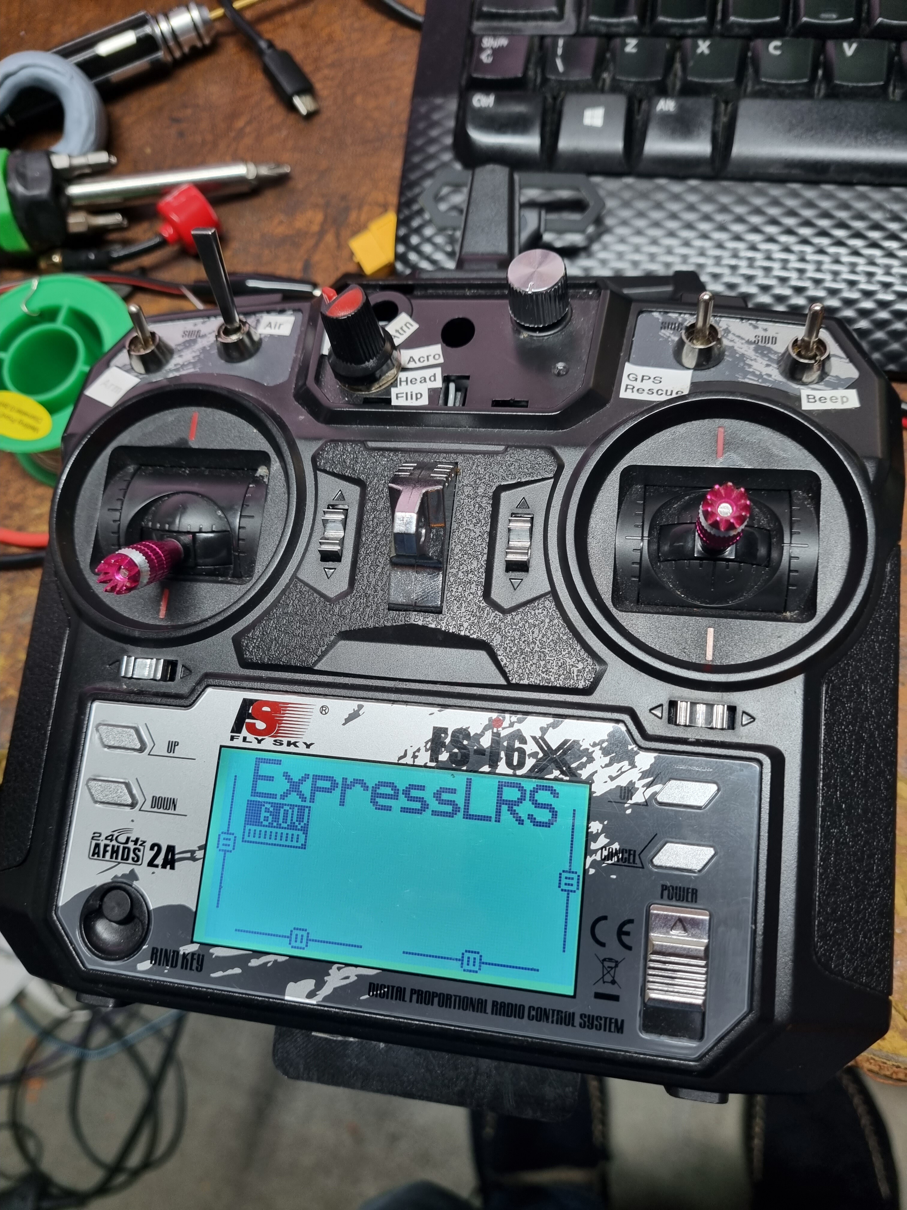

My Flysky i6x now supports ExpressLRS. :slight_smile:
A £20 Jumper AION Nano. 500mW. Actually more powerful than the ones on our Jumper T-Lites.
Iv seen on YT someone retrofit one to a DJI controller must say I was tempted
