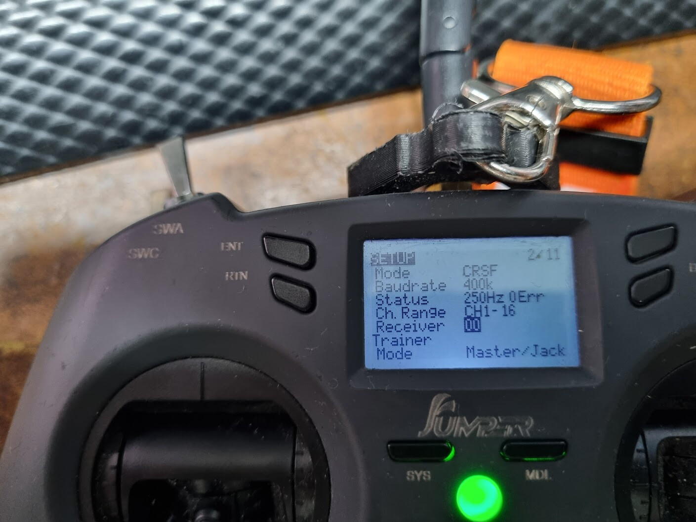

It should still work. v2.0 is compatible with ELRS v2.0 - 2.5.1 since the major version is 2.0.
It won’t work with v3.x, but nothing says you have to run v3.x, unless you have some specific need for a feature.
I would keep the Literadio for your old whoops and use the TX12 for newer stuff. On mine I run 2.4 or 2.5 on the Jumper and will likely not change it anytime soon, since it works.

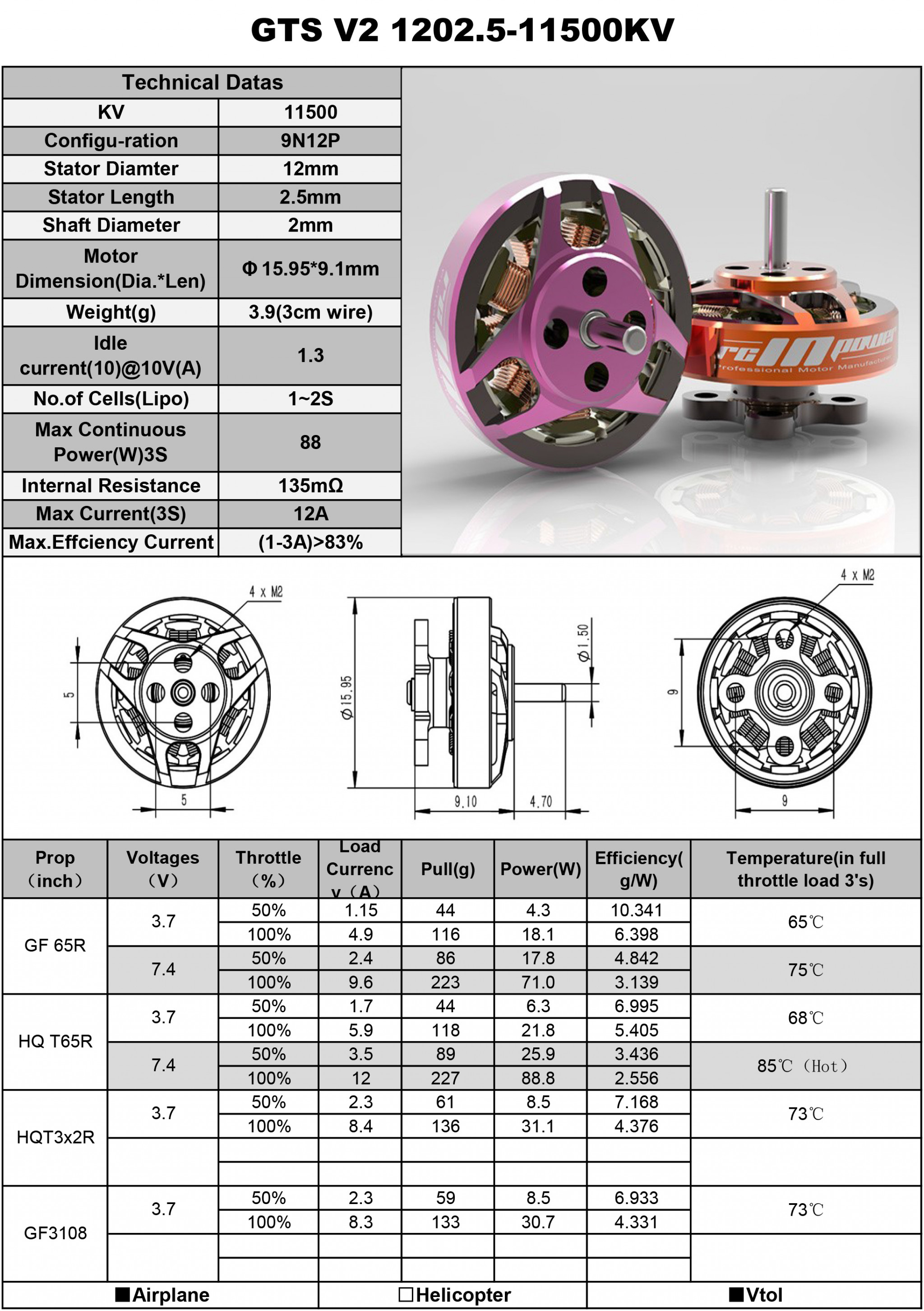

I’m happy with the meteor as is, and tbh the crux as well. But I wanted a 2s for flying outside only, no ducts. I thought I could change just the fc on the crux, but their motor are rated for 1s only (1202.5 11000kv). I think that is the case for 3" prop, bc there are similar motors being used on 2s with smaller props, but I can’t find a definitive answer as to which prop I would need to use and if this motor will actually handle it.

You are right - it should still work. I’ve seen many posts about making ELRS V2 work with ELRS SPI… and yet it doesn’t.
It could be the drone. Maybe the RX is faulty. As it’s never flown, it’s possible.
It could be the TX which is faulty - I’ve never actually used it to fly anything other than sims before.
It could be me being a moron. I’ve done stupid things before and overlooked the most basic of things because of assumptions, and I’ll do it again many times more.
The most aggravating thing is the lack of information. No telemetry or logs or anything to tell me what is going on.
I just checked the commit log that was done to make ELRS V2 to work on the Literadio. Looking at the code just looked like “what is the hackiest way to get this to work?”. Take the telemetry handling - commented out. :man_facepalming:
When I get the TX12, I’ll try again. Maybe everything will just work, maybe it won’t. Either way, you’ll hear about it!

Those 1202.5 11000kv might run on 2S. I have a set of RCinPower 1202.5 11000kv motors and according to the datasheet they will fly on 2S, but might get warm depending on the props used.
If you did decide to experiment, my suggestion would be to cap the motor output to maybe 60-70% and then fly it and see how hot they are getting. Then increase until you find a level that you are happy with. The numbers are very similar for 1S, so they might still scale up to 2S as is with some output limits.

On my Meteor85 with ELRS SPI, I ended up putting in an EP1 as I wanted to put my TX on v3 to allow easier sharing models with my kids. I use the full resolution on my fixed wing models and didn’t want to have to faff around changing to different resolutions when I wanted to fly whoops.
Other than that, v3 is definitely the future and for my use it was worth flashing all my gear to v3.
Do you know that chosing a different rx number in opentx model setup means a different set of settings in the expresslrs module are chosen. So can have models with different resolution settings on the same radio?
I did not know that this was per model rather than global, but then I only ever use model 0. Good to know :+1:
Per Rx number

Regarding the motors… This one was actually one that I had seen before of similar specs which works with 2s as well, and as per the table I would need to go down to a 2.5" biblade to cope with the additional power… The funny thing is that on HM site, the table for their motor doesn’t show that option. It most likely is a marketing thing to promote more sales, but you never know…

Was just checking on the updates of EdgeTX and on the latest it states that your radio is supported. Could this perhaps be a path for you to get your radio on a higher version of elrs? (I havent checked beyond that its supported now by edgetx)
Sorry, just realized this would be for the Pro version, from what you wrote yours seems to be the normal version…
Yeah i have two sets of 1202.5 at the minute, The C2 Flea comes with the 8000kv variant and the RCinPower I wanted higher kv so went for the 11500kv. My only complaint about them is they are seriously loud. But they generate a massive amount of thrust for the size of build we use them on. I think 700-800g of thrust for a quad that weighs around 100g is pretty sweet. I don’t know what the golden ratio for thrust is, but I tend to aim for 4-5x the weight of the craft as a go to rule in calculations. These motors easily give that.
