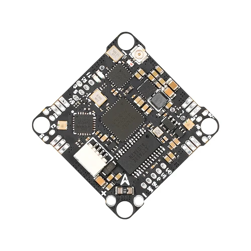

How much for the betafpv one and what does it include on the board?
£35, 12A AIO, SPI ELRS. I have a couple of these so far and not had any problems. Be aware that some people do have issues with them. So it could be that I am incredibly lucky. Also if you do decide to try one, before you plug in USB, do the boot button hack and flash it with 4.3.1 as it does use ICM-20689 and is technically susceptible to the gyro brick issue. Unless of course you get lucky and get one of the newer ones that uses BMI270. I have asked UnmannedTech a couple of times to change the product description to reflect what version us being sold, but they so far haven’t bothered. V2.1 is the old one, 2.2 the new one (AFAIK).
Saying that I have one on the M85, one on a partial Nanofly16 build and two more gathering dust in my parts box.
Outside of that, if you can get hold of one, the DarwinFPV 15A AIO is probably the one I would get. It’s a similar price, but you will have to order it from them directly as no one seems to have any over here.
If you add a vtx to the betafpv, the price comes to about 50 quid, so I guess that is better indeed… Will consider this option as well
For the Darwin one, you have to consider the vtx and rx, so might not be the most attractive on the price perspective, but it does 1-3s, which the others don’t…
Sorry, I linked the wrong Darwin FC. The one I was originally going to link had SPI ELRS on it, but they’ve jacked the price up on it to $50, at which point it’s a bit meh. Roughly £42. Pros are definitely the fact it does 1-3S and allows up to 15A. Cons, the fact you have to ship it from god knows where, probably China.
The vtx is about £11 for an ovx300, but if you search on ebay from time to time you can pick them up for less. I grabbed some random no name/random name 200mw vtx’s from a random drone shop on ebay a couple of months back, got them for about £6 each, so grabbed a couple. They all worked. Saying that though, i think the best vtx is actually the Fyujon, since you get an ELRS receiver with it, which you can break off and throw in your parts box. At £18ish for a vtx/rx combo, it’s probably the best value

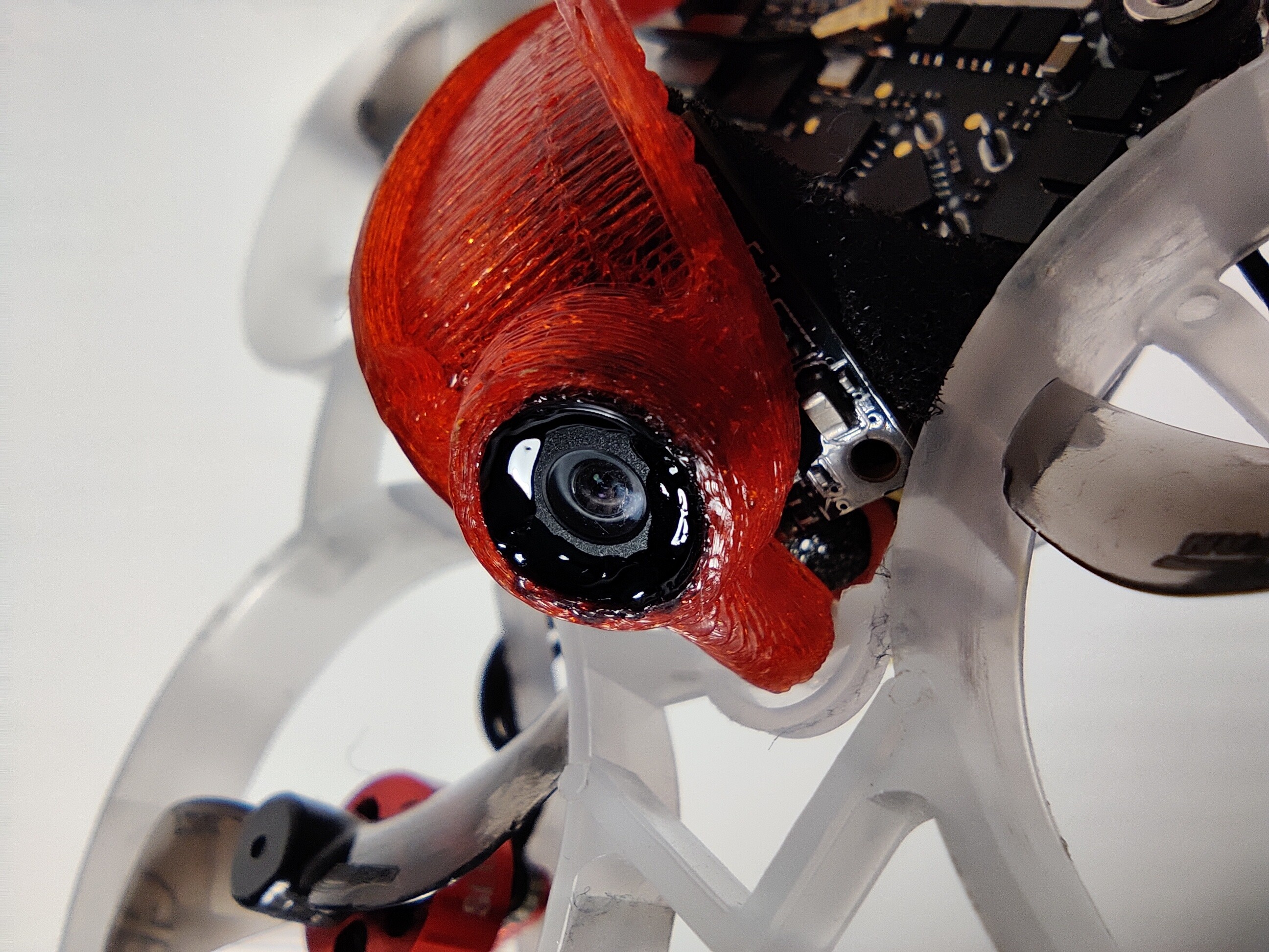

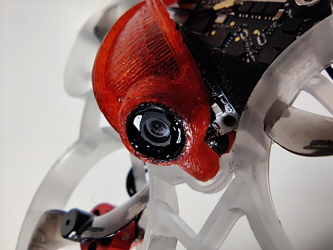

Finally got fed up with the camera popping out of the Mobeetle6. I had a tube of T-7000 which is used to glue on things like phone screens and have put a dab around the camera to seal it to the frame without making it impossible to remove in the future.
About 15 batteries later, it’s holding up great, would highly recommend as a QoL improvement.

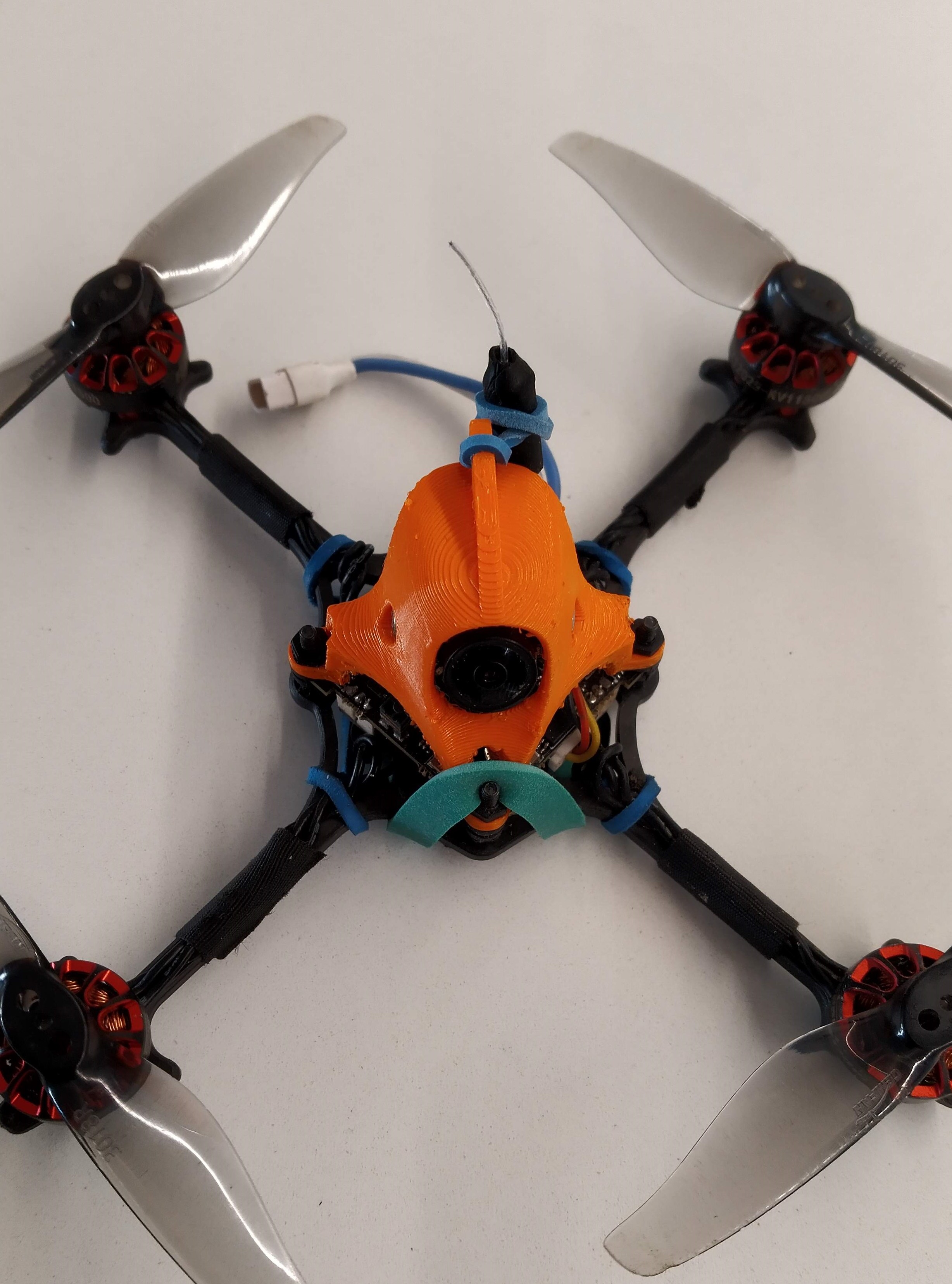

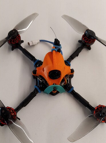

Trying out a new hi-viz outfit for crux3 (excellent 3dprinting by @Steviegeek ). Took it for a ride earlier and don’t think I noticed a difference from the original, they weigh about the same as well.
( In case someone is wondering, the green rubber band is being used as a battery pad whilst the blue one is holding the battery)

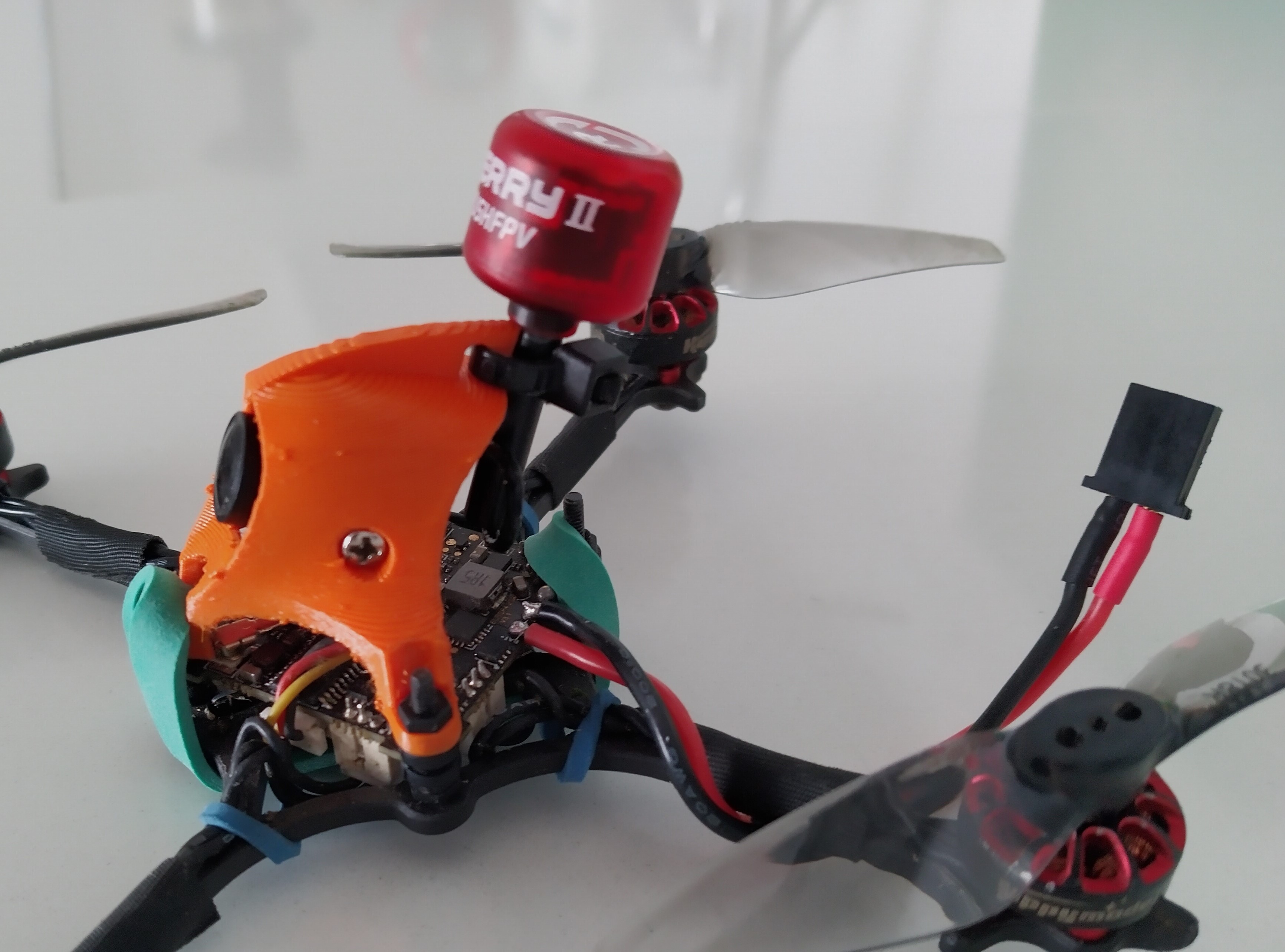

A couple more mods on the crux3… New antenna and battery connector.
Nice Cherry 2. I am after a couple of sets of those for my fleet. I’m getting fed up with the limitations of linear antennas. I thought your Crux was the 2S version?
Haven’t really put them to test yet, but the same reason you state is what I got it for…
Mine is the 1s elrs version, unfortunately…It flies nice as it is, but once you get used to it you start to wish for more juice. Might convert it to a 2s eventually, but I do worry that the frame might be a bit on the thin side for a 2s (even thought the original is 2s and uses the same frame), but no use worrying too much before I actually try it…

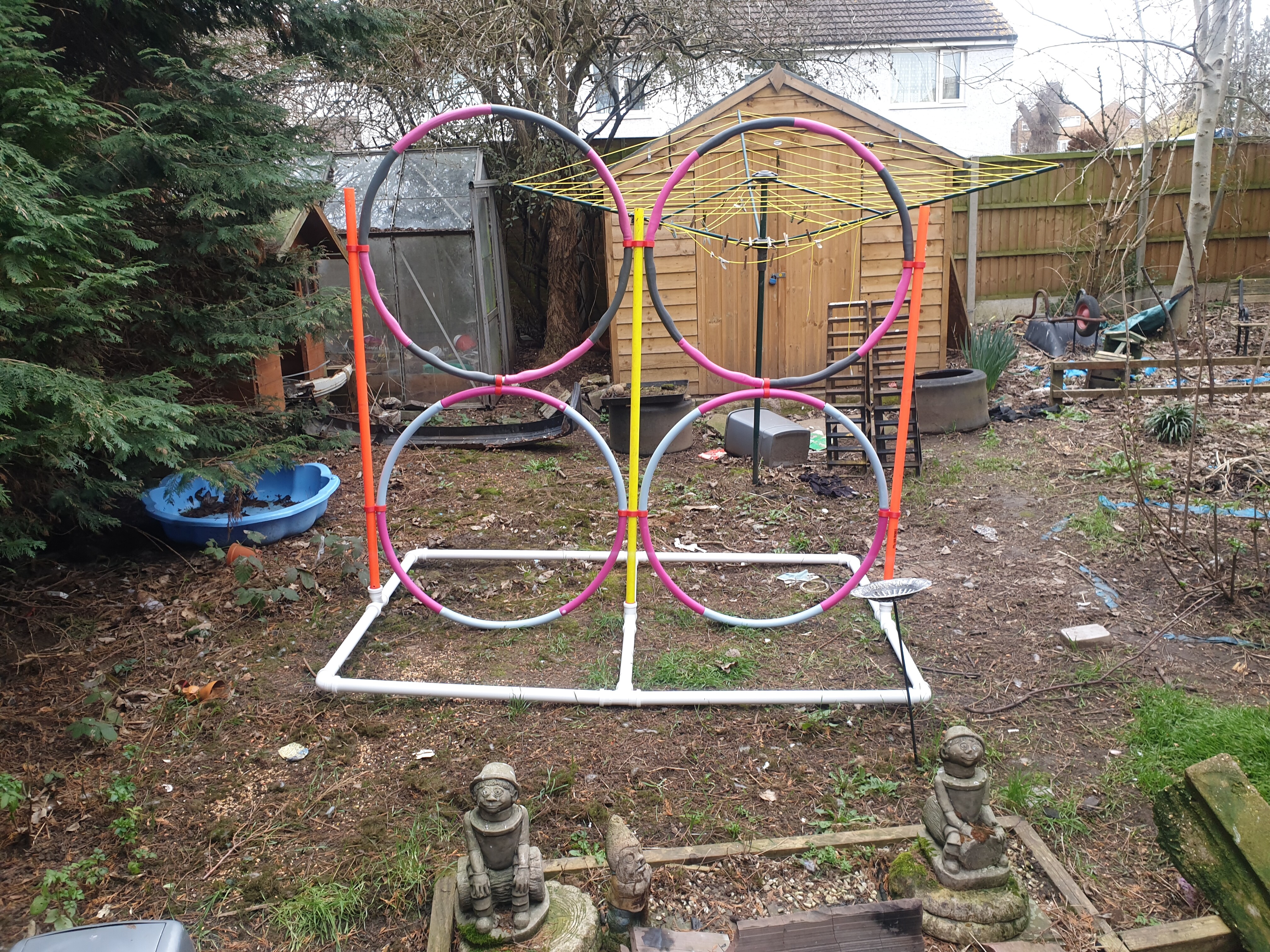

Finally finished my corkscrew gates for the big meet. The hoops are padded and strong and were only £2.50 each at the car boot.
Cant wait to crash into that mate :laughing:
If we put some bean bags, or similiar, on the corners of the frame it will keep it stable in the wind
Nice job Mate :clap:
Cracking job Karl :clap:t2: :bowing_man:t2:
something’s wrong with my glasses, I can see a potential drone… :man_facepalming:
