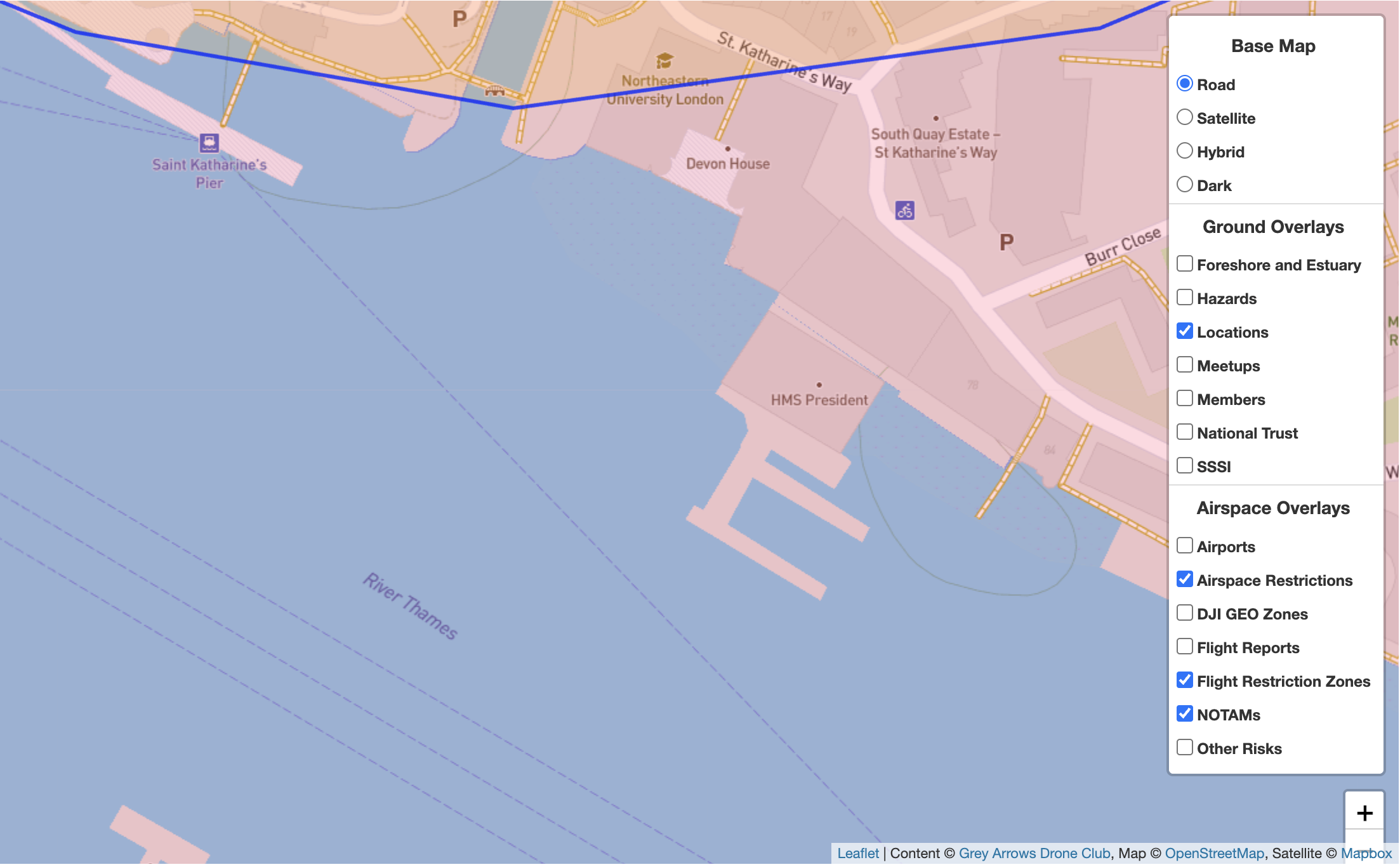

No. TOAL was from Hermitage memorial gardens which isn’t restricted although HMS President is nearby and apparently no fly zone over there but I didn’t get close. A few helicopters hovering around but no trouble. Was still nervous though
No it’s not!
DJI’s Mickey Mouse geo map used to make people believe it was. It never has been.
Ironically, now, after the introduction of the National Security Act 2023, would HMS President not be defined as a ā€œprohibited placeā€?
If so, you would probably be best advised not to fly over it or too close to it, even though there isn’t an official Flight Restriction Zone in place.
If the CAA or authorities didn’t want you flying there, they’d put a restriction in place surely.

It would be sensible for them to put a flight restriction in place but, technically, I don’t think they have to.
I thought any military base became a ā€œprohibited placeā€ by default and that flying a UAV over a prohibited place (if unauthorised) was an offence.
I am very happy to be proven wrong though, if I have misunderstood.
Thanks - I did see those posts when I was doing my research before flying there. That is why I think it’s potentially ironic that when DJI imposed a ā€œno fly zoneā€, there was no law against flying over it but now that DJI have removed their ā€œgeofenceā€, it might actually be a ā€œno fly zoneā€ thanks to the National Security Act.
Source?
My source was the Act itself:
I suppose clause 4(1)(b) might be a ā€œget outā€ as it talks about the conduct needing to be prejudicial to the safety or interests of the UK and one might be able to argue that flying over HMS President wouldn’t be prejudicial to the safety or interests of the UK but I am not sure I would want to be in the position of having to argue that and I suspect it would be for the Royal Navy to determine, not me.

The definition of prohibited places is quite broad (e.g. it appears to include the sites of any UK defence suppliers) and I don’t believe all of those sites will have been given specific Flight Restriction Zones.
Almost as broad as ā€˜prejudicial to the safety or interests of the UK’

I’m fairly new to drone flying and I was nervous too. If I did need permission I dint get it (don’t tell anyone) but hermitage memorial park as not in a restricted zone but I was mindful of hms President (no ship) was nearby and that has a no fly zone over it so most of what I did was really up and down without an awful lot of flying. Pleased with what I got though
Again, no it doesn’t.

Taken from Drone Scene …. No flight restrictions mentioned at all. Now if it’s covered under the NSA 2023 which still has to be verified, that’s a different matter.
